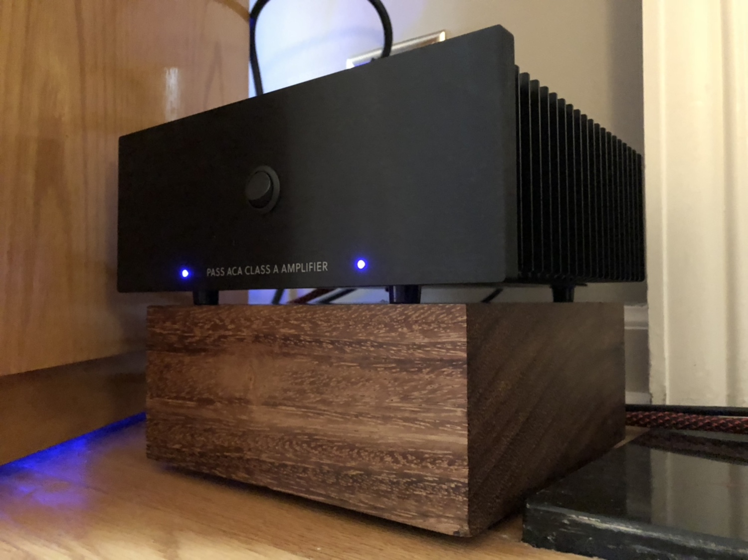

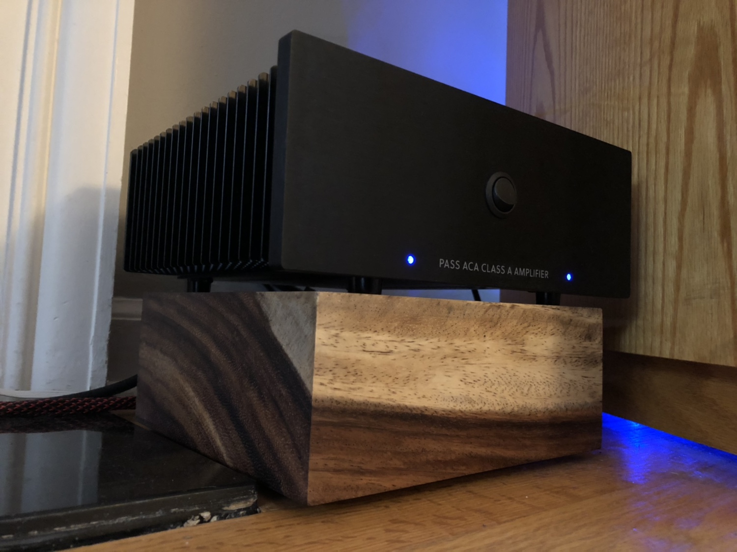

Solid Monkeypod blocks, also called Raintree, or Parota. They came dipped in wax. So in my personal experience I’ve had great sonic luck, decoupling speakers and equipment with some cheap anti vibration feet I use... so I expected maybe something noticeable to my ears, plus it makes the amps just a lil further from the wires.
I’d love to say having the amps wider than the blocks for added free air on the heat sinks was all my good thinking, but honestly it was more a limitation of how the wood was available. The amps do feel just a little bit cooler than before and best way I can say it is they sound a lil happier. Lol, I did it for aesthetics but I swear it sounds better. They for sure feel less warm to the touch.
Dudeisms would you mind providing a name or link of the place you got those blocks at?
Here is specifically what I purchased 8x8x3
Monkeypod 8" x 8" x 3"
This was in Woodcraft’s “dimensioned wood” section, and it is to be cut within +\_ 1/4th” of size listed. I say this because all this really is is a “turning blank” of exotic wood. Warning it comes covered in wax, lots of scraping and I went through several belts on a cheap belt sander to get the wax off, then finished it. But you can buy a “turning blank” from any mill or exotic wood supplier online. Other than the look of the wood I picked and it’s inexpensive price... it’s known to not really react to changes in moisture... as a different kind of wood might after having the wax removed. Some types of wood need to dry out for a while.
