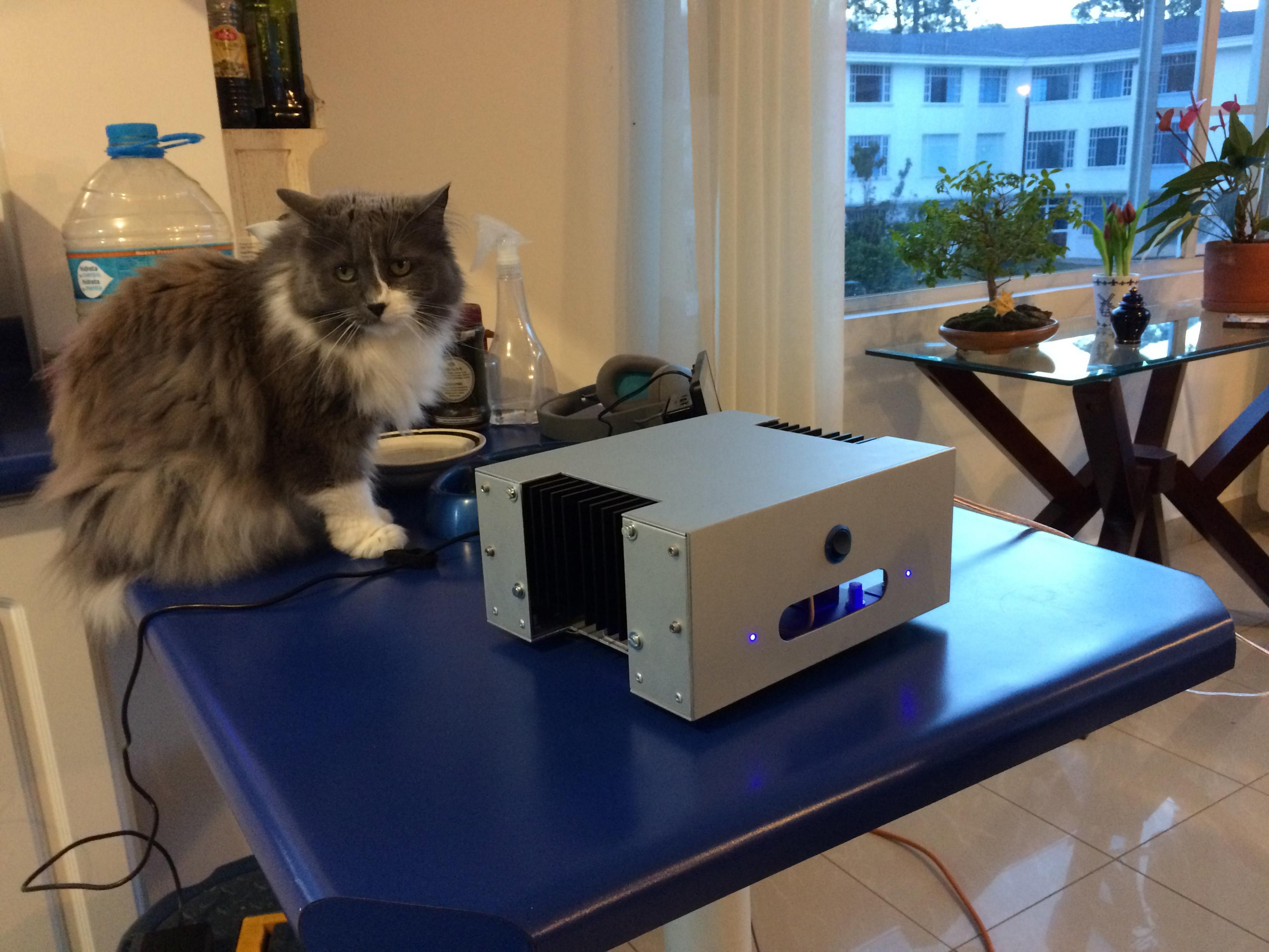

I have spent the last two hours listening to my *almost* finished ACA! The sound is just sublime! Such warmth and body, such deep and coherent bass, nice detailed highs. Also, the sound is very even throughout the frequency range... something my 'bigger' class D amp is not that good at. It's just amazing sound, with any type of music I play.

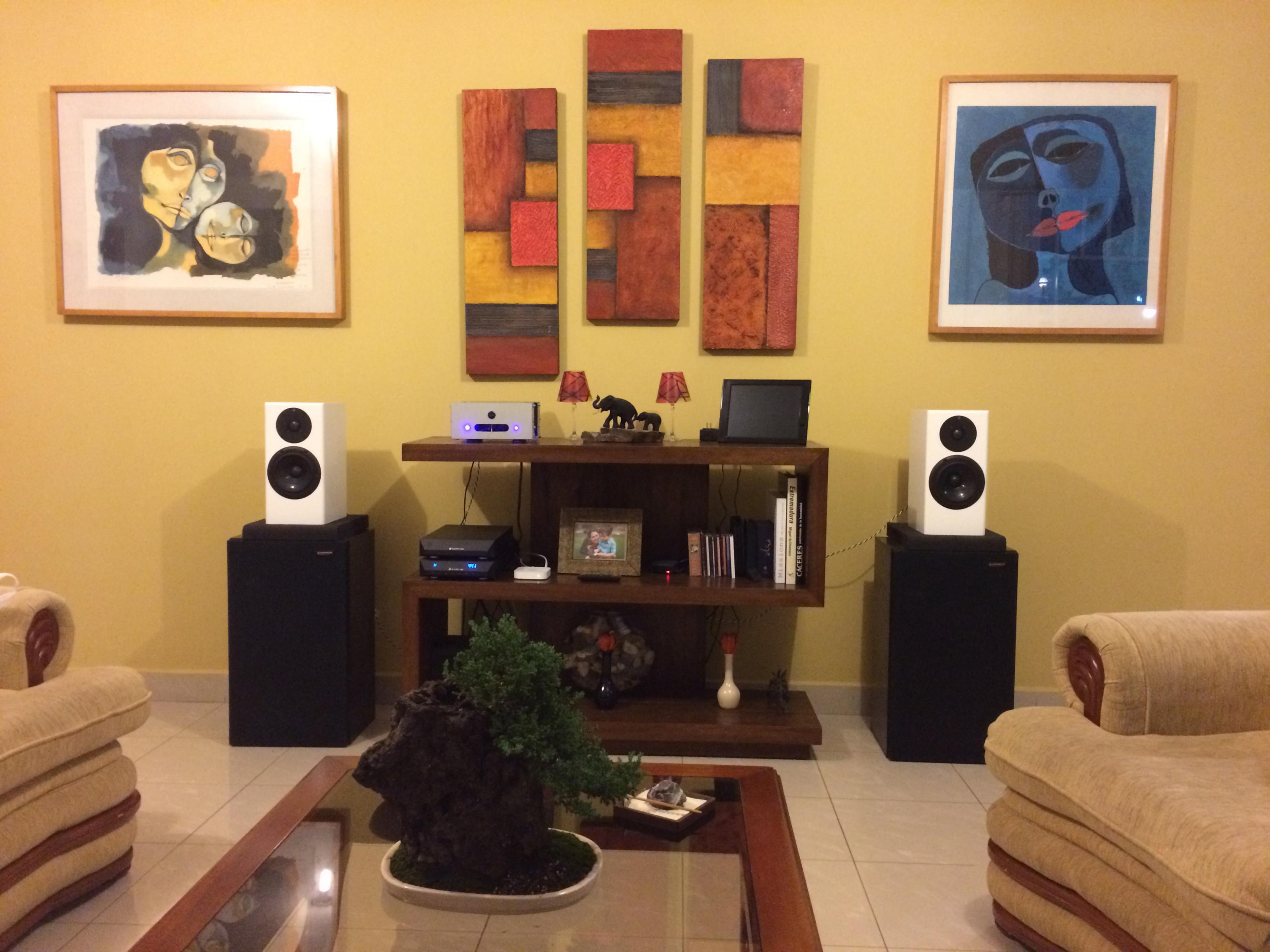

I listened to it in my living room with my 4 Ohm 87 dB efficient Totem Rainmakers, and it is producing all the volume I would want or need, and that is with the 5W of the 19V PSU / 10V Bias setting (more on this later!). So the fellows getting the bigger 24V PSU / 12 Bias with 8W output: do not worry about this AMP's capacity to drive your speakers loud enough for serious listening on even larger spaces. It's just that good! And with such simplicity in its design, that it is downright scary! It's truly the work of genius! (but that we all already knew! ).

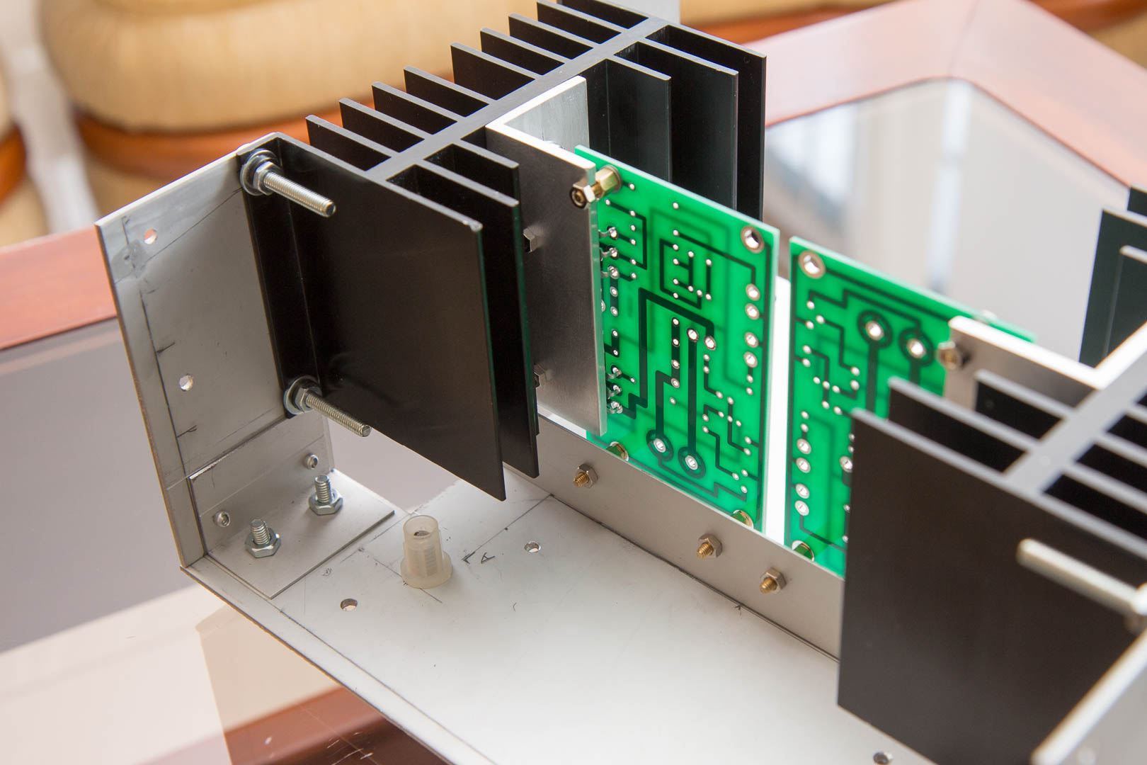

For those that have been following and helping with my adventure (for those that haven't, I've been building my own chassis): the inner cabling did not end up that good... my PCB positioning is not the greatest for that, I'll post some pictures tomorrow with better light.
Still, my original worries about the heatsinks not being quite sufficient apparently were well funded: the inner aluminum 'Ls' are getting around 58º, and the outer heatsink is reaching 54º. Still, I'm somehow proud of the design I made incorporating the top lid as part of the dissipation area. It's reaching 45º, so its helping with a large surface for heat exchange.
Here's the design I'm talking about:
So, my kit will forever live as a 19V / 10V Bias AMP, because I cannot go any higher in temps or I'll turn my AMP into a stove. Also, the Power Resistors are getting to around 63º, which is really hot! So I'm regretting not having lifted them a bit. I guess other's see similar temps for those resistors? (as they are not being cooled by anything other than air flow in the chassis).
So, here it is, ready for the first listen:
My Kira knows its going to reach 50º and is waiting to curl by its side
Once everything looked like working, I moved it to my living room, replacing a 150W NuPrime ST-10 and hooked to a NuPrime DAC-10 / PRE configured to output a max of 4V on the RCA connectors (high setting). The amp is able to deliver all the volume I need:
@RafaPolit well done with your build. You've embraced the DIY dream a lot more than I'd like to for my first go, so kudos to you.
I still think there's sense in perforating (or venting by some other means) the top plate so that the heat from the internal fins can simply rise straight out of the enclosure. You probably just want to enjoy your handiwork for a while before getting into further mods.
