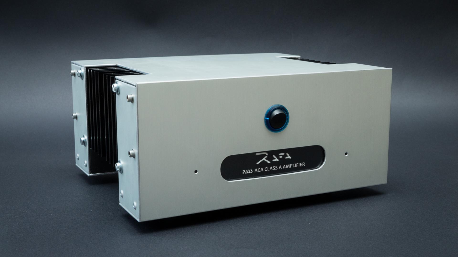

Congratulations on your build. It's absolutely beautiful, and just goes to show what a little thought, creativity and determination can do. If I hadn't been following this thread I'd have asked where you purchased the chassis. Well done! :)

Well, I want to start this post by saying:
OH! MY GOD!!!
I have spent the last two hours listening to my *almost* finished ACA! The sound is just sublime! Such warmth and body, such deep and coherent bass, nice detailed highs. Also, the sound is very even throughout the frequency range... something my 'bigger' class D amp is not that good at. It's just amazing sound, with any type of music I play.
I listened to it in my living room with my 4 Ohm 87 dB efficient Totem Rainmakers, and it is producing all the volume I would want or need, and that is with the 5W of the 19V PSU / 10V Bias setting (more on this later!). So the fellows getting the bigger 24V PSU / 12 Bias with 8W output: do not worry about this AMP's capacity to drive your speakers loud enough for serious listening on even larger spaces. It's just that good! And with such simplicity in it....
Best regards,
Rafa.

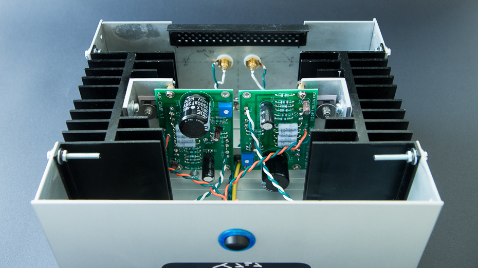

Thanks everyone for your replies. I was really overwhelmed by them, and got so excited that I gave the iPad to my wife so she can read them. Her words were: "that's lovely... and its great to see that you are not the only one in the world that, instead of spending hours watching football, you spend them sanding, drilling and soldering!" :) . She was really emotional (albeit she sided a bit with Zen Mod and said I did sound a bit 'sissy' :p ). Thanks everyone!
Well, as offered, here are the more 'nasty' inside pictures:

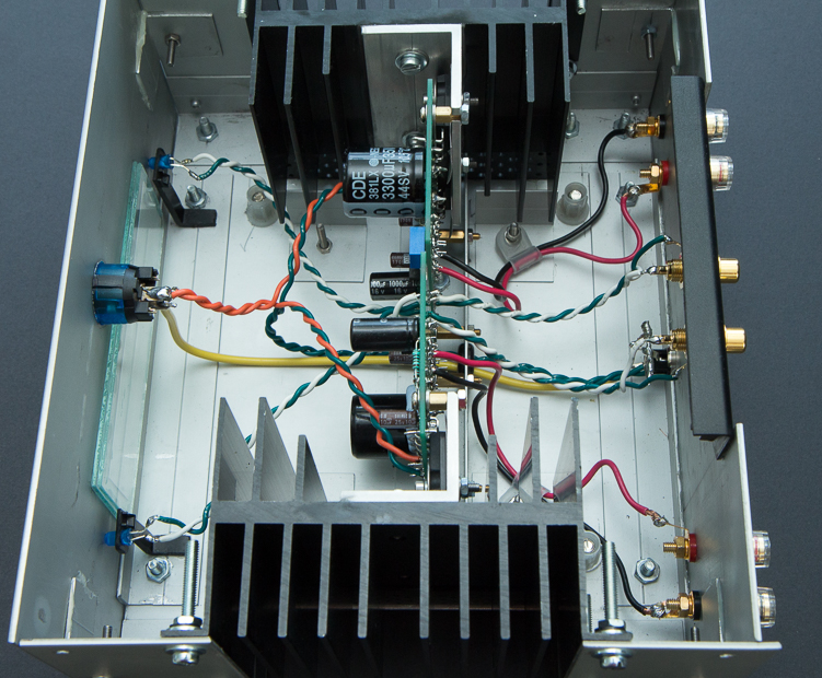

Overall front view, best to understand the 'inverted PCBs' scenario. It presented a challenge when soldering some cables and the MOSFETs, and also for calibrating the lower POT.

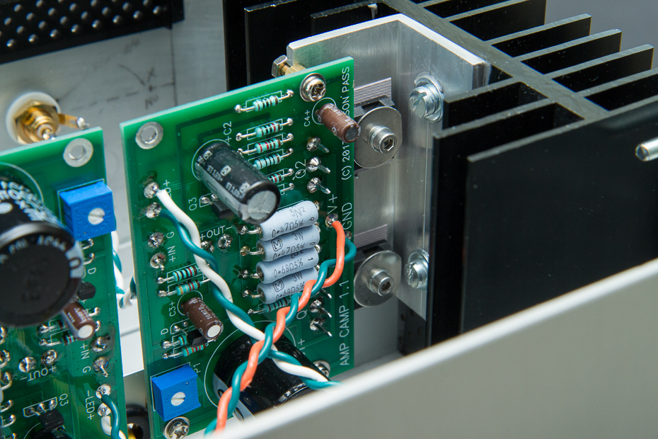

Here's a close view of the MOSFETs and their proximity to the angled aluminum profile. It was so 'close' I had to file the washers to have a flat region. That is not that great. :( :( :(

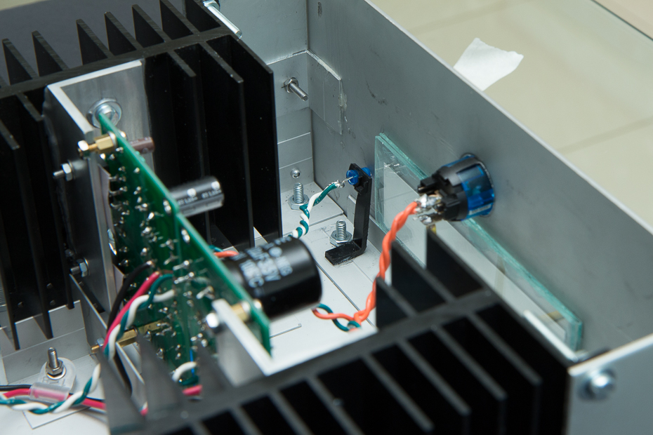

A view of the led holders and (severely out of focus) the front switch (the main DC cable is barely showing - the yellow one going straight downwards.

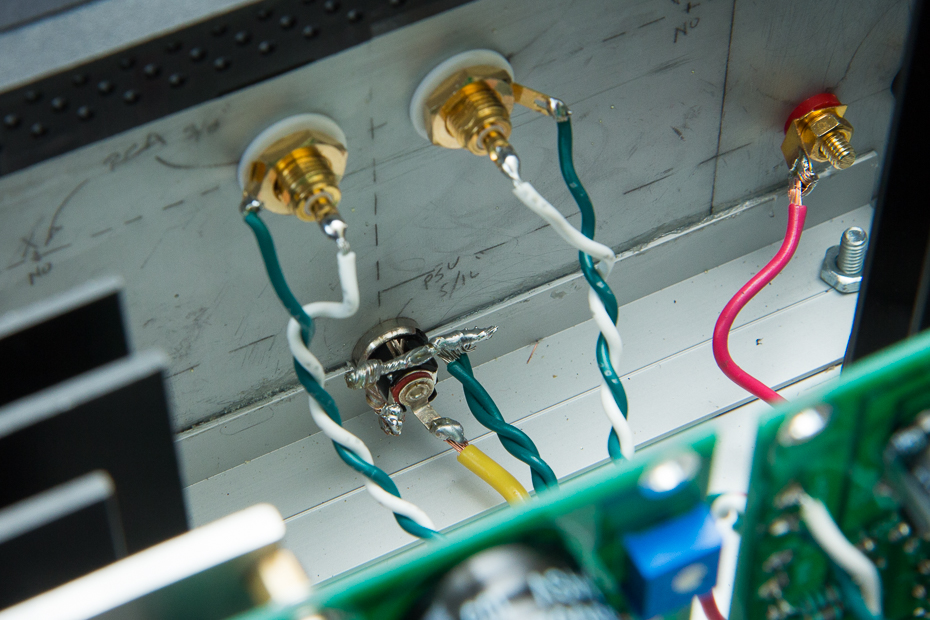

The minimalist PSU connector in the back (swamped with solder). Not so proud of that either.
The overall cable layout. Maybe the most notable 'change' to my original plan is the GND (green twisted) cables from the PSU. I was hoping to make a direct connection from the back panel to the PCBs, but since the holes were now inaccessible due to being covered by the aluminum profile, I ended up carrying them to the front along with the uninterrupted DC main where they meet the interrupted V+ cables and get twisted together to go back into the PCBs from the front. This was not what I planned, but I don't think it turned out too bad.

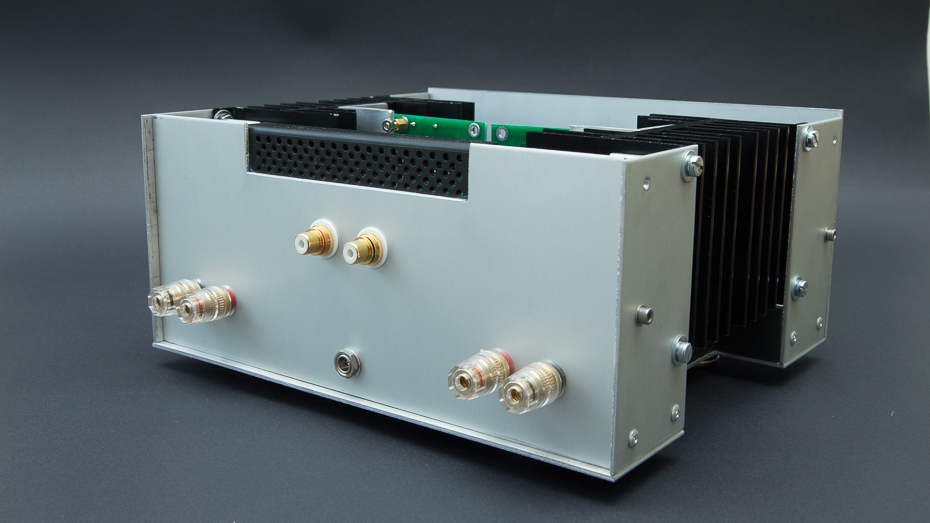

These are the connectors. I ended up moving the RCAs a lot closer than what I first planned on the 3D models to better accommodate for regular stereo RCAs without the need to pull them apart.
And, finally... here's the finished AMP, with logo an all :) :
My temps are now steady at 56º on the outside heatsink fins. That is between Bloody Hot and X*?@! Hot!!! on Mr. Pass' heat scale. :( :( The power resistors measured 70º yesterday. So I built a nice amp that can dub as a room heater or frying eggs burner :)
But, oh, how much am I enjoying the music!!!
On a final note: I have now tested the ACA with my 4 Ohm Rainmaker bookshelfs, my 6 Ohm large Pioneer speakers and the 8 Ohm smaller Kin Mini bookshelfs. The amp is comfortable with all of them, but really, really likes a nice PRE in front of it. When hooked to a 2V line level output, it performs nice, but lacks punch and almost needs full volume to reach that fullness that is so great about it. But when you put a PRE in front which elevates the gain to higher levels... all the body and punchiness just shine through!!
So, if any of you fellows feel the amp a bit thin on your speakers, first try a PRE in front before dismissing the pairing. My 4 Ohm 87 db efficient speakers fair a lot better with the ACA + PRE than my 8 Ohm 89 db efficient ones without the PRE. Just in case this is useful to anyone.
Well... thanks once more! I look forward to all the people building up their 1.6s and hearing about their experiences.
Big hug,
Rafa.
ps. I love all the cat references, pictures and stories that my Kira encouraged here! :)
