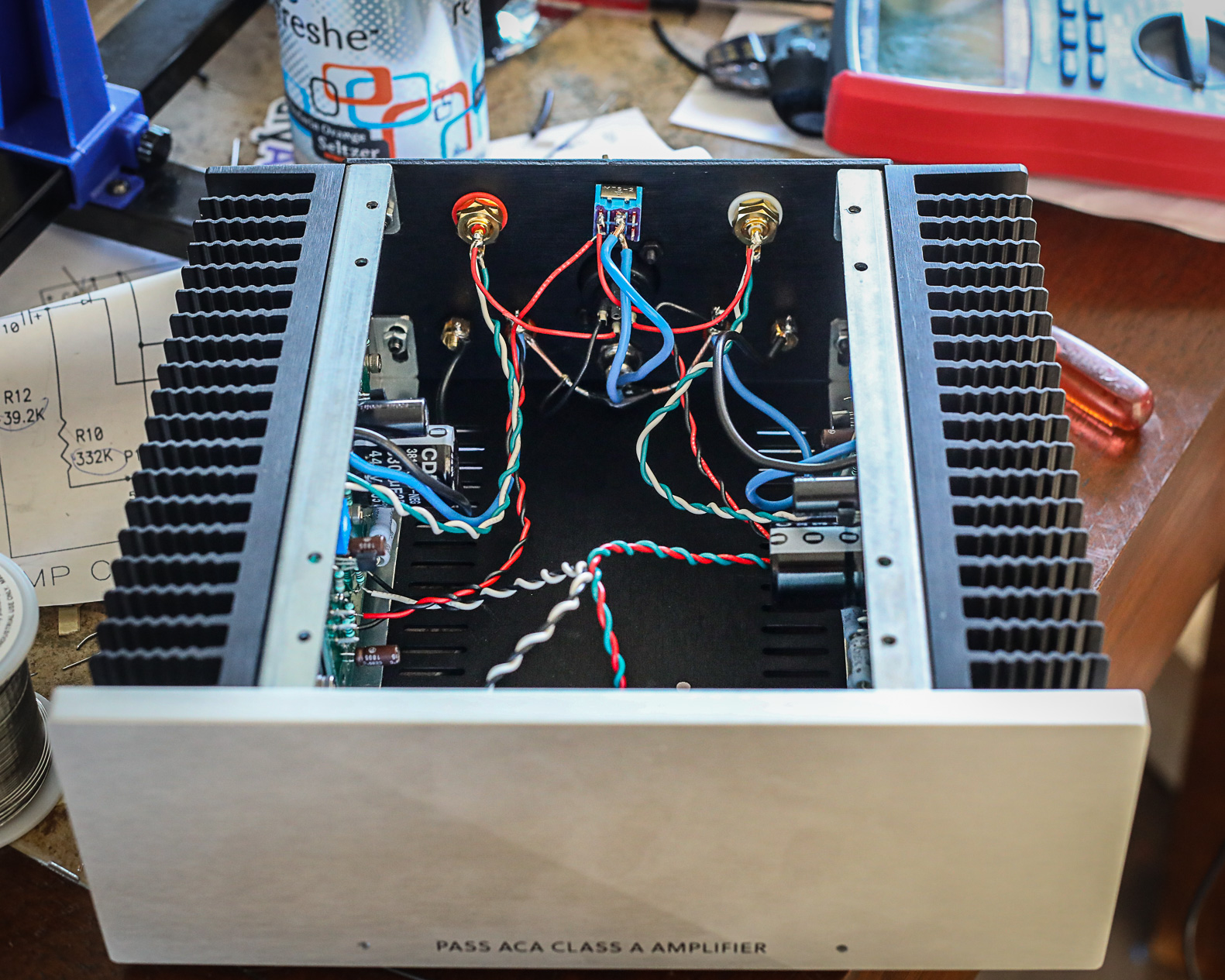

Ok so if I wire the amp the way I see it in the pics from this link as long as I don't flip the switch it runs as a Stereo amp? By the way thanks for your help.
aca16
Oh! Duh, I'll just omit the back switch and the XLR completely.
You can certainly leave both the XLR jack and switch out. You can see from the pics that they wire "into" the circuit, so if you omit them, no harm no foul.

Alright, I got both of mine finished and up and running.
Initially the output seemed a bit low but I had some filters installed in Foobar and that was the issue. With that fixed, the power is adequate playing from PC and from vinyl and with some extra gain on my preamp.
The sound is fantastic even after just a few hours of use so I'm sure they will break in a bit more. I listen to a very wide range of music and I had to a chance to everything from jazz to electronic music of various types. The only downside is that I have a huge library of music I collected over the years and they are mostly MP3's of dubious quality and those files just sound really bad. Playing from vinyl or my much smaller high res library sounds incredible now.
I two Mark Audio 10p's with a Planet10 cabinet, a sub that I built that contributes just a little to the low end, a Schiit Freya preamp and, Rega RP1 with a Hagerman Bugle2 phono preamp. As you can see I've been super busy this year collecting audio stuff :)
Thanks to everyone who helped put all this stuff together and to every one who helps us newbies out by giving us a chance to build a kit and answering all our questions.
I also happen to collect all the important parts of an F5 so at some point I'll give that a try.....
Kevin

The switch is not necessarily used to make it a monoblock, if you use the XLR, it's going to be bridged automatically. It is, however, used to make it bridged mono from the RCA inputs.
Stereo single ended, use RCA connectors on both RCA jacks and attach L and R speaker to the respective speaker posts.
Monoblock XLR, use the XLR jack and take speaker output from the two black posts.
Monoblock RCA, use the Left RCA for input, leave the right empty, flip the switch up, and take speaker output from the two black posts.

It is Alive :). Damn this thing runs Hot, 1st bias set to 10.06 or so, give a take a few. Hey Thanks everyone who helped with the wiring details, I gonna cover it and let it run another 30 min, then check the Bias again. Then its time to listen, I'm using a WJung modified Adcom GFP-565 pre-amp hooked up to Vandersteen 2ci. This should be interesting.
Oh I have another question, should I be using the same Bias settings 10v as the version 1.5 for my 1.6?
I guess since I'm asking questions, how hot is your running, after 1st Bias set to 10v and change I'm reading on the outside fins 123 f. Is this normal?
Mark
I biased my ACA amps at 12V (more like 11.8V) - which is the suggested point for the 24V power supply and yes, they do run hot - as in very hot. I'll have to check the bias again just to be sure. But right now I'm very happy listening to them bridged via XLRs from my Classe Five preamp, even with 86dB Wharefedale speakers.
I'll be curious to see how these stack up with my next project, the Aleph J.
Oh ok :).
From everything I've read thus far, normal operating temps should be 25 C (~45 F) above ambient. Also, you can safely set the bias to 12 V per side with the 24 V power supply (that's where mine is set).[/QUOTE
Ha! I was so into building the Amp I neglected to turn on the Air Conditioner, it was 83 in my apartment.
This Amp has a dead silent background, sounds so sweet so far. It drives my Vandersteen just fine, volume on my pre-amp is around 12 oclock.
Thanks Mr Zenith.
