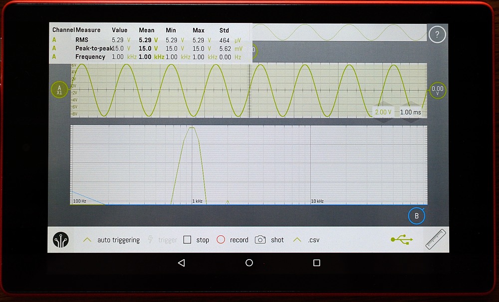

The other ACA unit measure identical. 1.46 - 1.47 A when "bias" set to 12V and current decreases a bit during warm up.
Distortion this time measured at 1 kHz (8.2 and 4.1 ohm load). Both has 2nd harmonic as most dominant but very little at 8.2 ohm load. Output power is approx. 3.4 W at 8.2 ohm and 4.1 W at 4.1 ohm. I decreased the input signal a bit from 8.2 to 4.1 ohm load.
I think quite good results for both units. Then I can begin building the linear PSU's…..

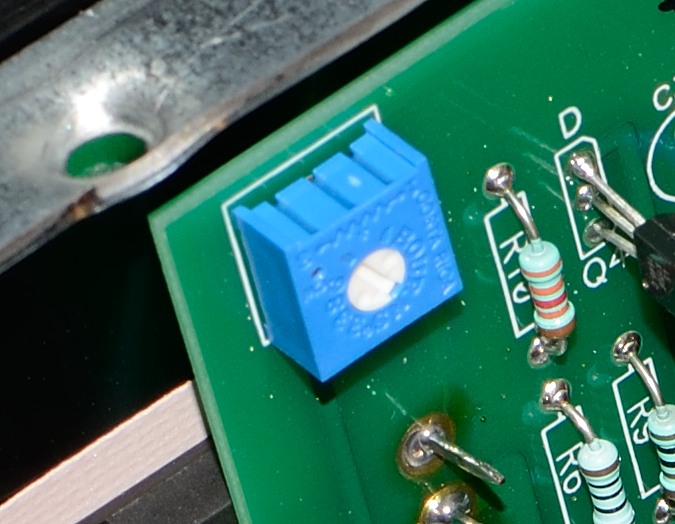

Yes, the amps are very predictable in behavior and only one adjustment. I made an effort to match components for each amp. I used 0.1% for the NFB resistors to be sure to have identical gain. I just looked at the Bourns blue pots to see which position they ended up in. Pretty close for the two ACAs?

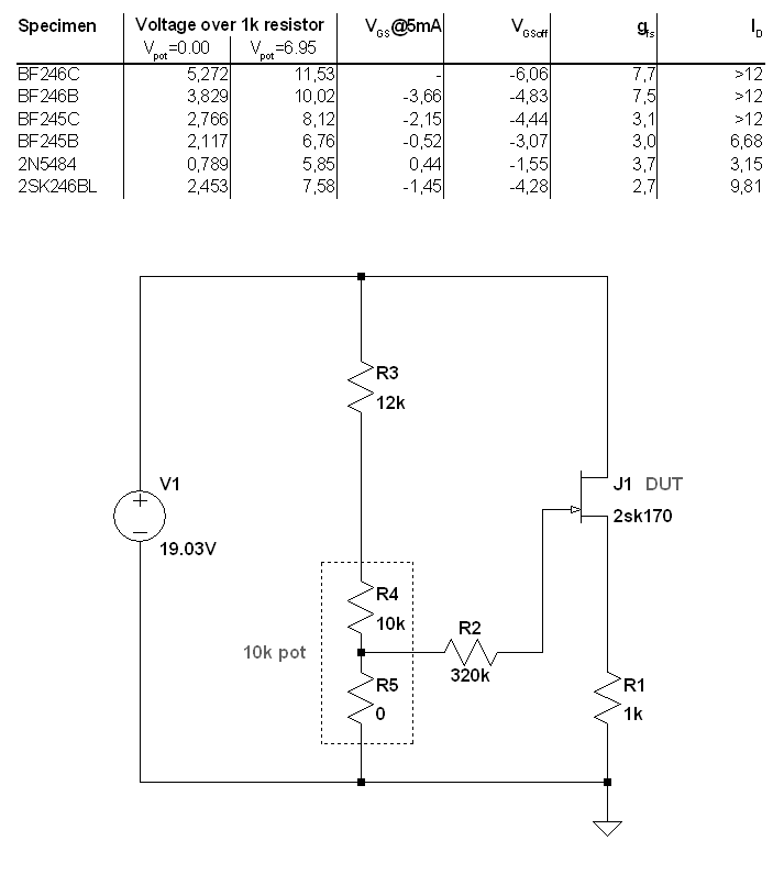

Ah, great, you're discussing JFET's again 😀. Let me chime in...
While waiting for some other parts I had to order for a pair of ACAs, I've been thinking about what kind of cheap and in-production JFETs I could use instead of those LSK's and thus avoid overseas shipping.
@Loudthud wrote the following in Post #761:
The requirement for the JFET is that it will conduct 5mA with a gate-source voltage in the -1V to -4V range.
So I've put together the little test circuit shown below and tested one specimen of every kind of JFET I had in the parts bin. Only with the BF246C I was unable to set a current of 5mA, so it seems to me that this part will not work as a substitute. All the other parts permitted the setting of 5mA through the 1k resistor (R9 in the original schematic), albeit with VGS not always in between -1V to -4V; the 2N5484 even showed a positive VGS.
Since I don't have a working ACA just yet, I can't make any real tests but only assume which parts would work OK. That would be the BF246B, BF245C and 2SK246BL. I'm not sure about the BF245B and the 2N5484. The BF246C will certainly not work, because the current through it is too high and thus the optimal bias point cannot be set.
After running the specimens through the test circuit, I tested each with a DCA75 for their VGSoff, gfs and ID values. All my devices have a significantly lower gfs than the typical 22 mA/V of the 2SK170. How would that influence the original circuit? Lower open-loop gain and thus higher distorion? I'm not that familiar with JFETs, but I'm trying to get my head around it 🙂.
wrong ;
in ACA , JFet situation is like this : job of it is to keep steady voltage (sag) across R9 ; there need to be , say, 3 to 5V , usually aroundish 4V , to open Q1 properly
while that is the case , gate of JFet can be set anything from ( observe P1) up from GND potential to U/2 potential
so , mentioned 4V(ish) voltage is attached to Q1 , while having nothing with possible or needed Ugs voltage for JFet
what is most important here is that you can bias input JFet in a way to have ~4mA Iq , while still having decent xconductance - read - Rin , cojones, whatever ...... to fulfill all expectations regarding pumping that input capacitance of Q1 , augmented by Herr Mueller's effect.
so - choice of possible JFets is broad , even broader if you insert appropriate resistor between top of R7 and top of JFet drain line , thus slightly decreasing JFet drain voltage ....... all with JFet sane dissipation in mind
