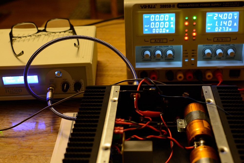

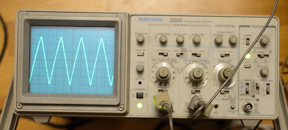

I made one more measurement on the ACA this evening. Tomorrow it will be the other unit. I also found the error on my new lap PSU so I now have two working channels. The scope picture shows a 20 kHz triangle in 4.1 ohm load (2V/div). It looks OK?

Looks beautiful!
Time to try some music.
Yes, I could try to hook it up using the lab PSU to power it.
Maybe I will do it when the 2nd unit is up and running.
In the moment my 300B is playing.
Tried in a period to use a big SS amp to drive the 15" woofers but after a while I preferred the sound of the 300B alone. It gives a much better integration of the bass sound. It was for preparation if ACA was not strong enough to drive the 15" woofers. But if 300B can......why not the ACA. It will be my starting point to see how it goes.

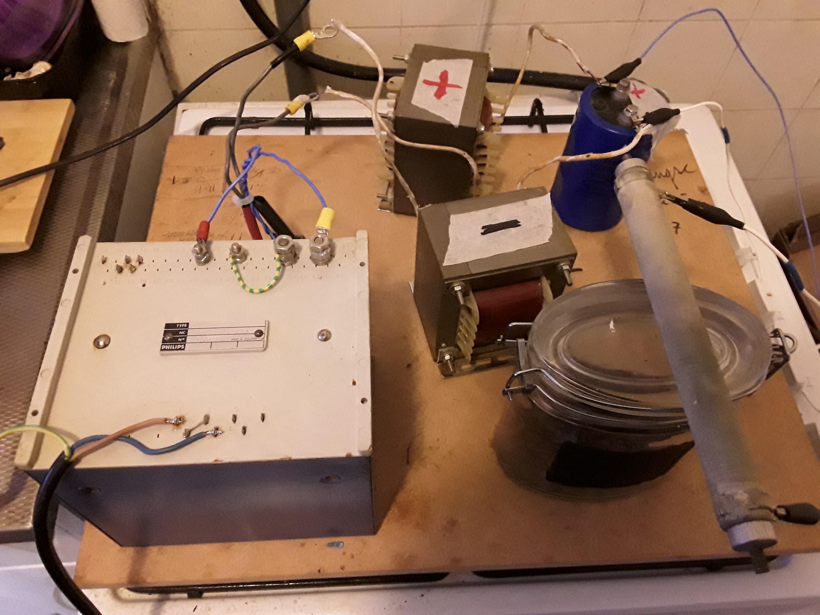

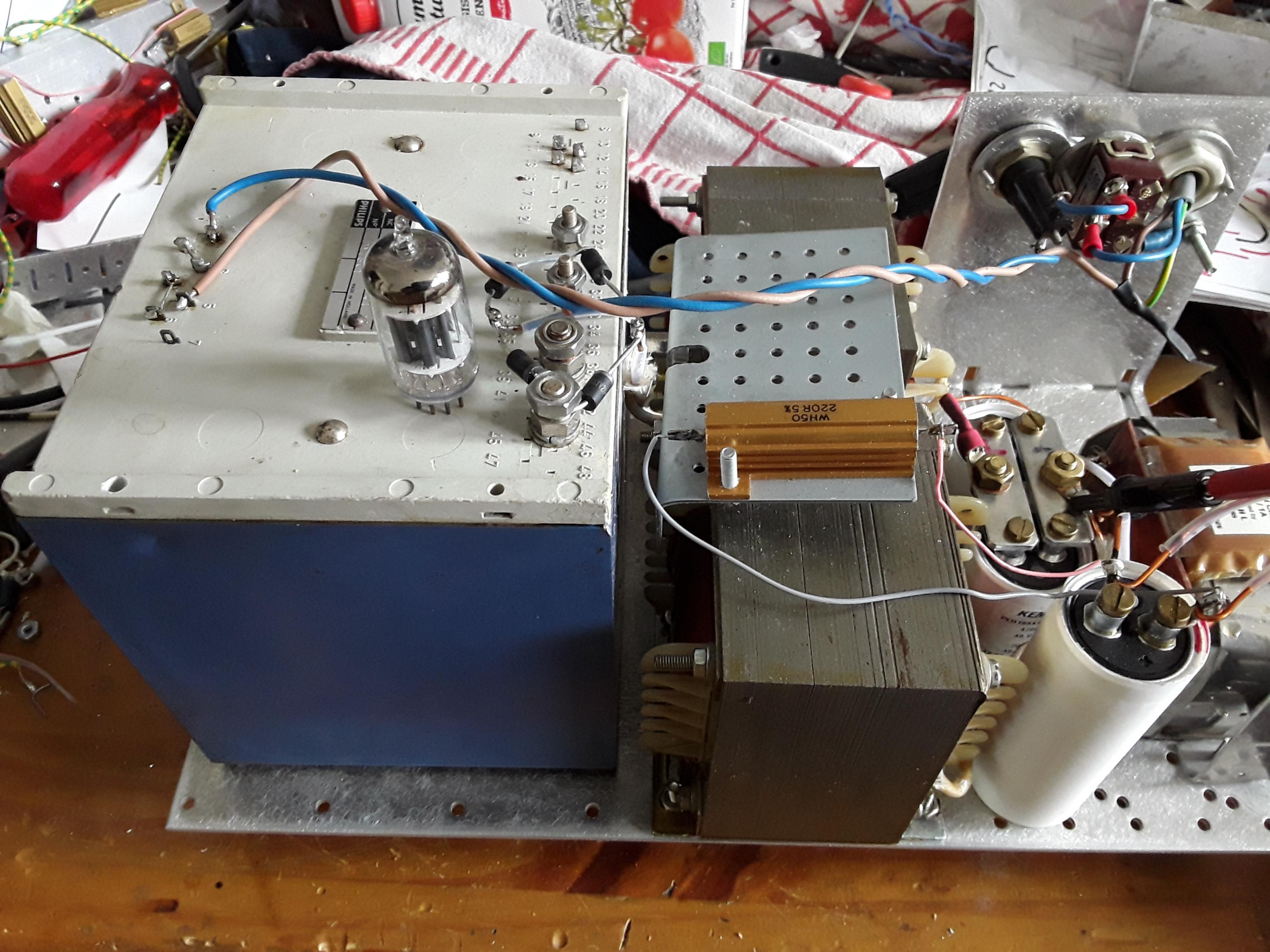

For those people willing to try a choke input power supply i found a surplus store in the Netherlands that has an old big and heavy power transformer from Philips in stock. It is to heavy to send outside Europe ( 11,5 kilograms) . There is 110 210 220 and 238 primary and a 11,6 v 25A and a 23,2 v 10A which i put in series. There is a screen between primary and secundairy winding. I use two 0,5 ohm dcr chokes right after the diodes. Of course you need to use a choke with higher dcr like the ll2733 from lundahl to get a lower dc voltage. I get around 27,8 volts with a 1,8 A load. Using the 210 input while input is 230 volts here. Because i need more than 24 volts for my amp.
So if you are willing to use another choke and are located in Europe it could be nice.
Can also wait for Meper to finish his choke input.
Greetings Eduard
Ps google for elektrodump and you will find the transformer. He has some kemet peh200 47000 63volts caps too. I bought 40 volts caps at mouser because i had limited space

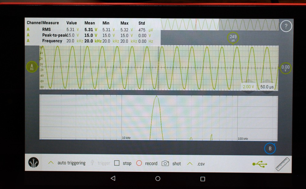

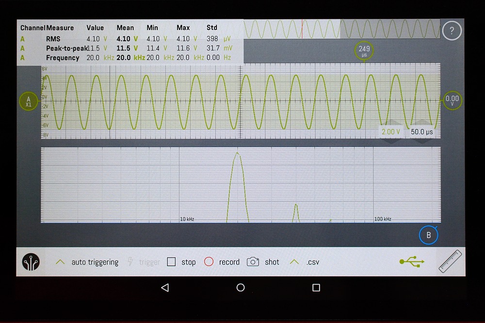

I tried my Labnation digital scope which has a FFT analyzer to see what such a cheap scope can show. With 4.1 ohm load the dominant distortion is 2nd harmonic but with 8.2 ohm load 3rd harmonic is the most dominant. If I turn input signal down a bit the distortion goes below what the scope can show and maybe 2nd harmonic is dominant at lower levels. Signal is a 20 kHz sinus. I normally play well below 1W in average. But now I have something I can compare with when the other unit is tested. The FFT scale is dB so it is logarithmic.
