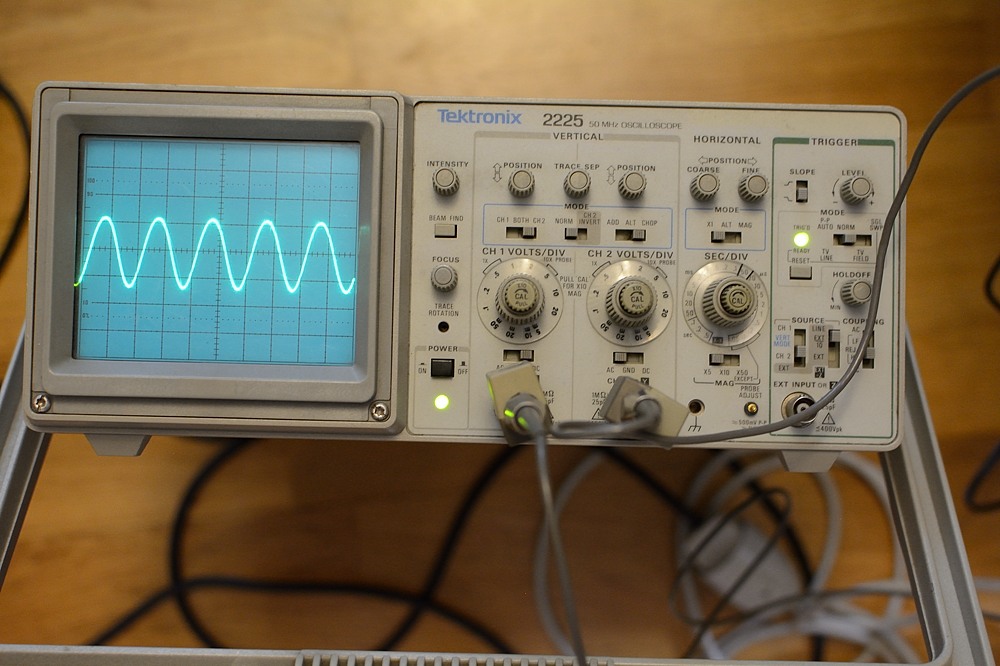

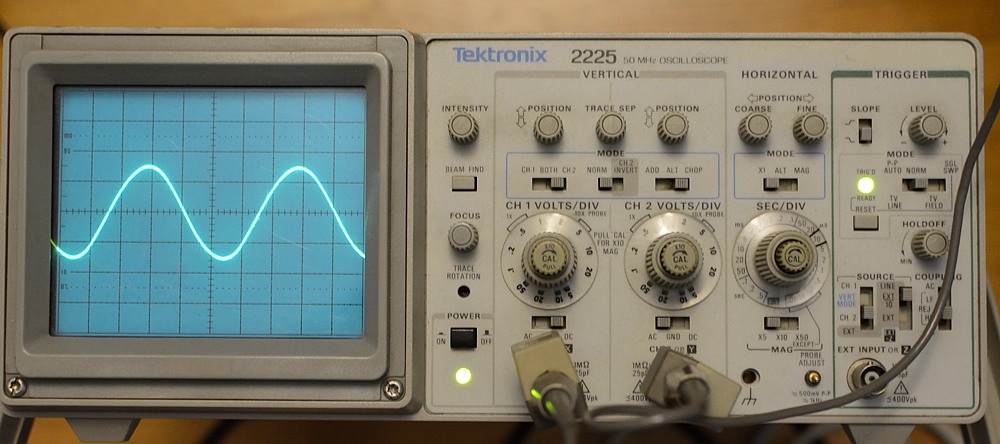

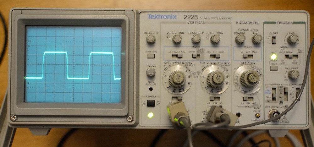

20 kHz sine looks like this.....Ok I think.
When I turn signal down to zero I have approx. 1.4A bias. When I turn up to 1.9V in (5.3 V RMS out) bias drops to approx. 1.27 A.
Amp seems to behave well.........
I see no problems so far.......
Both photos look good. The amp behaves admirably bearing in mind the simplicity, which is its main virtue.

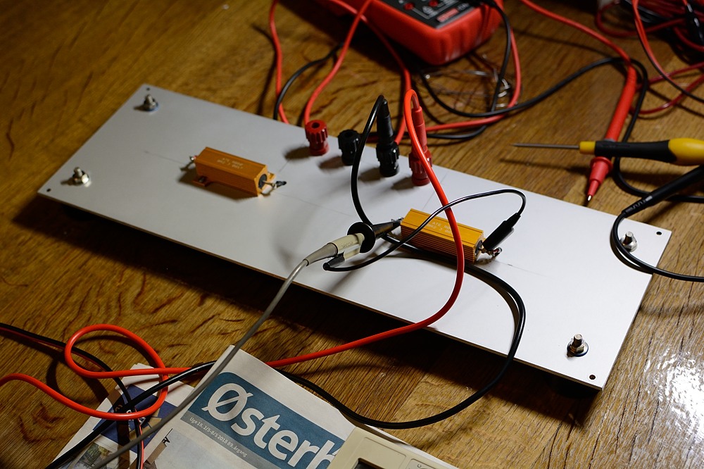

I set the lab PSU to 24V DC (think you can see it at one of the previous pictures). I just got the lab PSU (made in China I think.....rigth display not working! ....I am in contact with the seller for a fix....but both PSU channels working).
Yes, I can do 2 x 8.2 ohm in parallel. I put two 50W resistors on an alu rack front plate and put rubber feets under it). Will do it during the comming days. But I can only get 1.9 V out of my generator which seems a bit to low to get full swing at output with the NFB resistors I use (33.2k and 121k).
Lab power supply can really be useful when playing around with amplifiers, tone generator, oscilloscope and various loads (capacitive as well!!).
Try to load the amp with 4 ohms, set the voltage to 24V, feed it 1.9V (any frequency, sinewave is good - avoid square waves because they stress the amplifiers unnecessarily...), and then see how the amp behaves when you start changing the current on the laboratory power supply.... 🙂

I will do the 4 ohm test during tomorrow or in the weekend.
I just set the current limiter on the PSU to approx. 2A just as a safety. I have not tried to reduce current below what the amp "needs".

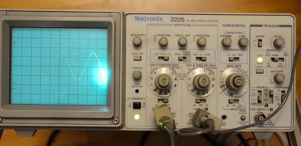

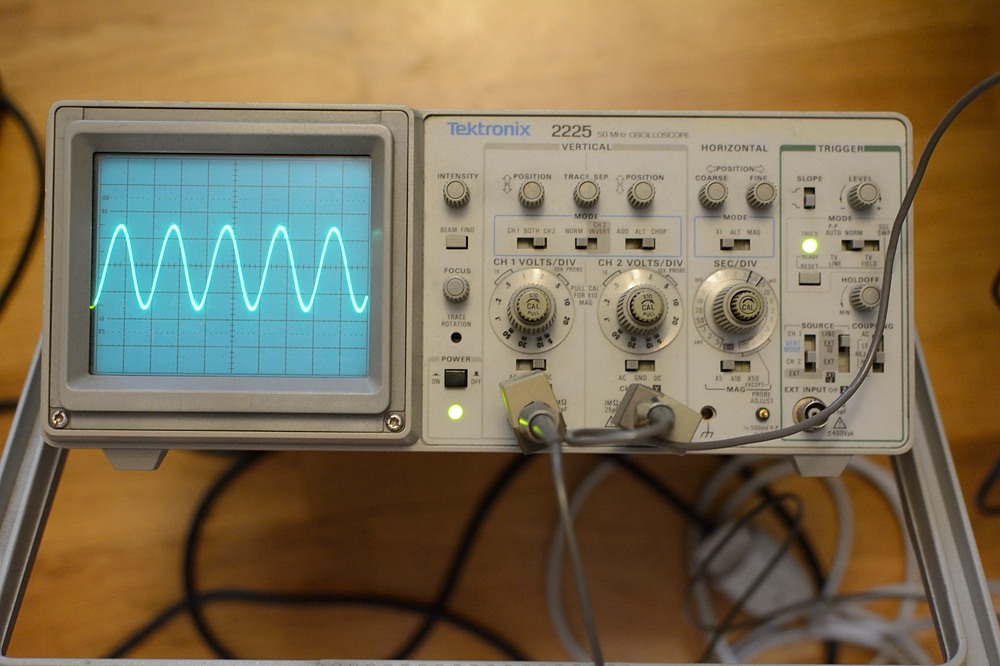

Ok.....I did a quick test here in the morning before driving to work.
One picture 8.2 ohm the other 4.1 ohm (10 kHz sine, 5V / div). You can see output voltage drops. Bias also drops to about 1.15 A. If I turn down the input signal to zero bias goes up again to approx. 1.4 A. It seems when the amp is cold the bias is a little higher than when it is hot (maybe 0.05 - 0.1 A less bias in hot condition).
