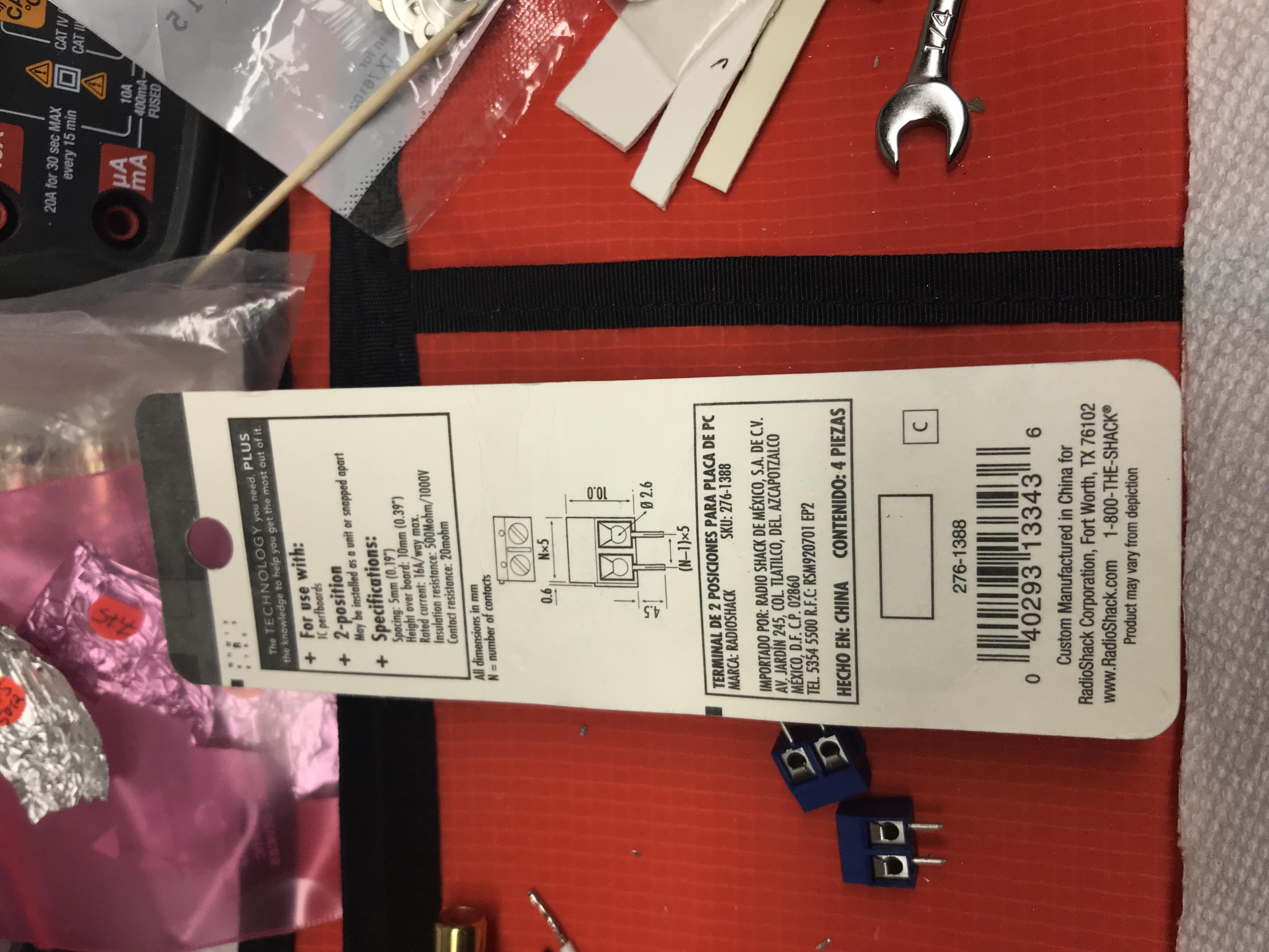

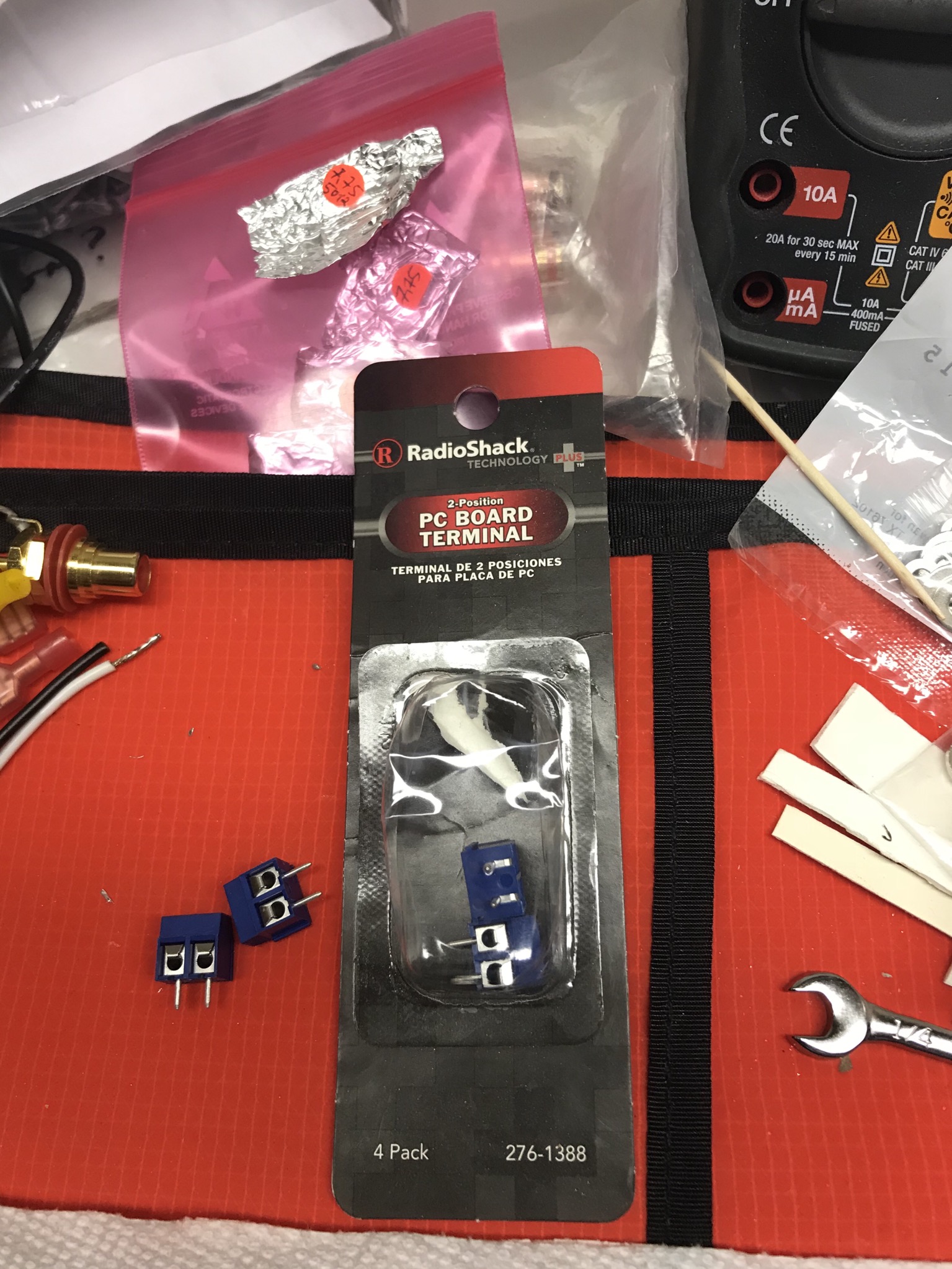

Chromenuts - what is the pitch spacing on those little blue terminal blocks in your assembly photos a few posts back, and from where were they sourced?
LOL...wasn’t sure what you were talking about and had to look back. I was going to use those for my input and output connections, but just soldered them to the board instead.
They are 5 mm pitch and came from Radio Shack...part number 276 1388. The local shop closed down last year by me and I bought about half of their component storage cabinets along with contents.
I’m sure others did the same and you can find them online, but also there must be plenty of similar options from Mouser or Digi Key.
