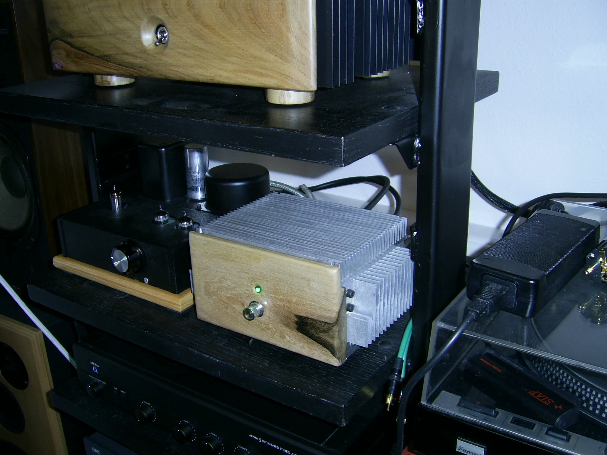

Hi to ACA community.This is my ACA made from materials found mostly at home.For SK170 not shure but IRFP250 is probably fakes PCB is made at home by the suggestion of Rudi Ratlos.Sounds good to me and I'll made another one with proper elements.

darker sound , higher internal capacitances
just buy intended type ........ there are as many as cockroaches , why should anyone fake them ?

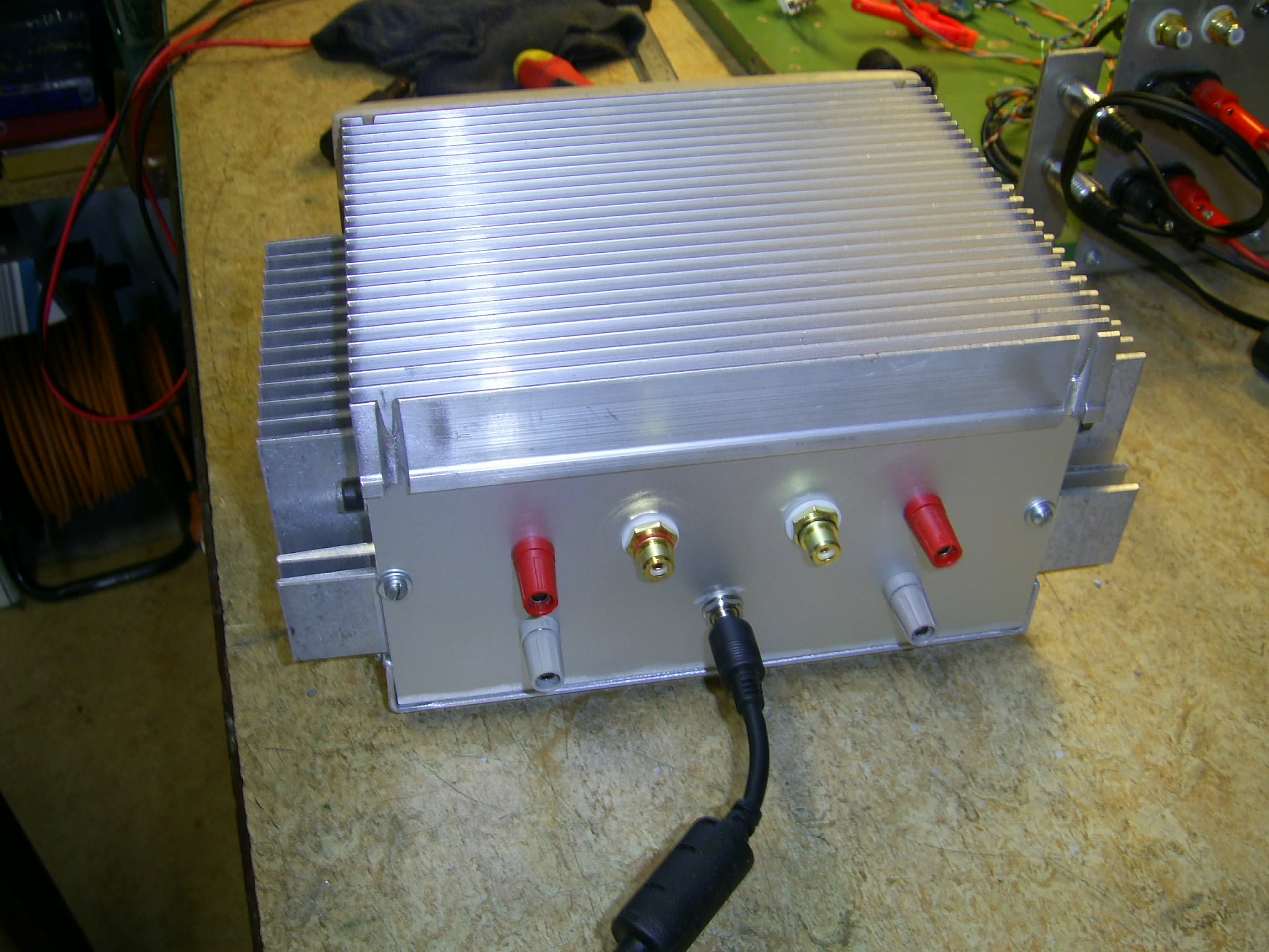

I now have two ACA mono blocks ready for test.
Will start the job making the linear 24V PSUs for them. I also have a lab supply comming soon. Then I can test with current limiter etc.
I used PCB screw terminals for easy maintenance for this proto type like version of the ACA. 2 x 3300 uF Jensen audio grade output capacitors and a KEMET R75 MKP 10 uF / 90VAC as input capacitor. It has very good high frequency performance according to data and measurements. Will see how it sounds.....

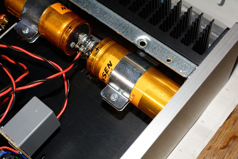

For the two parallel Jensen caps. I have following measurements:
10 Hz, Z = 1.8 Ohm
100 Hz, Z = 193 mOhm
1 kHz, Z = 22 mOhm
5 kHz, Z = 8.8 mOhm
10 kHz, Z = 7.9 mOhm
20 kHz, Z = 7.5 mOhm
50 kHz, Z = 8.1 mOhm
100 kHz, Z = 9.1 mOhm
It has its lowest impedance around 20 kHz but it still very low at 100 kHz indicating low inductance. The theoretical impedance 1/(2 * Pi * f * C) is impossible. So now I know why large capacitors switch from negative to positive phase angle at high frequencies. Few weeks ago I considered that a bad sign for a capacitor but now I can see why.....
I made a few measurements on the output cap in the kit:
10 Hz, Z = 5.5 Ohm
1 kHz, Z = 82 mOhm
100 kHz, Z = 61 mOhm
Interesting that the output level is only about 0.5 dB down at 10 Hz in 8 ohm when the impedance of the capacitor is relative high at 10 Hz. It must be the NFB that lowers the ouput impedance.
Maybe my setup can output more power at the lower frequencies......will see.....first it needs to be tested at see if it work at all.....but so far so good......

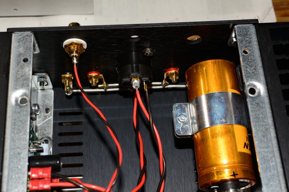

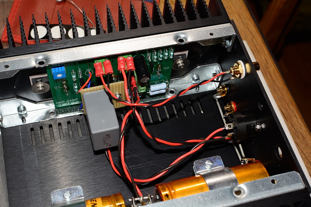

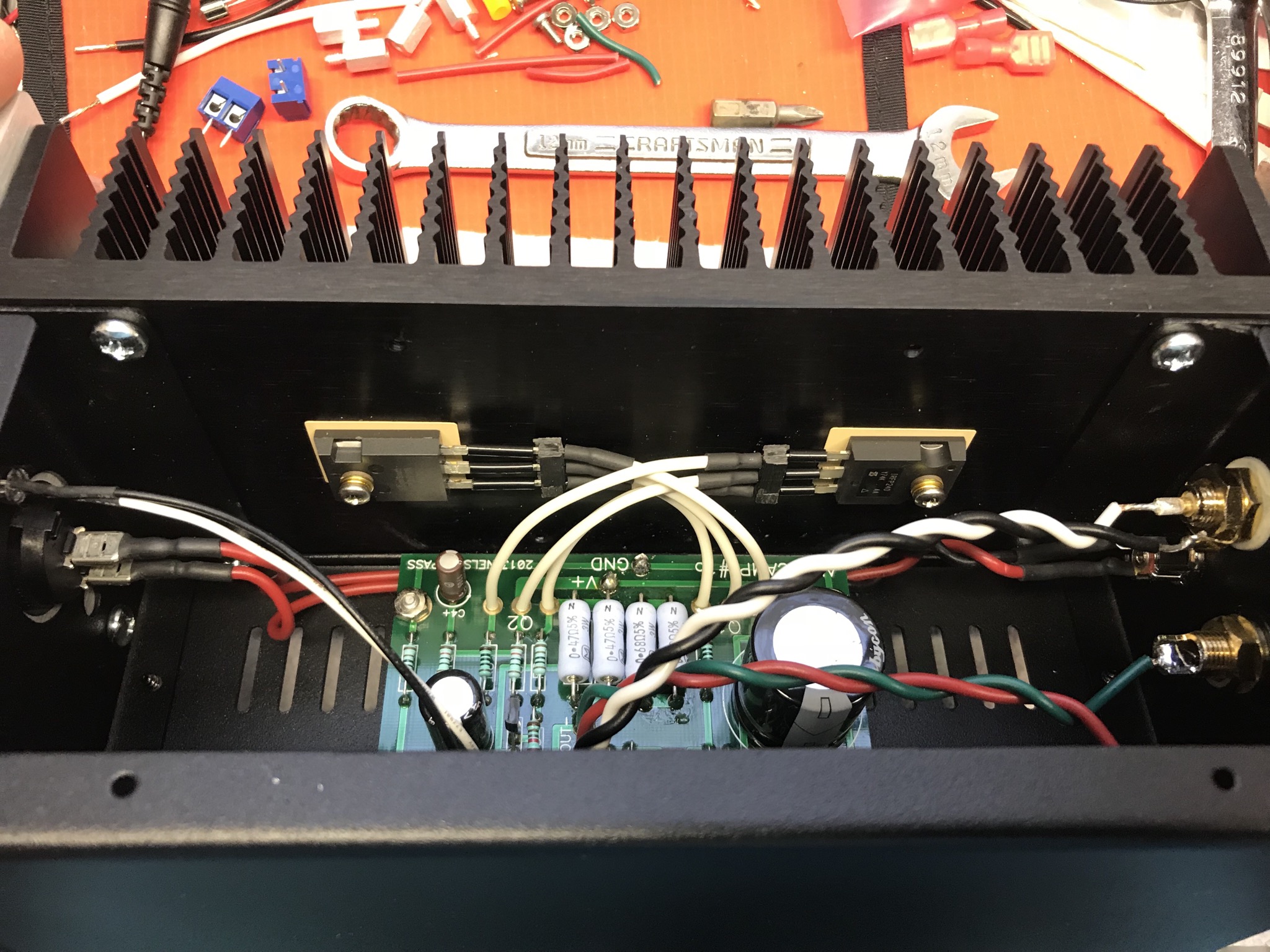

Hi all...figured I’d post a quick pic of what I’m doing with the ACA 1b boards and chassis I picked up a month or so back in the swap meet.
Since they were so cheap and simple I felt compelled to try building them before moving on from my gainclone 3875 that I built a few years back into an F2J project. I sourced the components with Nelson’s original BOM. Made a few substitutions for NLA items and additional resistors needed for subsequent modifications to the circuit. Ordered it at the same time I ordered parts for the F2J from Mouser and Digi Key.
I like to build from scratch and make my projects unique in some way, but this time around having the ACA cases made me think about other options.
I thought I was going to build big linear power supplies in separate cases that could also be used with the F2J, but I wanted to go A to B more with the ACA so I could have a new toy to listen to.
I did take time to set a way up to use a few unmatched backup Semisouth R100 I have in the ACAs. I didn’t know if I wanted them to stay in the ACA, so I made some sockets with extension harness’ for them to connnect to the PCB which I relocated to the floor of the case.
I had some 19V laptop supplies to try, but decided to just pony up for the new 24V Meanwell supplies and “cut to the chase” so to speak.
I also did a little rearranging on the back panel as the 5 way posts I had on hand fit directly into the horizontal pair of holes and seemed to make routing wires a little better.

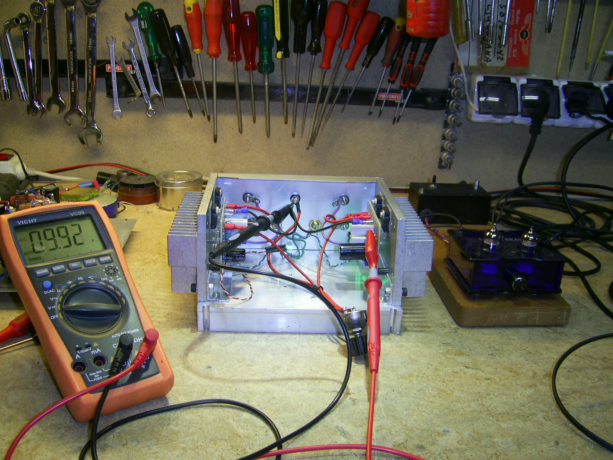

Here’s the first one together and fired up for an initial test and bias adjustment. The only test equipment I have is my ears. Not sure how things will go or if I’ll be compelled to swap in different transistors, but the option is there.
