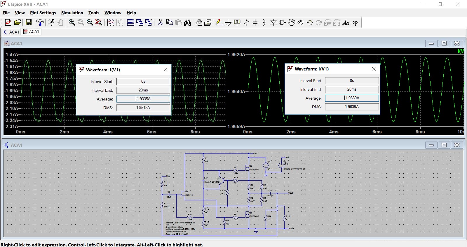

What was interesting when looking at the current draw from the PSU was that when the amp delivered close to full output the current dropped to about 1.1 A or so. If an unregulated PSU is used this will cause the voltage to raise. How much depends of the internal impedans in trafo etc. I will use a 300 VA trafo pr channel. It will keep a very constant output voltage and will not vary much with load. It was a reason to use such an over dimensioned transformer. For the test I used a regulated lab PSU.
Maybe some can comment on the current drop at full output.....if it is real or my amp has a problem...….
Could it be that the meter is "fooled" so it can't show a correct RMS value at frequencies much higher than 100 Hz (have to check that)?
If the test frequency is e.g. 1 kHz at full output then there will be an AC current. It requires a true RMS A-meter.....so maybe I saw something that was not real. It is my theory…..

A simulation shows the current changes very little, so yes it could be a measurement issue.
This is a composite image at near full output and then at a very low output. Supply current is being monitored.
Ok.....I am quite sure now that the A-meters in the lap supply is not true RMS.....so they are good for DC only (maybe 50 Hz also). I need some more advanced to measure RMS current when it is AC.
