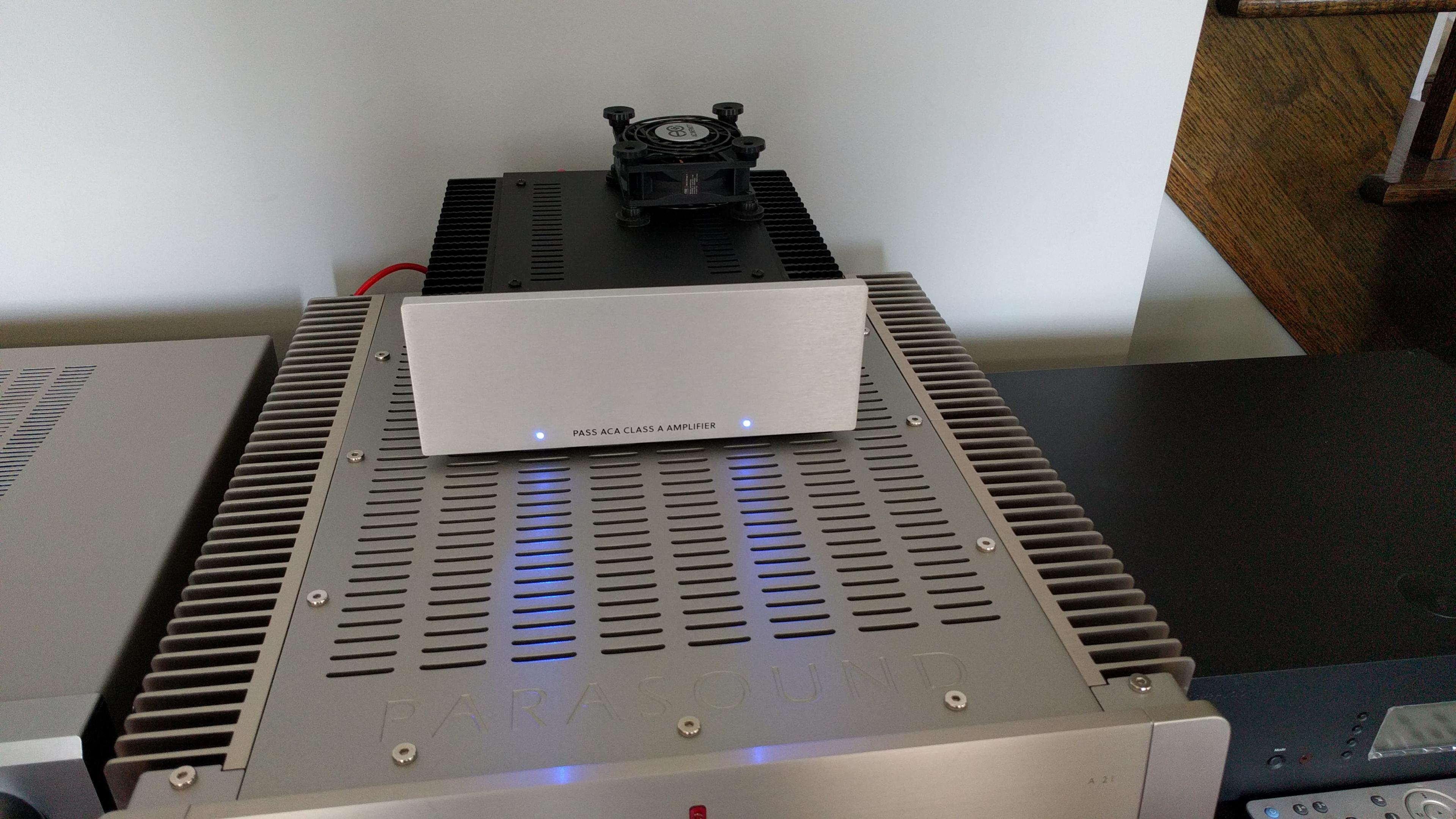

Thank you 6L6 for the build guide that helped me managed to build my first DIY kit successfully. I didn't want to say too much prematurely but I have been using it for a week now without issue.
It does make some noise on switch on and off, but it's not loud enough for me to worry and it should be an easy fix if I have to. I am tempted to buy another kit to get more power but it will be a tough decision because when I compared it to my 250 W Parasound amp I couldn't tell a difference at moderate level (70-75 dB) from where I sit.

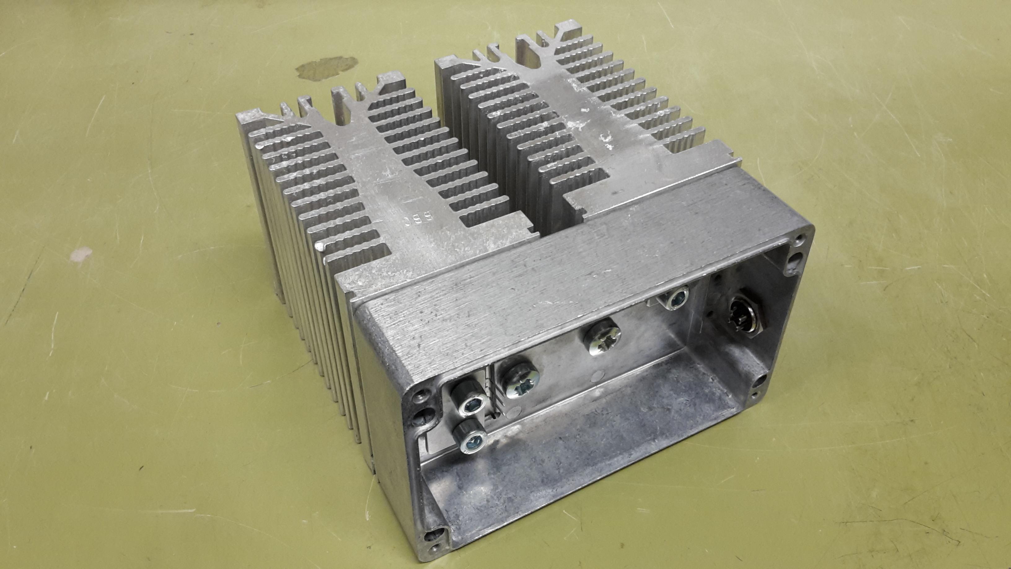

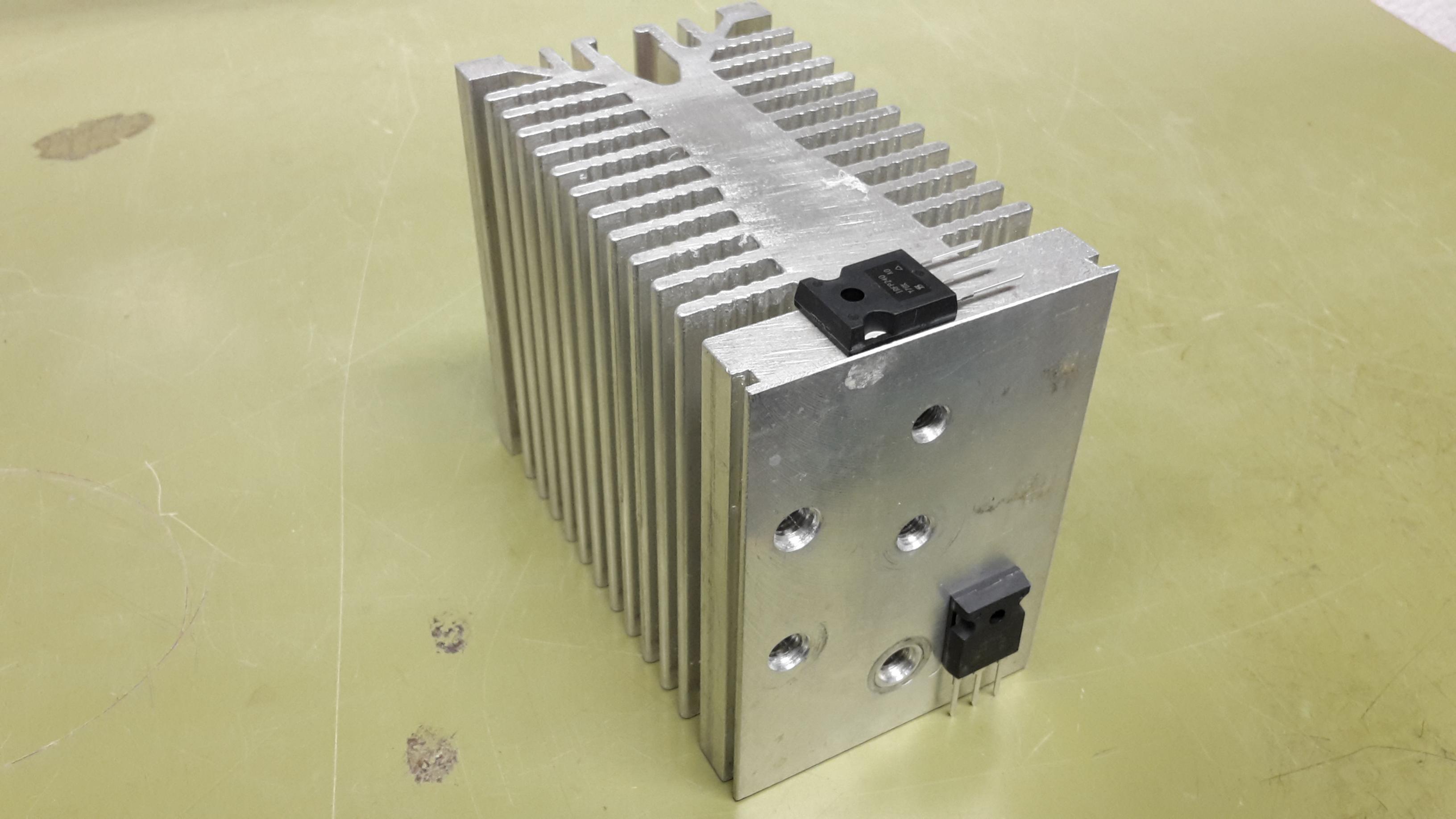

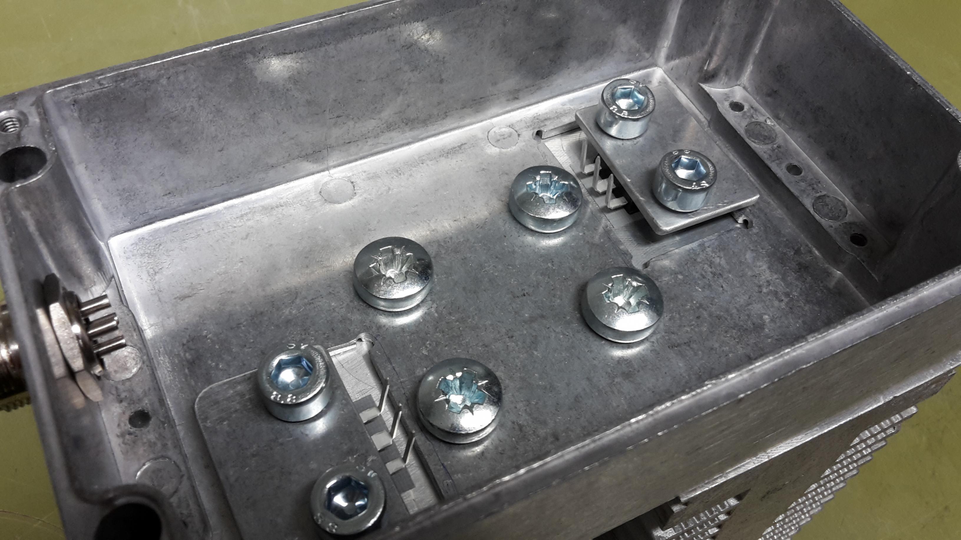

Here're the heatsinks I'm gonna use (transistors for scale). Salvaged them from a huge thyristor thingie. They're weighing in at 1340g each. One mosfet will be mounted to one heatsink and I'll build two monoblocks.
The 'sinks are mounted to the case using the already present threads (M8!). I've cut out two small rectangles of the case to be able to mount the FETs directly to the heatsink. The scrap pieces came in handy to clamp the transistors to the sink, once again using the already drilled and tapped holes (M6 this time). Heat transfer should be fine.
The amps will be oriented like on the photo when they're finished. I will place some rubber feet or spikes beneath them (2cm or something) to ensure proper ventilation.
Thank you for the good news. You have just given me another incentive to go for it. For now, I simply unplug the red RCAs before turning it on, or off. The first time I did that, without perfectly steady hands it caused the speakers to "pop" a little. That's because I forgot about the inverted polarity and pulled the black ones.🙂
