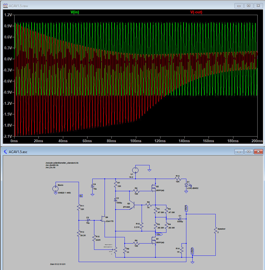

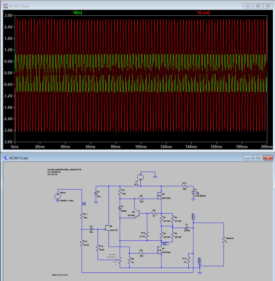

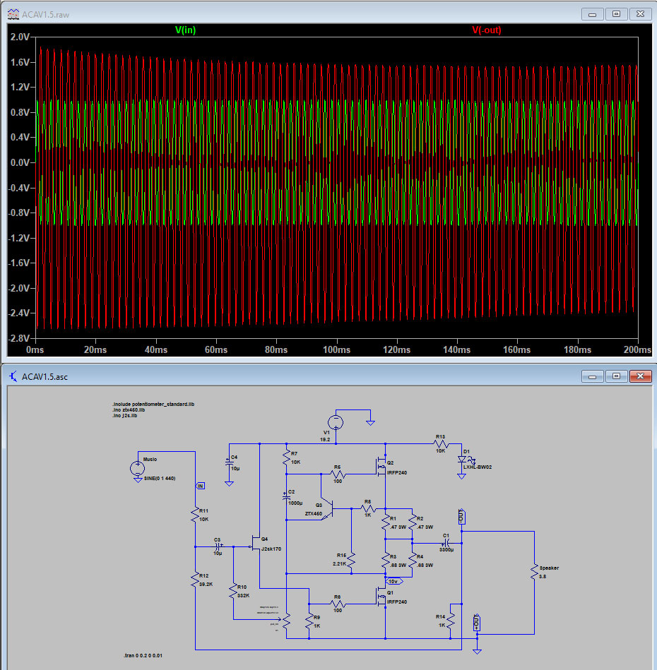

While waiting on the ACA parts, I decided to model the AMP in LTSpice (I'm sure I'm not the first one to do it, but I wanted to try out the software and get more familiar with the AMP design, so I thought it was a nice idea).
And... I decided to model the Speaker as a fixed resistor (which I know it isn't, obviously, just for theoretical purposes), and decided to put a nice 8 Ohm speaker, my own 3.8 Ohm minimum Speakers (Totem Rainmakers), and a very demanding 2 Ohm speakers.
Here are the graphs on a 440Hz sine wave.
The 8 Ohm speaker shows the amp at a nice and symmetrical +-3V over the 1V input signal. Nice and clean (the FFT also show the nice 2nd harmonic predominance! Really neat!).
The (my) 3.8 Ohm speaker shows a more pronounced asymmetry on the + vs the - output signal, now only achieving +1.8V vs the -2.8V. Also, the amplitude of the amplificated signal starts to decrease over time.
The theoretical 2 Ohm speaker shows this behavior to greater extents.
Obviously this is all theoretical, but that certainly does not bode well for my speakers. Nothing we didn't already knew, but a nice confirmation at any rate 🙂 .
Hope someone else finds this interesting, if not, just ignore my post.

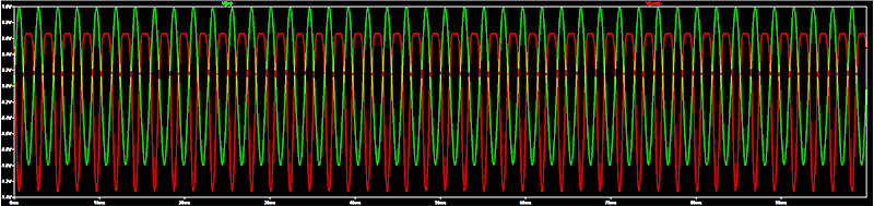

Edit: Maybe I need to let the simulation run for some seconds so the capacitors get a chance to charge? Would the software take that into account?

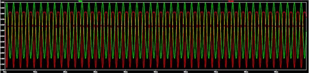

Edit 2: The 2Ohm run after 60 seconds is now more stable, but shows some clipping on the positive crests and the same asymmetry as before:

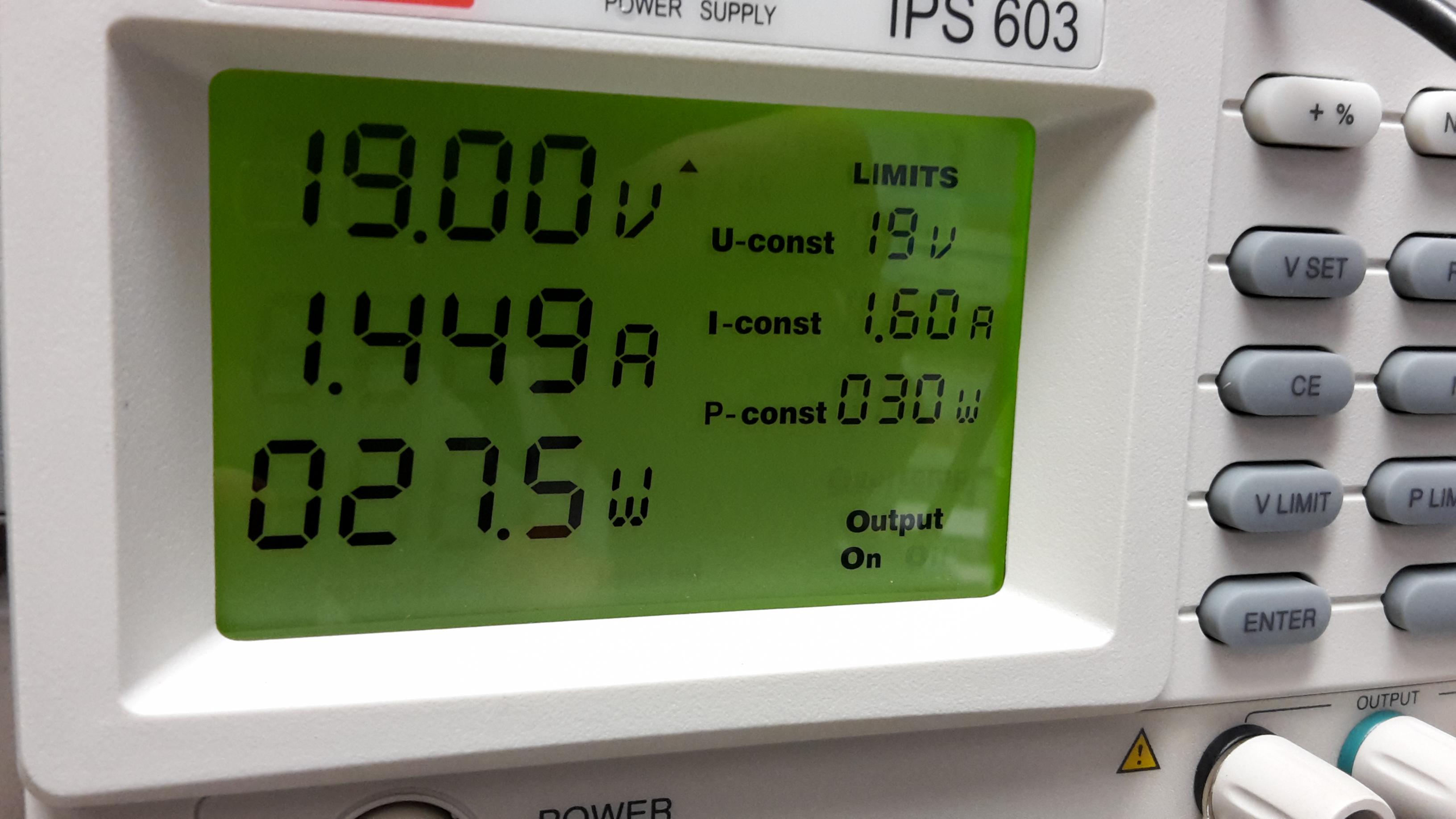

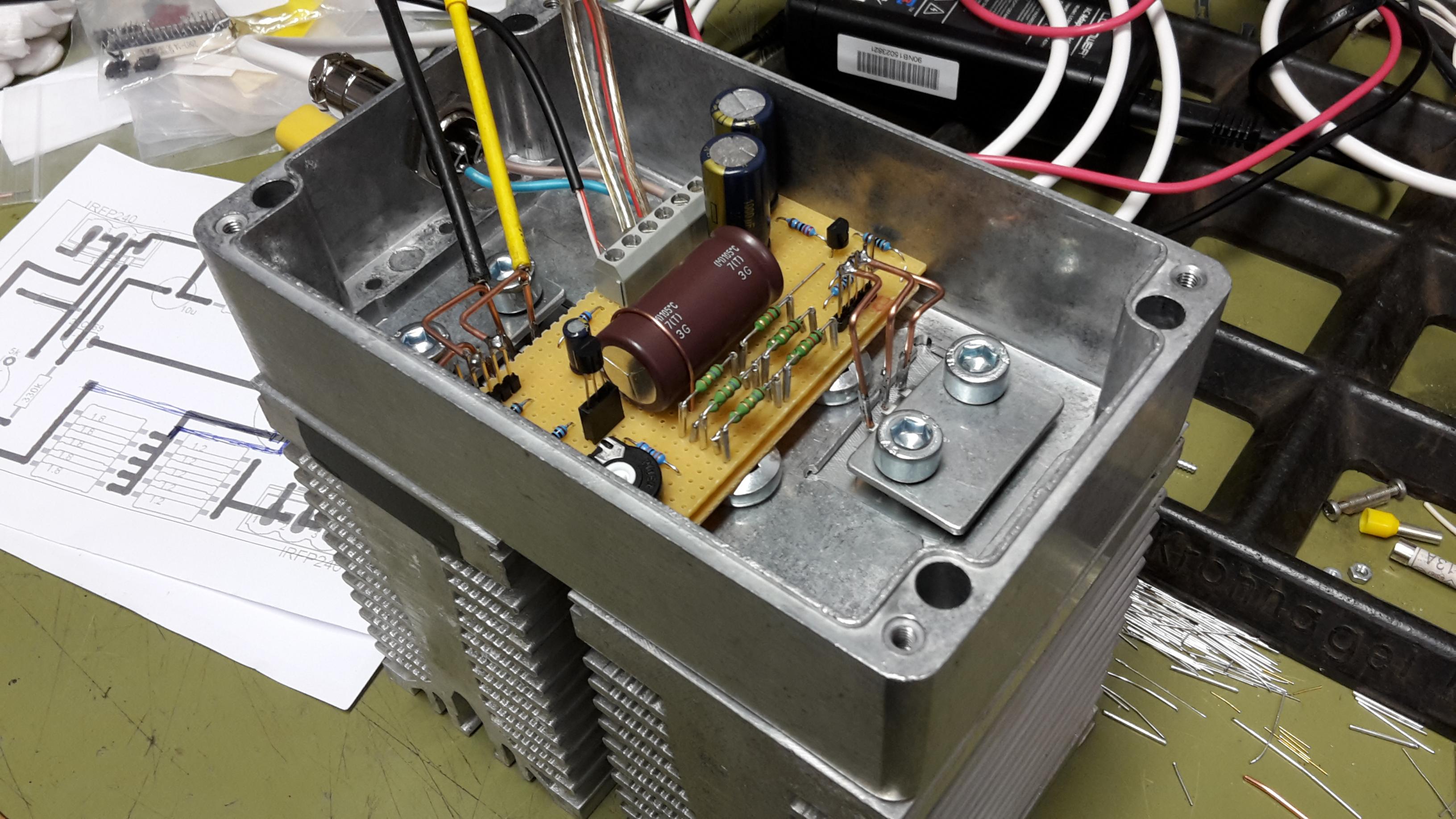

First channel running with 2SK369. Still only lukewarm after 20 minutes. Top of case from the mosfets is as cool as the heatsinks on the outside. The decade of 1W metal film resistors is actually hotter than the semiconductors.

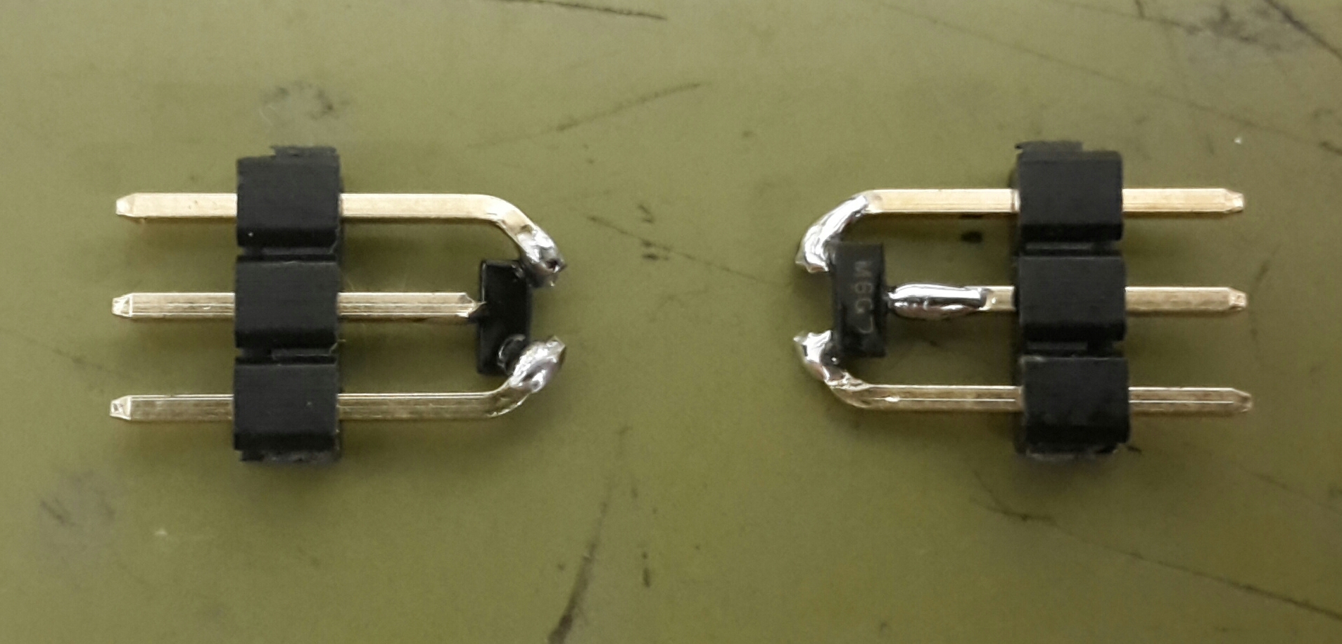

Did a quick test with three other JFETs. J112 with -3,8VGSoff, 8,5 gfs and >12mA IDSS is working fine, just like te SMD MMBF4393 with -2,2V, 8,5 gfs and >12mA. The fake J310 with -1,8V, 2,3 gfs and only 2mA IDSS didn't work.
I'll re-test the working ones with regard to THD performance, but that'll have to wait some days.
Here's a photo of how I prepared the SMDs for easy perfboard use.

Lasse,
That is a beautiful construction! Thank you for sharing the photos, and I'm sure we would all like to see more! 🙂 🙂 🙂
