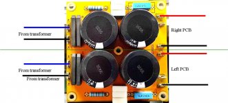

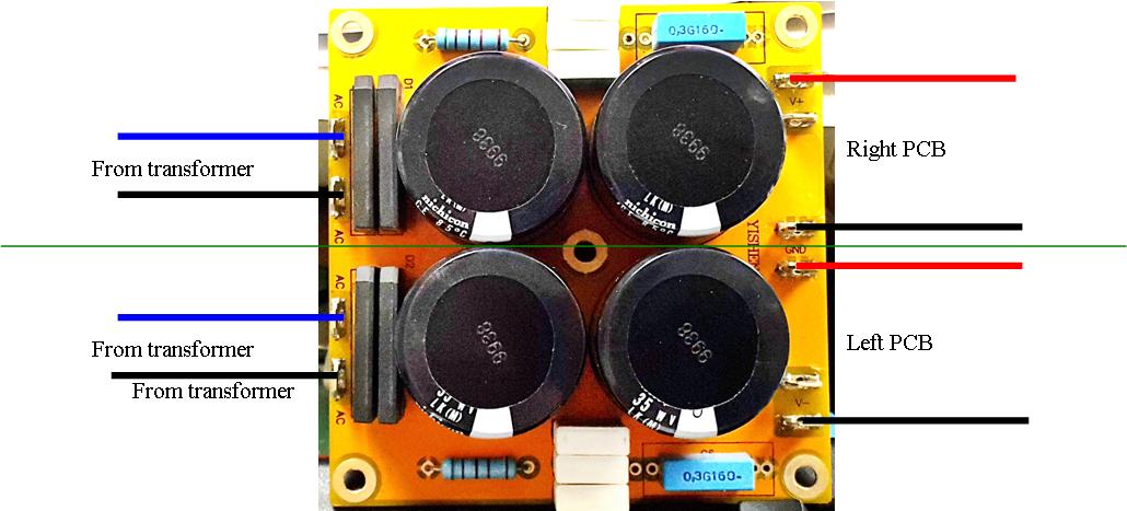

By the way, I got a new problem. Before that I am using a laptop psu, I have set it to 10v. After that I retest again (after a week) with the same laptop psu, the led is blinking, what does it means? I measure the power before plug in was 19.x volts and when I plug in to the boards, the reading is jumping up and down. It won't stable at 19.x volts.
I saw 2 wires joined together. Here what I do. I use meter to check the continunity test. Each blue wire only beep with 1 black wire. I think there's no shorting at all. Therefore, now can I use this for my power supply?
Zen Mod, what do you think? I guess this is easier for me to take every parts out from the pcb and reconnect it with wire.
you did what's shown on pictures - disconnected center tap connection , so now you have two independent windings ?
Yes but now new problem.
you would have to cut the ground plane on the top side along the green line and then I'd flip the lower bridges and big caps 180° to make one side a mirror.
I don't hv the pcb diagram. I bought this in ebay.
Any idea how?
considering that entire upper copper plane is GND , you can't easily isolate upper and lower rectifiers and caps
now - desolder everything from pcb , and connect as per tutorial I posted
or buy new PSU pcbs , each made for simple rail
whatever it is , it's easy peasy ........ problem is in plateau of knowledge
I can't help more , at least not before you decide what is next step
Okyou would have to cut the ground plane on the top side along the green line and then I'd flip the lower bridges and big caps 180° to make one side a mirror.
Ok. I will have a looked and double check it.considering that entire upper copper plane is GND , you can't easily isolate upper and lower rectifiers and caps
