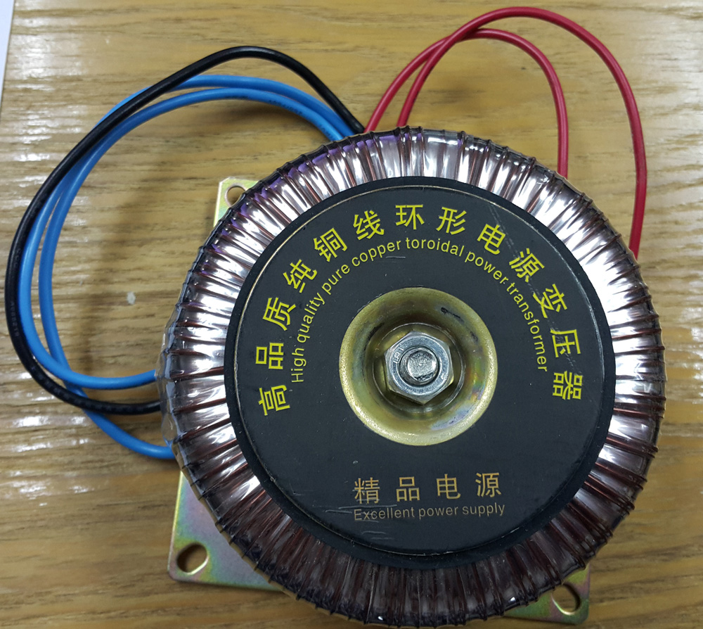

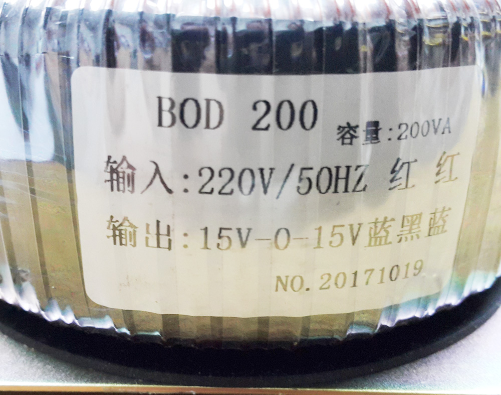

Only 3 wires.
Allow me to translate the specs.
It is a 200VA transformer. BOD200 is just the manufacturer model no.
Input: 220V/50Hz Red Red
Output: 15v-0-15v Blue Black Blue
The manufacturer quoted total output is 200VA. So 15v-0 single side is 100VA. 100/15v = 6.667A, rite?

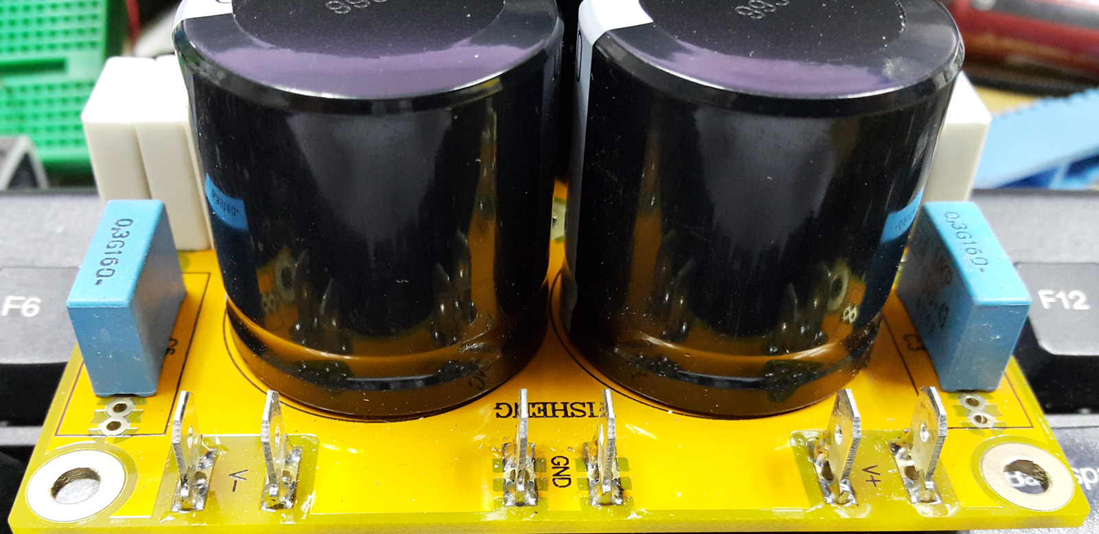

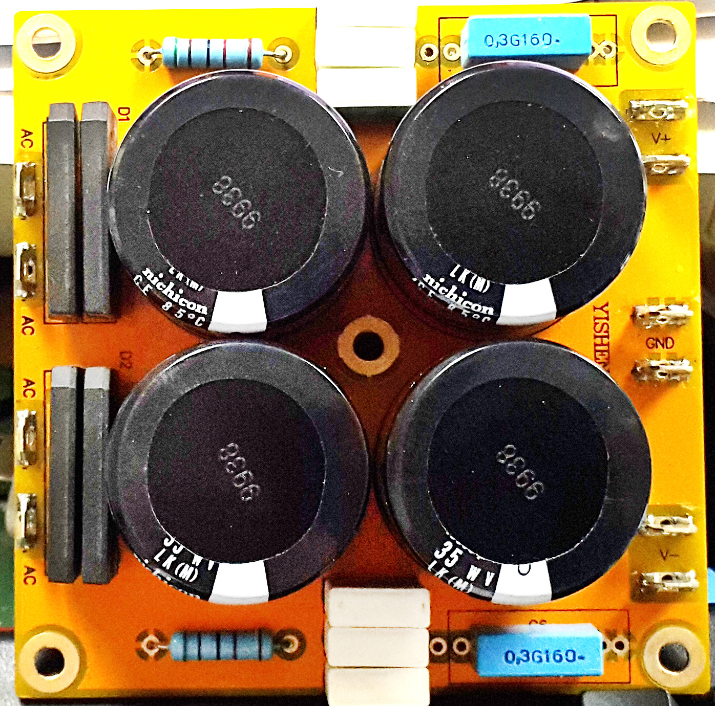

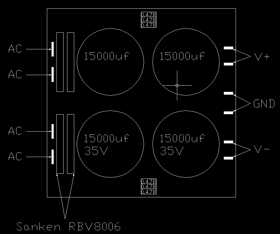

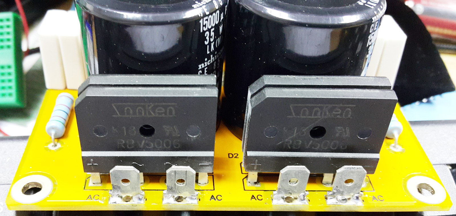

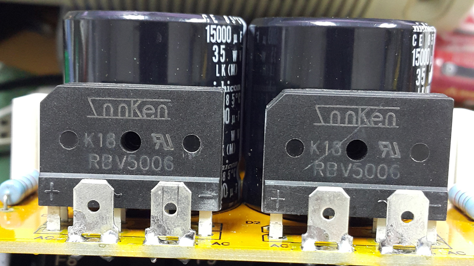

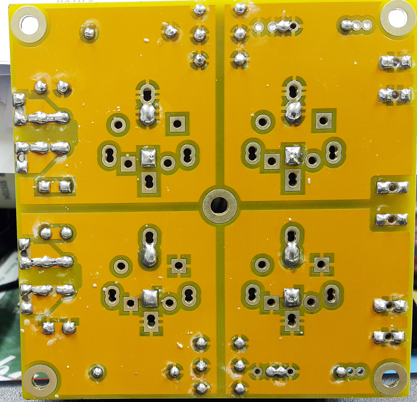

Please refer to the picture I have attached. Yes, 2 x 15v with sharing the ground. Not sure how to wire it to the power supply which require 4 wires inpt (also shown in the pictures).
On board rectifiers? Do you mean the RBV5006?
Sorry I am totally electronics nerd.
I have tried using the laptop power supply and everything is working now. Q1 be able to set at 10v. The thing is I only got 1 laptop power supply which did not be able to power 2 channel. The crazy thing is the laptop psu here is about 3 dollar higher than the center tapped transformer. This is the reason I prefer to use a real transformer.
Based on your pcb pic: simply connect 1 blue and 1 black wire from your transformer output to the 2 x AC connectors located on top left. Put some electrical tape on the end of the unused blue wire. By doing so you will get a DC voltage of about 20V across the Gnd and V+ connections on the right side of your pcb. The ACA does not require a negative voltage to work. Just connect both channels to the Gnd and V+ this way you’ll be able to use your transformer.
