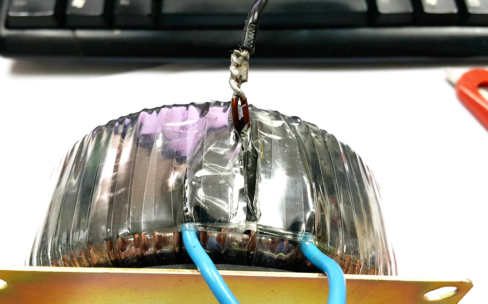

Ahhh ... too late again...
moppy,
are you shure your centertap is just one wire?
the CT transformers I've seen so far have two wires in one isolation hose and were just soldered at the tip. take a close look!
A.
A.
moppy,

from picture , center tap connection is buried under plastic tape and whatnot

OK will have a closer look. The transformer is in my office, will check it on Monday and post the picture too.moppy,

I saw 2 wires joined together. Here what I do. I use meter to check the continunity test. Each blue wire only beep with 1 black wire. I think there's no shorting at all. Therefore, now can I use this for my power supply?
Zen Mod, what do you think? I guess this is easier for me to take every parts out from the pcb and reconnect it with wire.
Hi moppy,
just what I've expected - now you have two secondarys 0-15V and can proceed as you intended.
