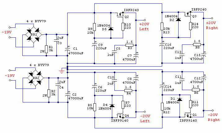

I'm thinking about building my first ACA in a single chassis as an integrated amp with a built-in power supply (i.e., no bricks). Yes, I was at BA2017 and am aware that the ACA boards are being revised and a slightly more powerful alternative will soon be offered by the store, but I may just build an ACA using the v1.1 pcbs. Assuming a 24 VDC power supply, how much power supply capacitance is recommended for the ACA v1.1?

Back in the 80's the rule was 2200uF/Ampere 😀
But nowadays I would use 1 or 2 x 22.000 caps. They are cheap.
I am in the process of building a Stereo ACA using a dual secondary transformer. Please be aware the ACA board ties the board ground to the mounting holes which could create a ground loop. I drilled out the holes slightly and added a plastic shoulder washer like the ones used on heatsinks for transistors. I plan on using a CL60 to tie ground to chassis.

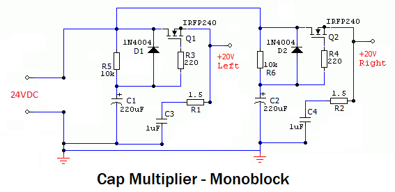

I'm about to start ordering parts for my first ACA V1.1 build and since it will be powered by an external server PSU (24V), I intend using a cap multiplier.
I have used part of a Juma Cap Multiplier schematic and I'm wondering whether the 47000uF and 4700uF caps should be used or not, since I don't need rectification.

(Pictured on the right is the original Juma Cap Multiplier, afaik).

The extra input capacitance of a 50 series MOSFET will cause an increase in distortion at high frequencies. I tried a 60 series MOSFET and you could see the distortion on a scope at 1KHz.
I would use bipolar transistor in the capacitance multiplier as the voltage drop will be about 4 volts. I used a capacitance multiplier in my F5 as the power transformer I had on hand was 20 volts instead of 18 volts and it worked out quite nicely.
1) IRFP240pbf is still certainly available.
2) If you go with bipolars best to assemble Darlington.
3) You don't need the 47000uF but keeping the 4700uF at the output would be ok.

4V drop is exactly what I'm hoping for, and I'll put the 4700uF back into my schematic.
