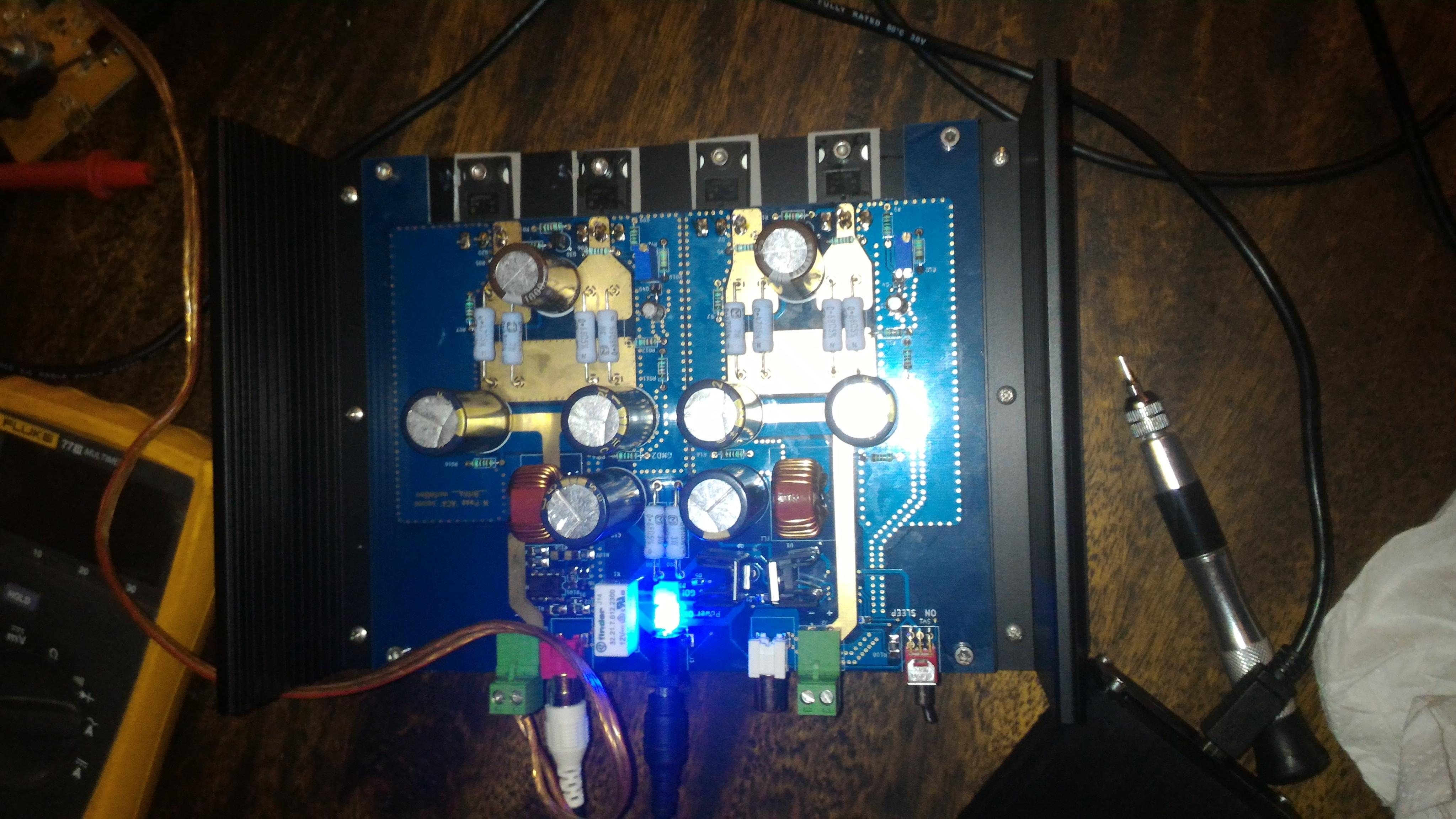

Here a picture of my ACA 1.1, I did the PCB with kicad and manufacture it to seeedstudio (5 pcb for 75$).
I made a mod to avoid OFF pop: I connect speaker directly between the power resistor on one side and the other side is AC coupled with two big caps between power rails. In a such way voltage rise and fall same potential at the two pole of speaker. And this serve also as a power tank for whole circuitry. I also add a common mode 1mH self and a big 3900µF tank for each channel.

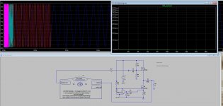

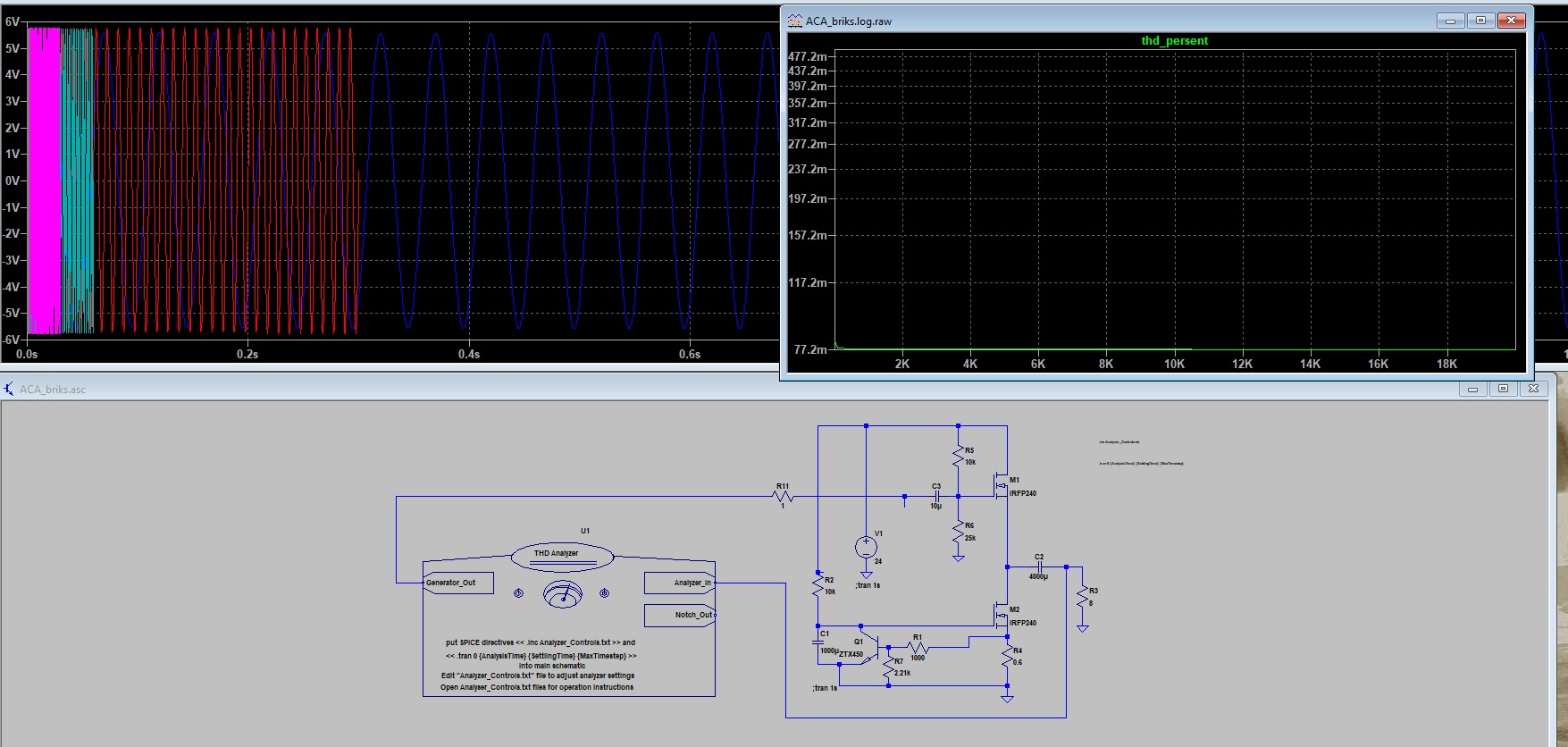

I also upload the ltspice shematic with THD run of the idea I would like to test, THD measurment seems to show good results from the unity voltage/current gain output stage.
