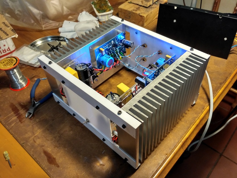

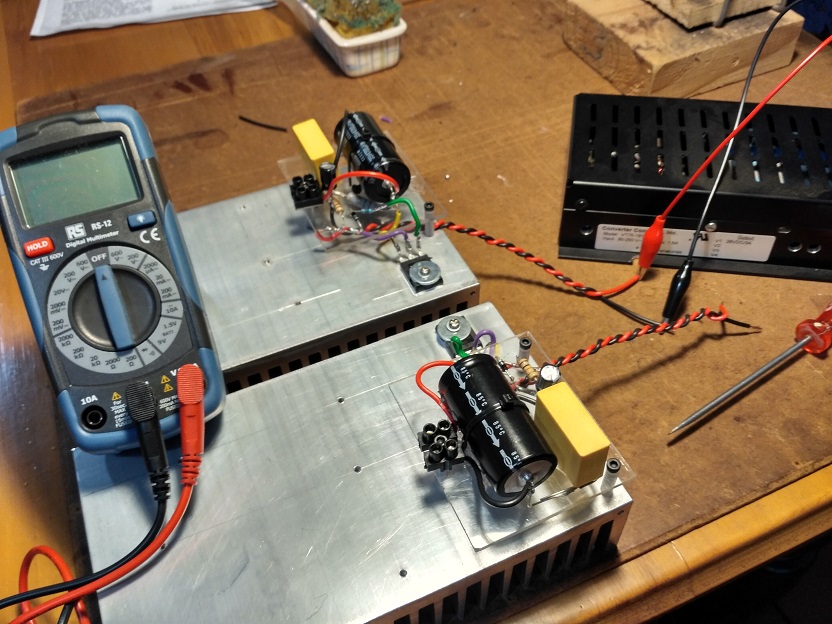

Finished my ACA build this past week. Did the final tweaks today and ran some tests tonight. Using a 28V 6A smps and Juma cap multipliers to supply 24V. Bias set to 12.5V. Did both the R15 and R12 mods. This amp sounds fantastic on the speakers tested.
Beefy heatsinks can handle the heat and the "enclosure" has enough breathing space. Here is my ACA - The Meccano version.

Looks fantastic! Nice job, very clean and nice enclosure work.
Do I see a plexiglass pcb ? What components are on it ?
Yes, I use plexiglass a lot. That is how I started off with diy 2 years ago - building simple circuits using plexiglass. It is a cheap medium. Basically point-to-point with a layout close to the schematic. I did my B1 this way. See here : B1 Buffer Preamp
The ones you see on the ACA, sharing the heatsink are Juma Easy Peasy Cap Multipliers.

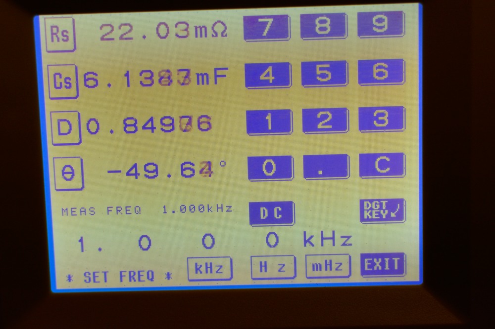

I have a LCR meter and all the electrolytic capacitors I have tested measure quite bad already at 1 kHz. The phase angle is not -90 degree anymore as it should be and at 10 kHz the phase angle has often showed someting like -60 degree caused by internal loss. But maybe I should just listen and not be so worried 🙂

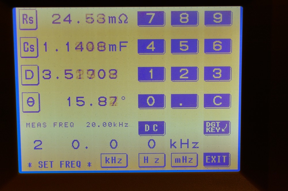

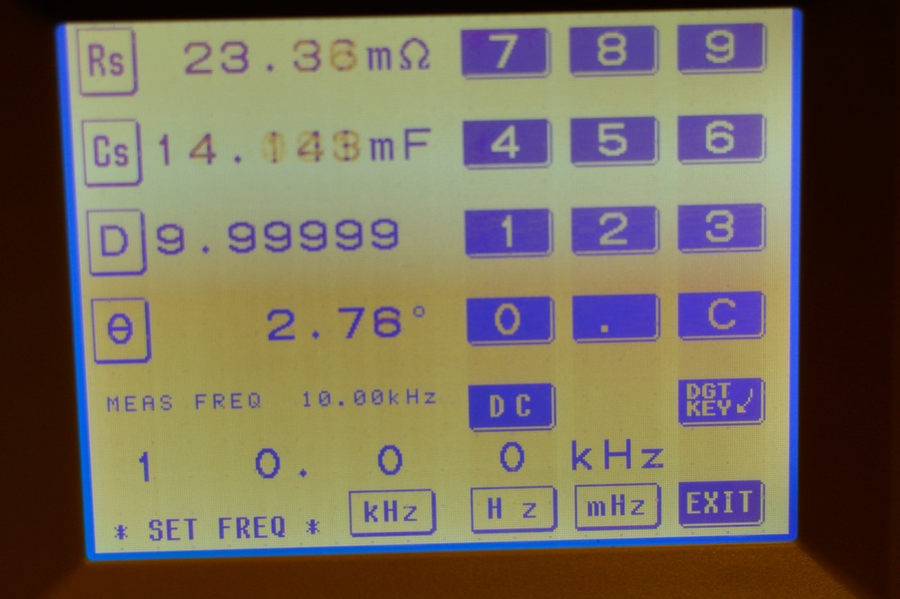

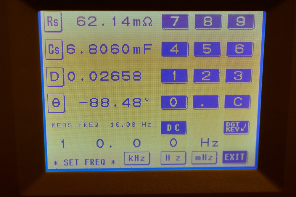

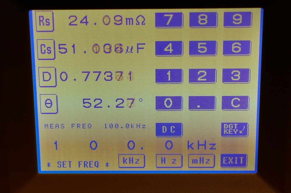

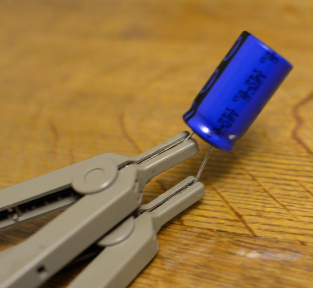

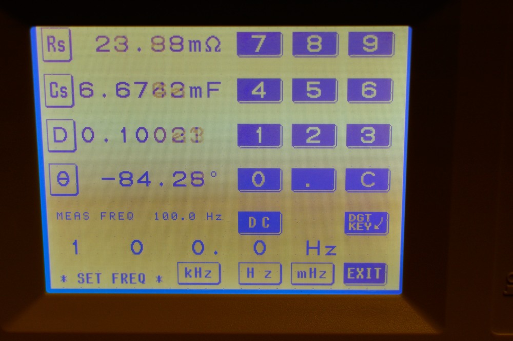

To demonstrate why I worrie about using electrolytic caps as coupling caps I found a good quality 6.8 mF / 16V cap. I made measurements using a professional LCR bridge. Parameters measured was Rs, Cs, D and Phase angle. On an ideal cap phase angle should be -90 degree, Rs = 0 and D = 0 at every frequency. I measued at 10, 100, 1k, 10k, 20k and 100k. Pictures attached of screen showing the values. At 10 and 100 Hz everything look Ok but already at 1 kHz things starts to get not so good and at 10k and 20k it gets very bad. Pure film caps measure much better. That said I have not measued a 6.8 mF film cap. But looking at the results I think you would worrie a bit also?
