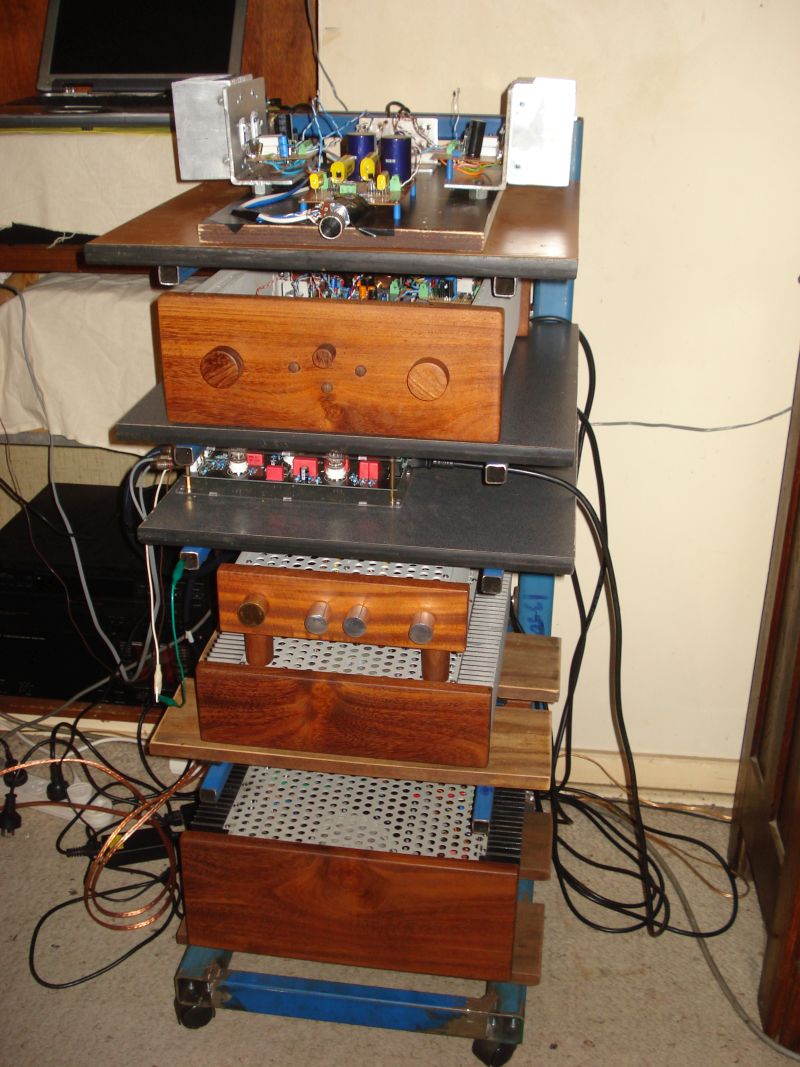

At the moment basic answer is, A lot, it sounds good.
I find the latest build (of anything) is going to be used more. There are different rooms, speakers and other stuff to test.
With summer in its last days here the Aleph amps are coming back into use. In a basicly non air conditioned house once the indoor ambient temp hits 30C I don`t use room heating Aleph`s that much. Solid state makes more sense to me.
Ok, in head to head testing the last couple of days between the J, Mini, ACA and some solid state amps the winner is .............
Hold on a minute, when I had that combo running I was in a bad mood because my PC just crapped itself, then with that other setup things were good because I had fixed it. Then when the smoke escaped from that resistor aaaarrrrrr.....
I will just have to go back and do it all again.
Best you build it and have a listen.
Tony
from the 1/2 dun shed.(now were is that hammer, I need to make a technical adjustment)

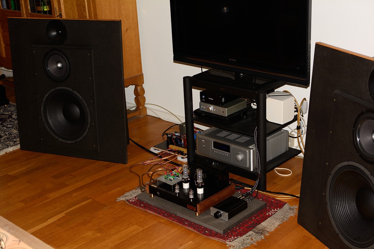

I have 94 dB OB speakers.
The OB's may work well, but they're 3-way, not Full Fange. Test and hear.. And please let us know! 😀
It's an additional 2.21K resistor between the emitter and base of the ZXT450. Said to raise the output to 6W. It's mentioned a few times in this thread, but I couldn't find it with a search just now.What is the R15 mod?
There is also an R12 mod, but I haven't done it on my ACA's (yet).
The impedance is also important when suing low watt amps. My OB's are 6 ohm and it never drops below 4 ohm. It works very well using the 8 ohm tap on the 300B. I also have two SE KT150 mono blocks coupled in triode mode and they are rated 23 Watt. They also sounds very good. But I may prefere the 300B after the PSU's was modified (< 1 mV ripple and Coleman regulators). Probably the 1. watt is better on the 300B compared to the KT150. So an ACA should do it......5 W should be ok.

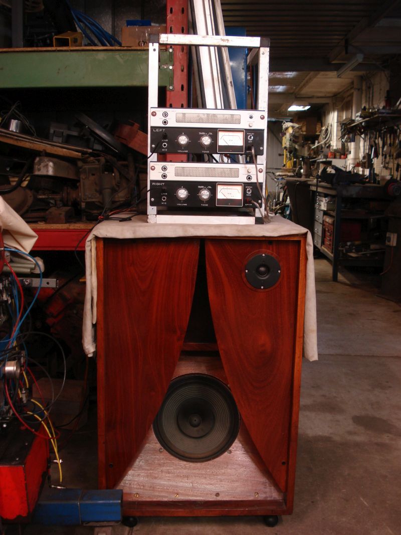

To me the ACA did sound its best on 93db speakers. These are two way floor stander that use 2 x 5" and 1" tweeter and are ported.
I took the ACA to the shed and tried it on some DIY Karlsons I bought for the timber (see previous pics of Aleph`s).
Shocking. Nothing makes these sound good. This could be the drivers or the modifications made in the box build. One day I will look at these some more though they are to big for the house they would make a great shed system.
Build it and see (hear) what happens.
Tony
