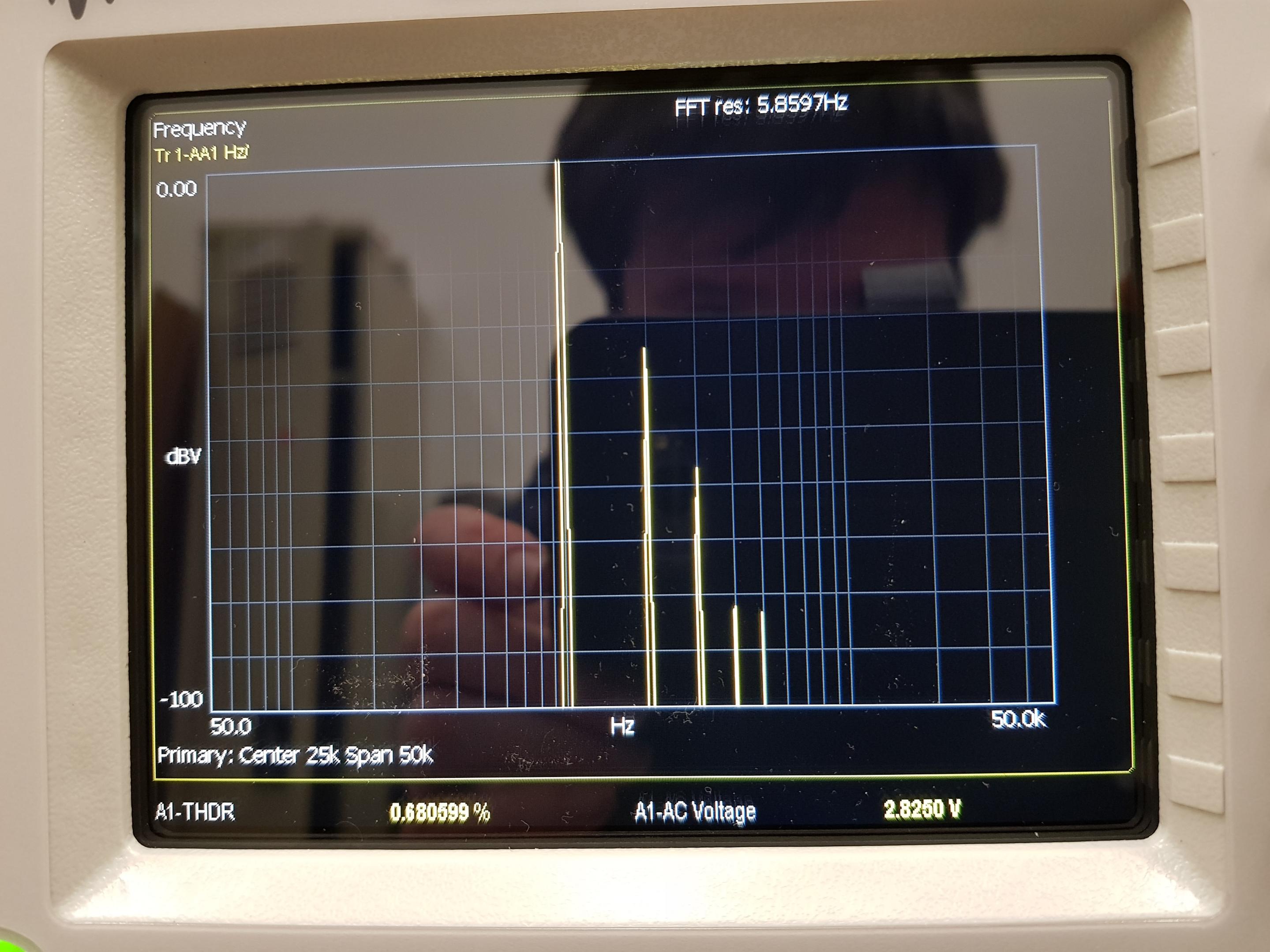

Anything between 11.4 and 12V across Q1 seems good. Outside of that you start seeing higher order harmonics being introduced.
Here it is at 11.6V Vds across Q1

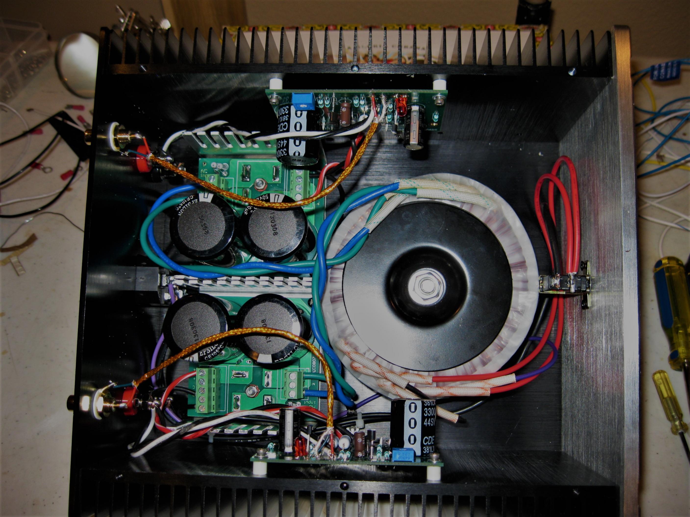

Good deal. Thanks for checking this. I have them set at 11.92. Seems to like it there. Runs cool for class a. I can hold my hand on the heatsinks after a hour warm up. I'm also glad I went with the linear supply. These sound better than the first set I built with the switching supply.

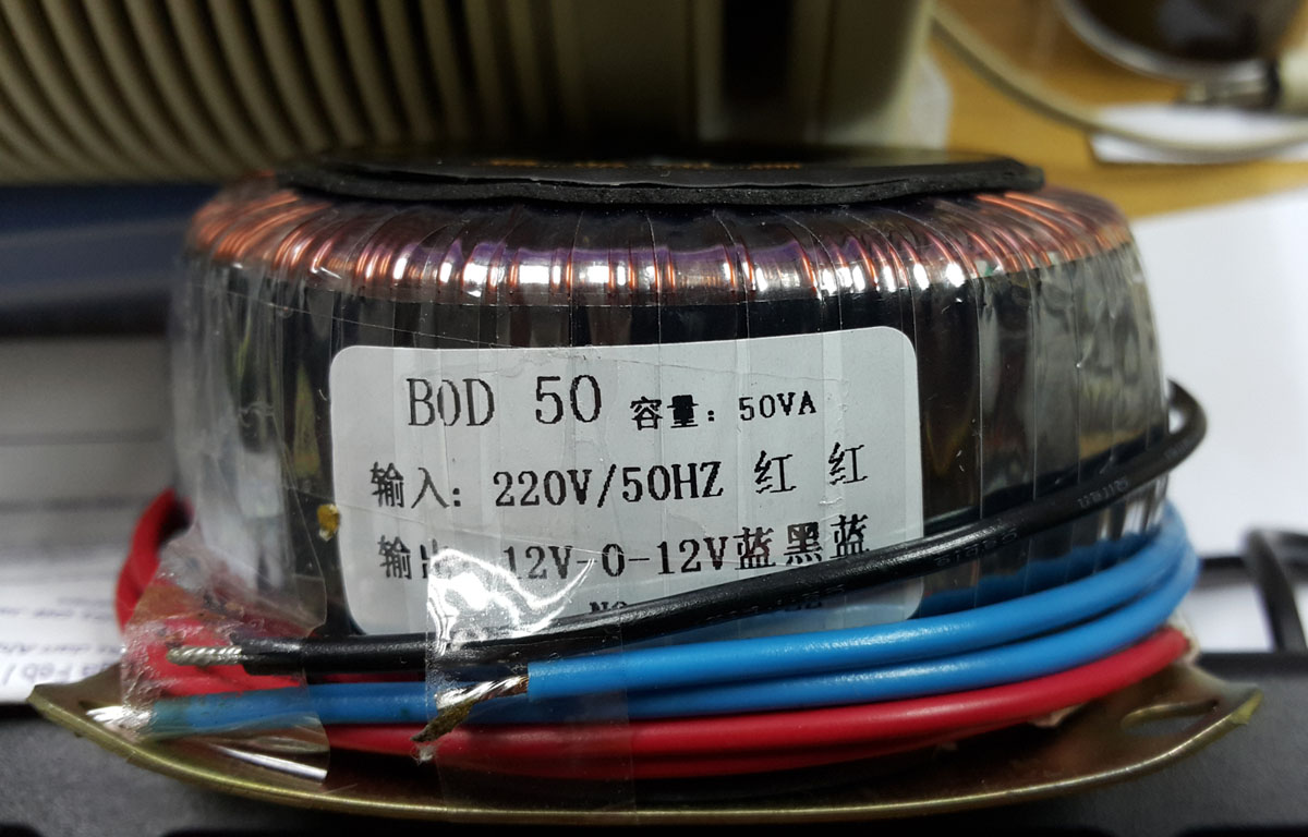

As I remember, a rule of thumb is to take a transformer rated at least twice the needed power. My 19V ACA dissipated 25 W per side. My high power 24V ACA dissipates 35W per side.My friend gave me his unwanted transformer rated at 12v-0-12v 50VA.
Can I use this underrated transformer for this ACA?
So your tranformer might be good for a single side 16V ACA. 16V might be not enough for good sound.

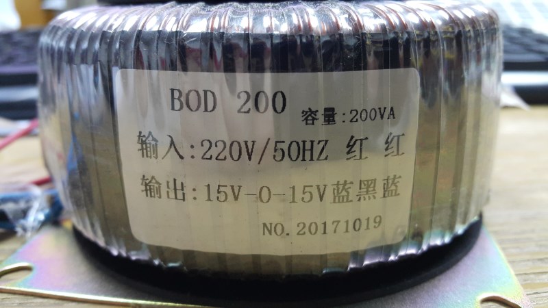

My stereo 24V ACA relys on a 250W, 2x18V trafo (which I had unused laying around) and I would not go below 150 W.
