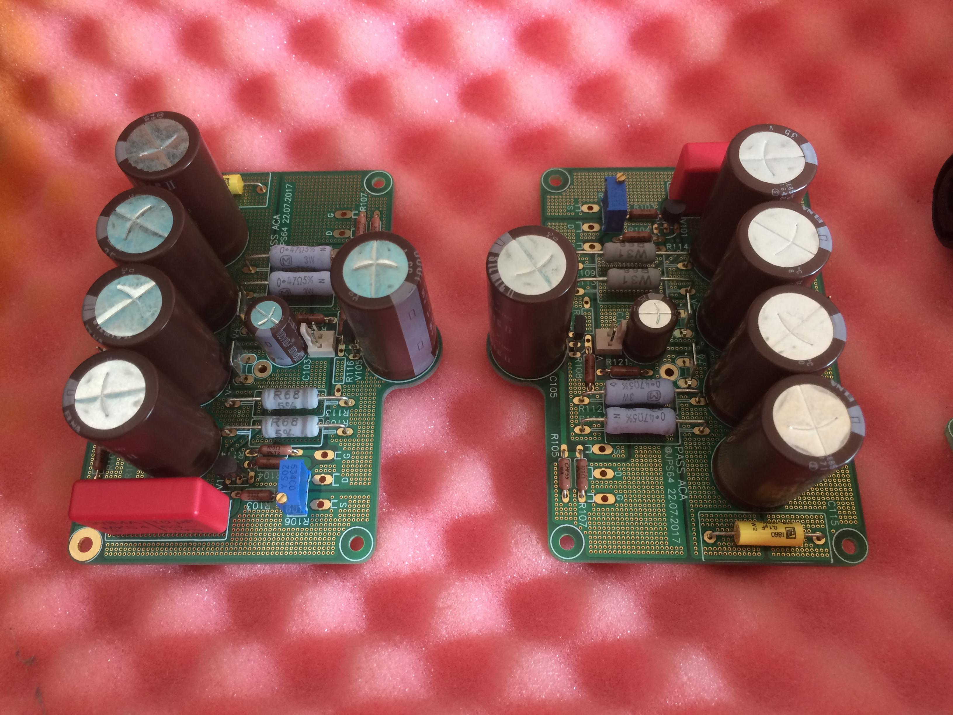

Papa won me on ACA already. in a multiamped system that little amp is absolutely the best value. He made a reference to a tube-like sound quality of ACA2 in another thread and posted the basic specs. the gain is low (~11dB only) but I am half set to try it out if it will operate off of 24V PS (I already have one ACA sharing PS with F5). wait and see what the master says 😉.
p.s. I have a feeling that that little amp is a similar experience like LXMini speakers were for Linkwitz; kind of a small scale side effort and then it beats all expectations and one gets to learn something from it.

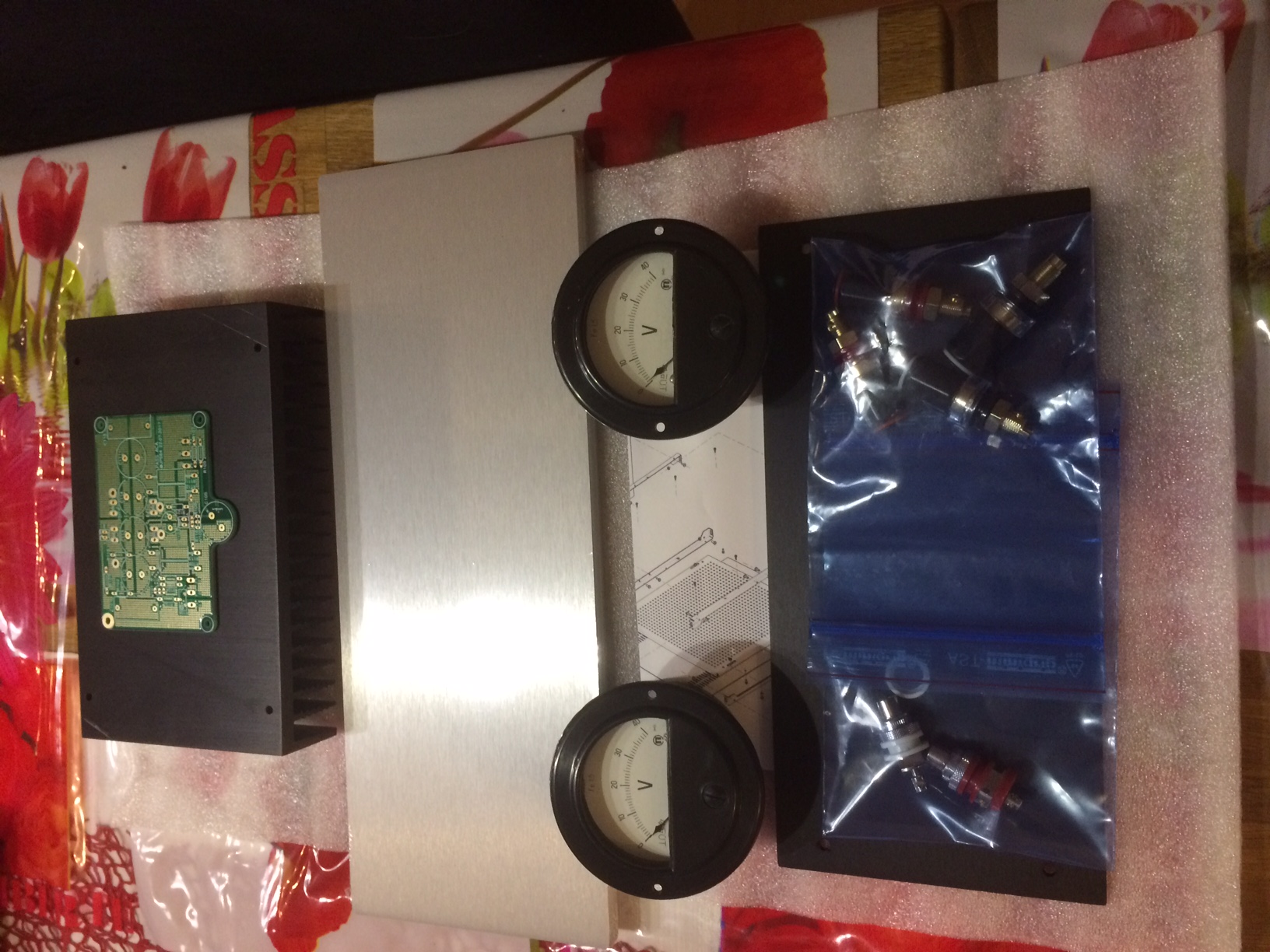

Starting packaging...
JP
