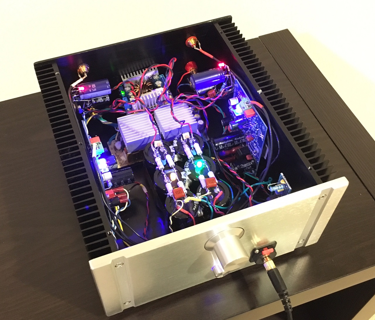

Here is a photo of the Silicon Harmony amp that I took to the HeadFi organized SchiitStorm meet in Gaithersburg MD. It uses the above DC step up followed by two Juma Easy Peasy cap Mx's (IRFP240 with 470uF and 4700uF Pan FC output cap). This feeds a CRCRC (22mF & 0.47R), then that goes to the amp. Measurements show stereo separation as limited by measurement DAC (-88dB). They act like true monoblocks for all intents and purposes as the Cap Mx is like a one way valve.
