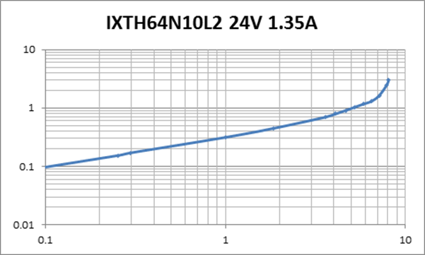

Just for the purpose of testing I used a crappy chinese 30V switching supply adjusted down to 26.6V.
You can see increasing the power supply voltage reduces the higher order harmonics.
The harmonic seen around 40kHz is purely due to the switch mode supply.

Top and bottom of one channel.

I pulled out a decent lab supply and set it at 24V
THD is roughly the same but higher order harmonics have been reduced compared with 19V supply as previously observed with the 26.6V supply.
Vds across Q1 was set at 12.5 V
Bias is around 1.35A with Papa mod.
I'll probably settle on a Bias current around 1.15A, and see what temperature the heatsinks get to.
