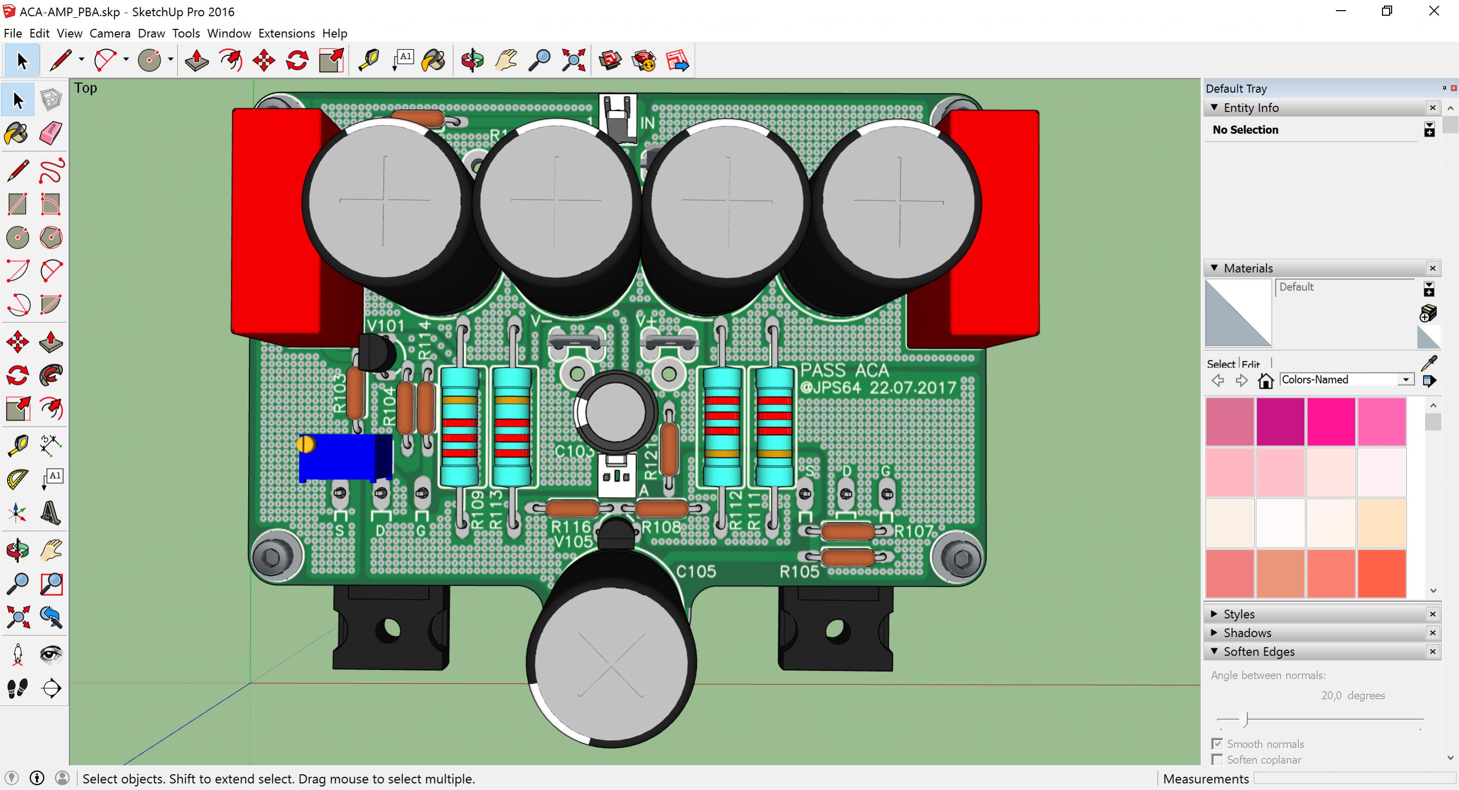

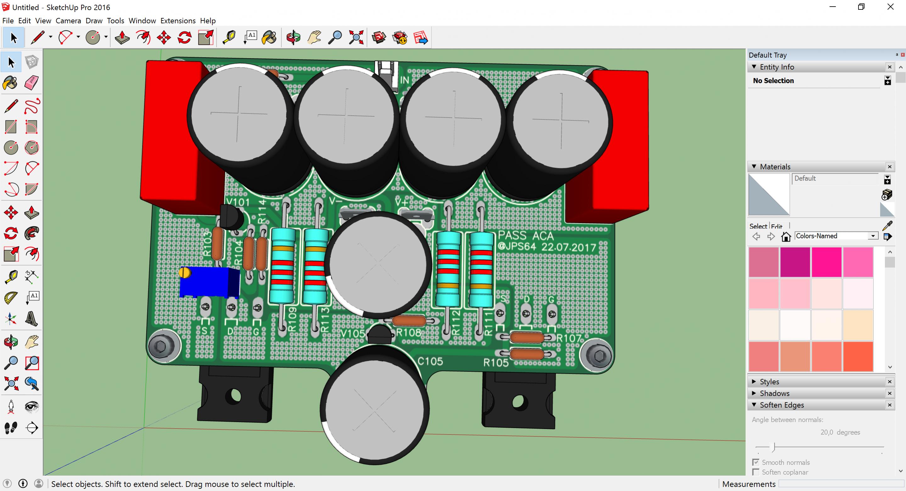

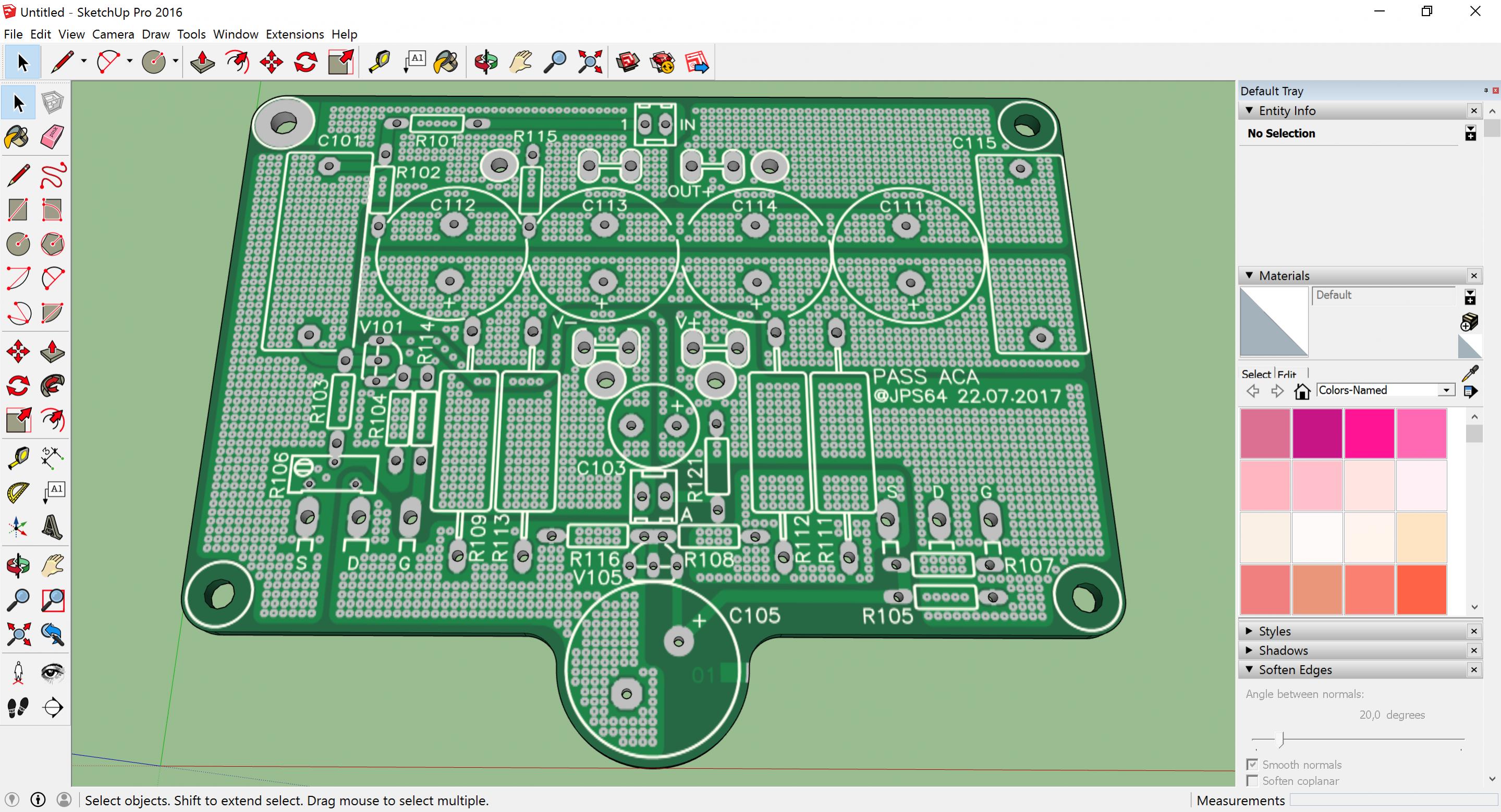

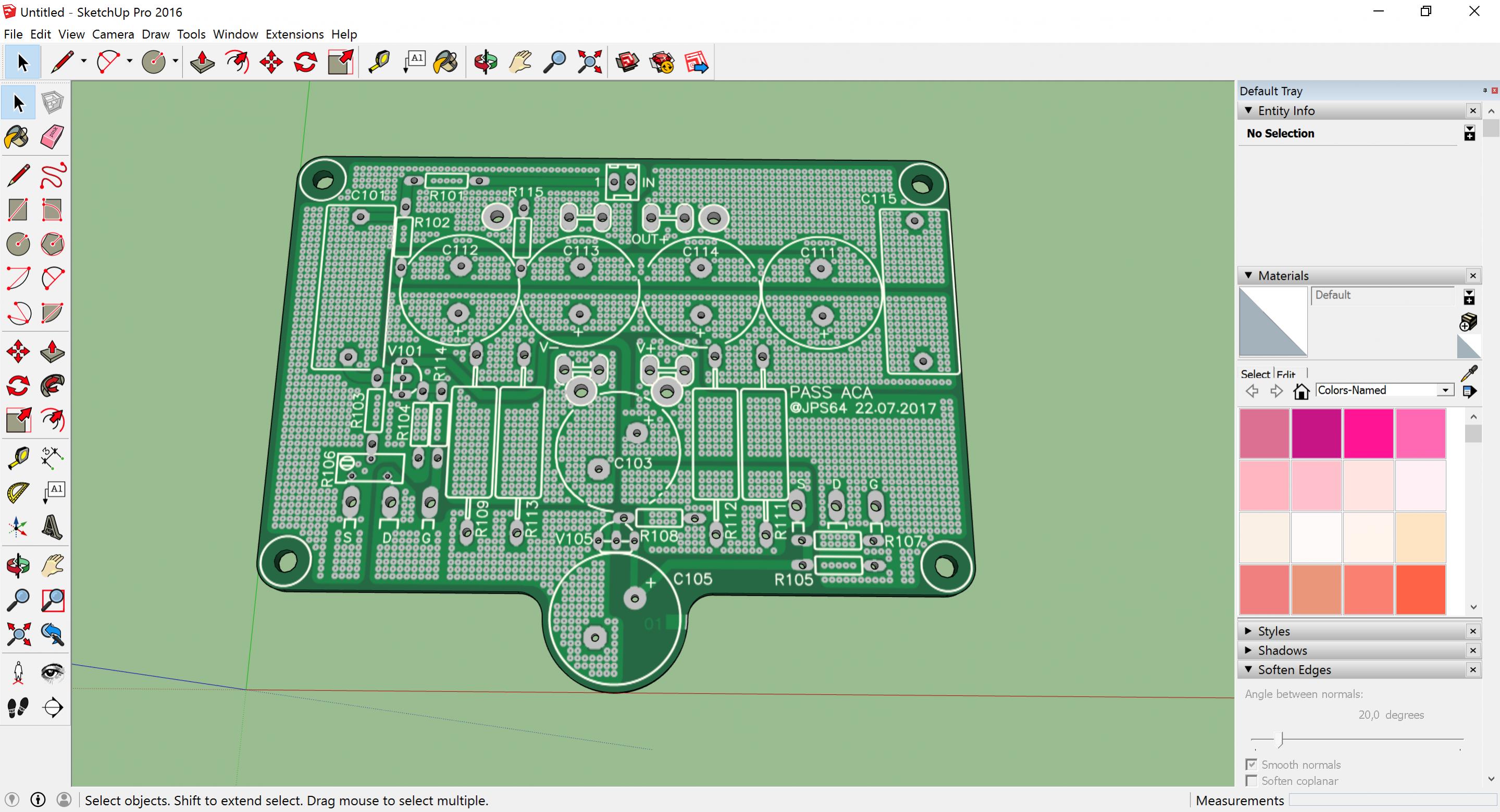

First, schematics, PBA top and drill document...

You need to add the option for running a 1/2W resistor from the base ztx450 to it's emitter. Not shown on the original schematic but should be there.
C103 of 1000u might cause instability on some switch mode power supplies. To be safe I probably wouldn't exceed 100uF, Nelson used 10uF here.
Good to see Elna Silmics used.
