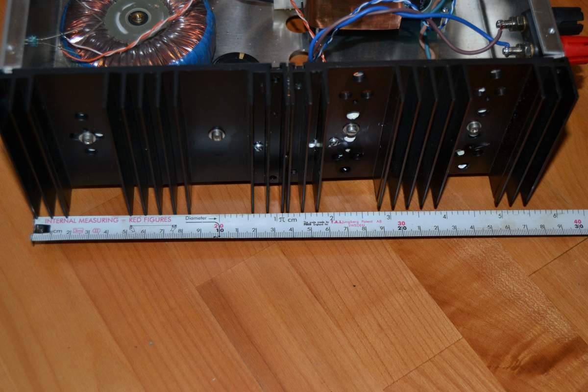

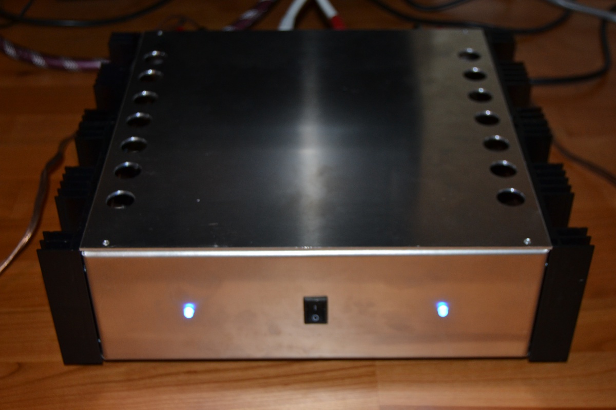

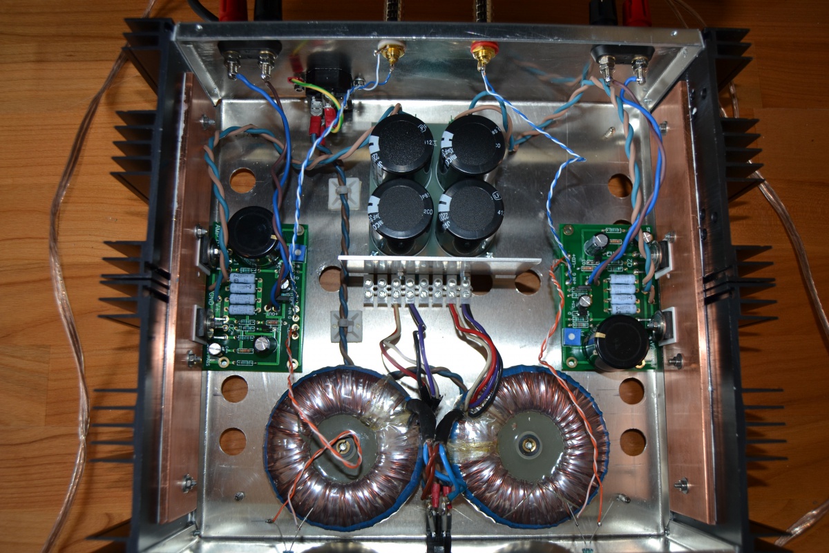

I run mine on two transformers rated at 2x15V / 2,5 A.
The two outputs are run in parallel and give me just under 21V to the ACA, power is just enough I think, the transformers are just a little warmer than the air inside the cabinet.
Heatsinks are four scavenged pieces giving a total of 100x270x25mm. per side, but with few fins.
It runs at just over 50C in normal ambient temperature around 20C.
I can hold my hand on the heatsinks for several seconds without too much discomfort.
