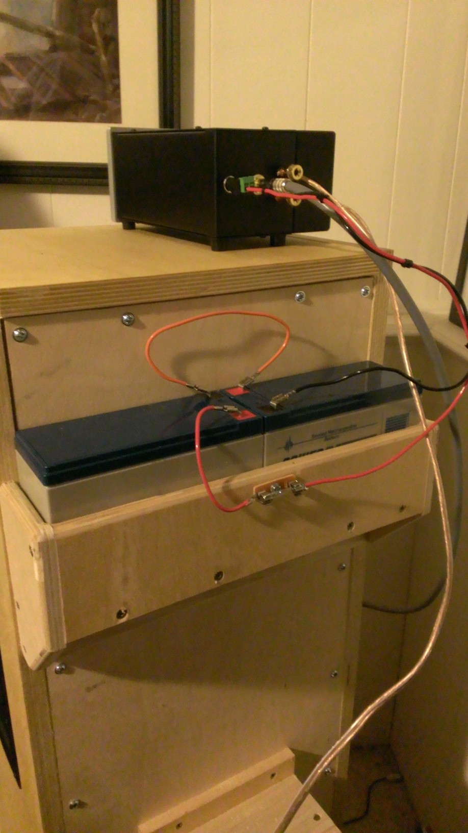

I wired up a couple of 12V batteries (in series for 24V) to my ACA’s for fun. Does it sound better, I’m not sure, nothing super obvious, but haven’t given it a critical listen yet.
After an hour of playing the temp was ~125 degrees F, which isn’t too bad from my understanding. Reading through the thread, it seems most like a higher bias on these ACA’s, and a bias of 12.5-13 was recommended for 24V supply.

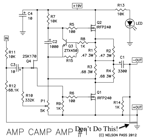

This sounds like the ground on the USB is pulling the floating signal ground on the amp input. Kind of a ground loop issue.

1) Is a ground wire between the amp chassis and the PSU chassis necessary or desirable?

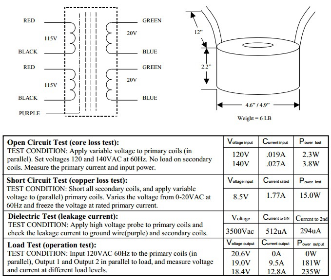

4) The Antek transformer has two primaries (see linked image). Do I just connect these to the IEC module in parallel? (the module includes IEC, switch, fuses, and EMI filter).

Anyway, I started looking into transformers for the PSU. I built a simple unregulated CRC (4 X 3,300uf caps, 3 X 0.47R resistors), hooked it up to my Variac, and determined that 20 volts from the Variac will produce the desired 32 volts after rectification and filtering. This 20V, 200VA transformer from Antek seems to fit the bill, and is reasonably priced. Since it has two secondaries, I figured I would make the amp dual mono rather than stereo.
This means my PSU umbilical will have four wires for the amp (+ & -, X 2), plus two for the fans.
All chassis (metal boxes with electricity in them) should have safety earth, (not audio ground)
might not be critical for the amp at 32v but why not?
A good place for audio ground is a star ground at or near the smoothing caps, many examples in this forum.
but with two boxes you might want to put the star in the amp section and a nice large wire to the power supply.
YES

for me the Antek put out more voltage that the spec's say 1-2v on my power here at 117-120v
but yes 20v should be good

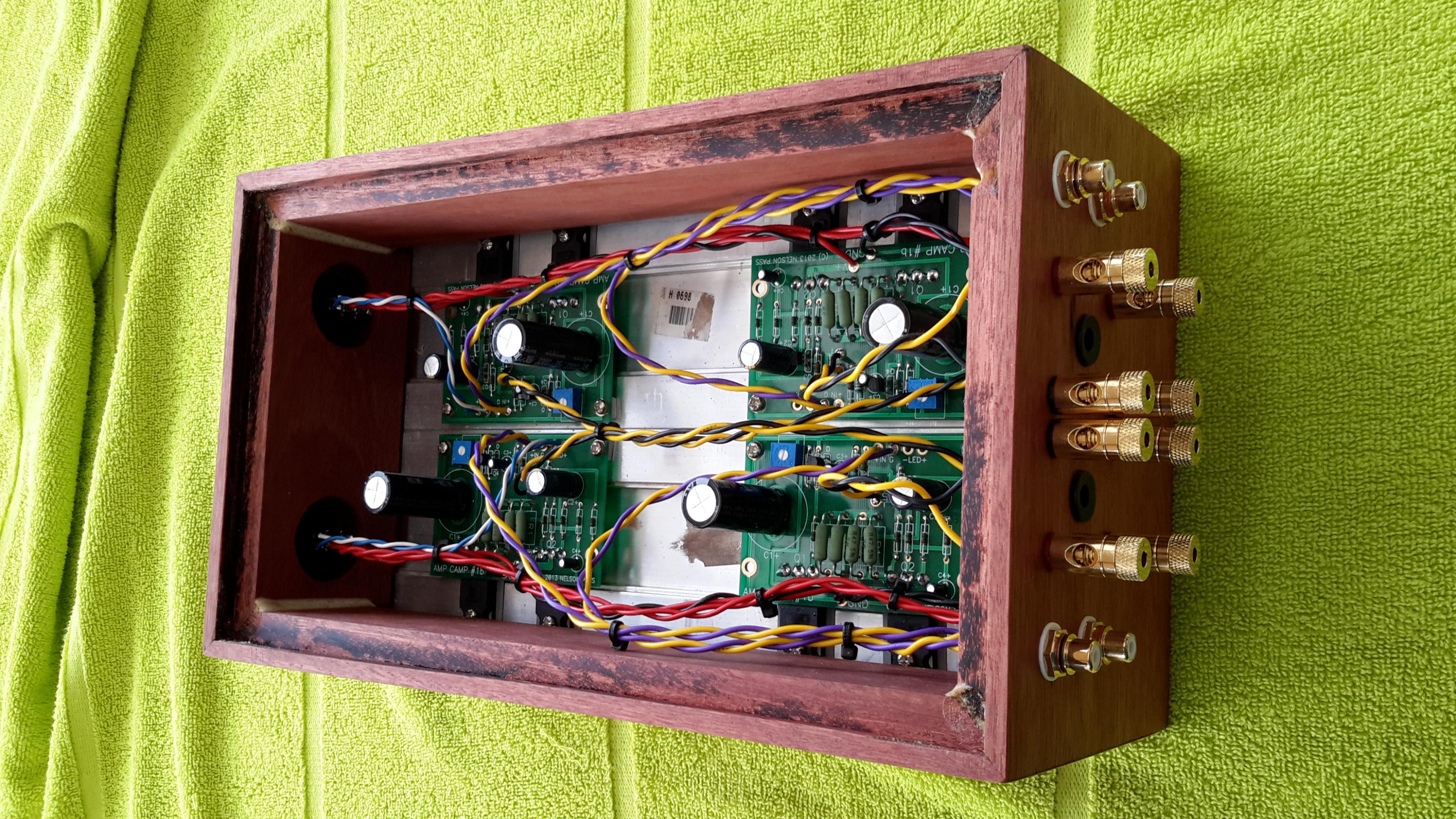

what i played with today, its been a few years and thought I would try some of the mods.....

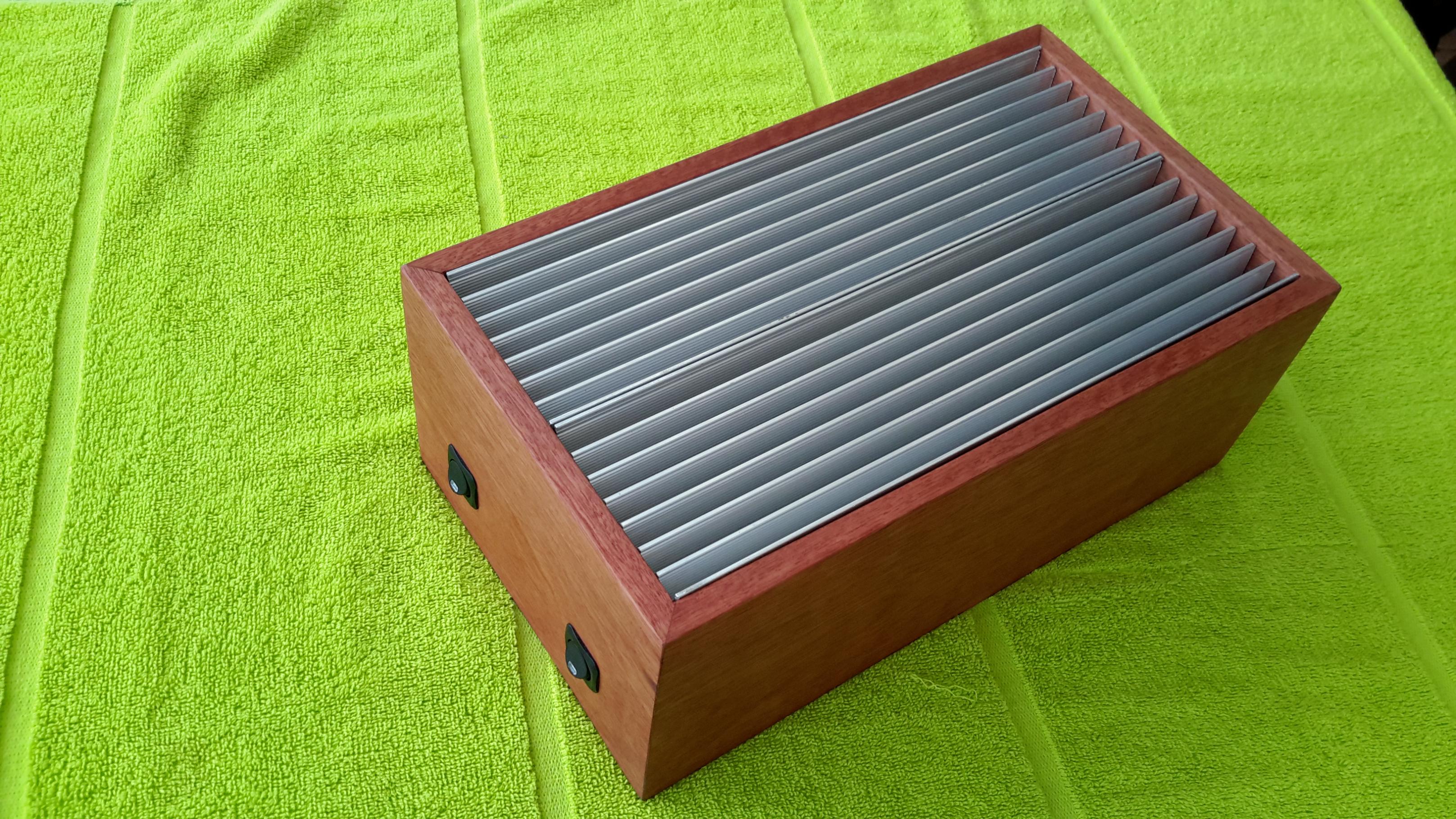

You don't need much fan to cool this - I used a tiny (40mm) one and the temp of the heatsink was barely warm. A simple 7812 regulator fed by the main PSU DC is fine as long as it is <35v. Put 7812 on same heatsink to draw off the excess heat from dropping the voltage. This way a simple single 32v smps can be used and don't have to mess with transformers, rectifiers and cap banks.
Good point, I'm powering the fan using a controller schematic found here, a N-MOS two caps and trim pot + thermistor
connected to same supply.
used 80mm because I have many, it is barely turning and quiet. with the 2.2k R15 so 1.4A per side and barely warm.
My 4 fans are perhaps a bit overkill... but they'll be running at a nice, lazy pace.
But where's the fun in that? 😀
Besides, I've already cut the traces so I'm committed to

Hi all
Just finished my 4 channel ACA to power my active horns and I've got a couple of questions.
First there is a bit of a buzz from the speakers when they're first turned on, as my horns are going to be active i hope this buzz energy hasn't got to much power to damage my mid and tweeter drivers. Also a small pop on switch off. Concern?
Secondly was the heat sink temp, after about 1/2 hr on idle the heat sink temp got to a bit over 50 deg C. Is this too hot?
Other than these questions this would have been the easiest aml project I've ever done, no power supply makes it easy!
noise at turn on normal, use delay if needed. Ebay or make one. or just manual switch.Hi all
Pop at off, normal can try adding a cap to the power rail, 10,000uf or so, may cause SMPS to be mad.
orientation of sink not optimal, (up). might be OK looks close to too hot. sinks look small for 4 channel.
