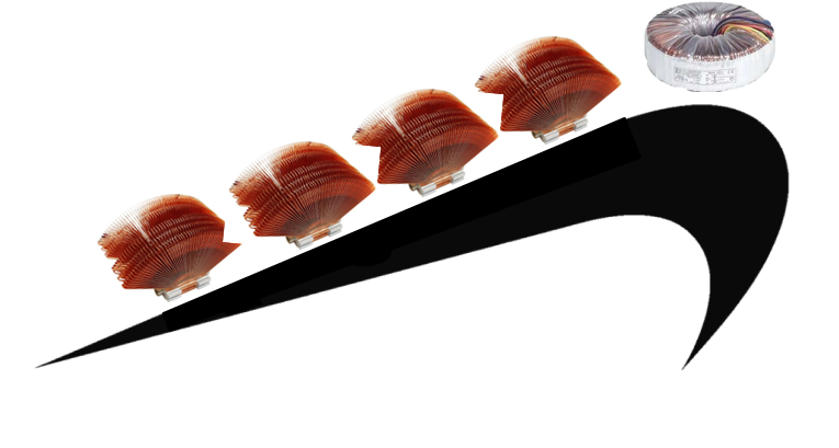

Hi All, I desided go build the ampcamp amp. I have a couple questions though. I read a post here that said he 'didn't have any speakers this amp sounded good with'. Is this amp particular about what speakers it mates with??? I saw the BOM and kits and such and for the price it seems like a good deal. In this case does the sound quality equate to the low price?? Also, I am making the chassis a metal sculpture and need to run the Little Black Thingies (LBT) wires away from the boards to the were the cooling flower fans will be located. Is that doable??
Here is a very rough pic of what I am thinking. I like the copper flower coolers from an artistic POV. The chassis is an inverted Nike swoosh and will be as wide as needed and maybe 6 to 8 inches deep. Made from steel plate and either left to rust or a blacking patina.
The PTX will be wrapped in a copper, brass, or bronze spaceship looking affair.
