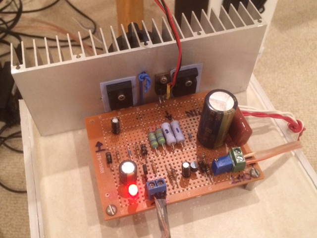

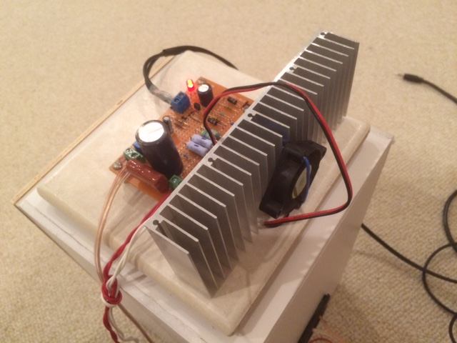

As a quick and dirty test, no messing with water, an old 40mm 12v fan from a CPU cooler strapped to the heatsink works very well. Heatsink is now barely warm, and was too hot to touch more than 5 seconds before. I will probably skip the water cooling as it's too messy. I am using a 7812 regulator (bolted to heatsink) to provide the 12v for the fan. Forced convection is way more efficient than natural convection.
Here is the fan:
Here is detail of 7812:

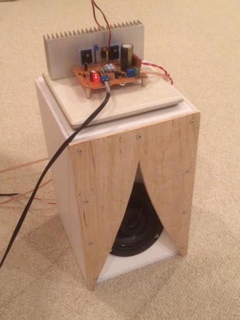

Here it is powering my XKi fitted with a PA130-8 coax (custom):
This speaker works very well with ACA as it is 90dB sensitive full range that I have added a tweeter and 1st order crossover. The PA130, now called the "Daytonator" has also had some surgery (5 radial cuts and re-glued a la Revelator).

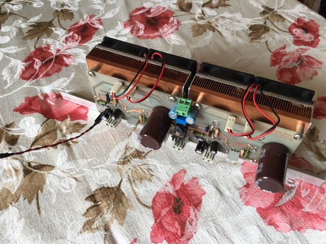

I think I am going to use these little copper beauties for my ACA next:
55mm 2 PIN Aluminum Snowhite Cooling Fan Heatsink Cooler fit for PC Computer CPU VGA Video Card VC899 P-in Fans & Cooling from Computer & Office on Aliexpress.com | Alibaba Group
This is an old fan from a circa 1996 Pentium 1 cpu so it's had a rough life and bad bearing so it is a bit noisy. Similar fans for this type of heatsink specifies 25dB noise so should be pretty quiet. The specs actually say "copper". But anodized aluminum works well too. Wondering if there is enough room to squeeze two MOSFETs onto one of these or should ea get their own?
Heatsink Material:Copper
The product title says aluminum, and the pics look like gold anodized aluminum to me, but I could be wrong. I'm guessing there'd be enough room for two devices per sink, but probably not enough cooling capacity. You'll have to figure out a way to get good thermal coupling, as the base doesn't look very thick, and while you might be able to tap it for a mounting screw, you might not be able to torque it down very tight. At a couple of bucks a pop, though, there's little risk in experimenting.
If you have an electronics surplus shop near you, you might want to check there for cpu coolers and other sinks. My local surplus shop has a bunch of them both new and salvaged, that are much more robust than that Alibaba one. I got my copper sinks w/fans there: ACA Concept II. They also have the exact same heat sink in aluminum.

Yes, those fans certainly look like they would be very quiet. I have already ordered these and at $3 I can't complain about longevity. Will try them first and see how they work. Will require a simple drill and tap on flat of heatsink to attach the mosfets.
