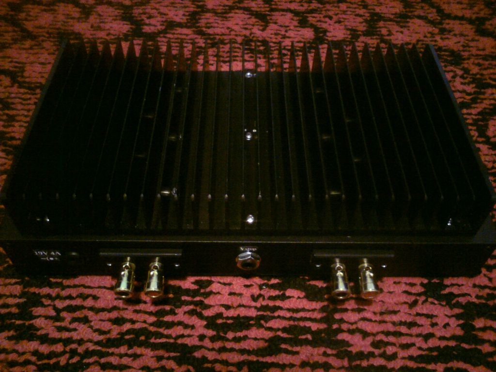

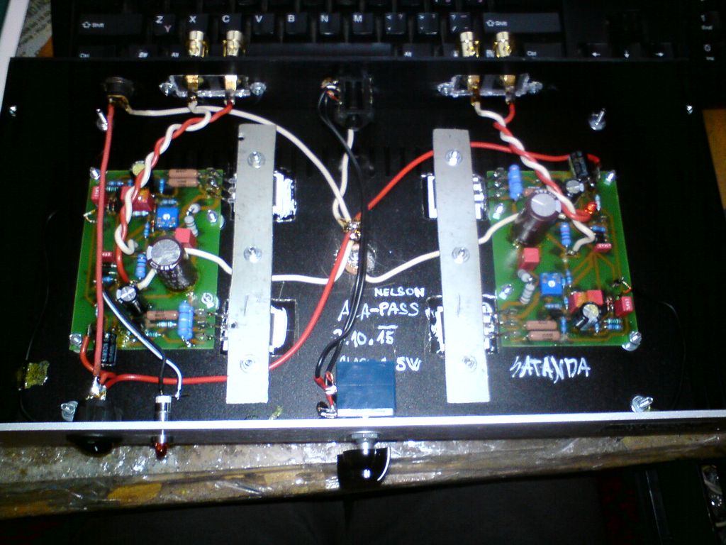

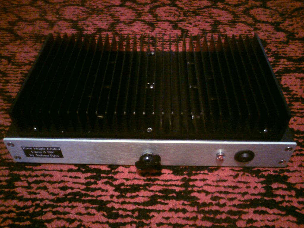

this is my ACA with 1.6A bias current. I have made my own PCB, which has B1 buffer implemented. Amplifier is meant to be for PC. I am using old Tesla ARS 8104.54 4Ohm 15W, 88dB speakers. It sounds great. With ambient temperature 22 Celsius, heatsink is 45 Celsius. Heatsink could be little bigger, but it is OK. With 24V power supply (compared to 19V) it sounds even better, but heatsink gets too hot.
Thank you Nelson Pass!

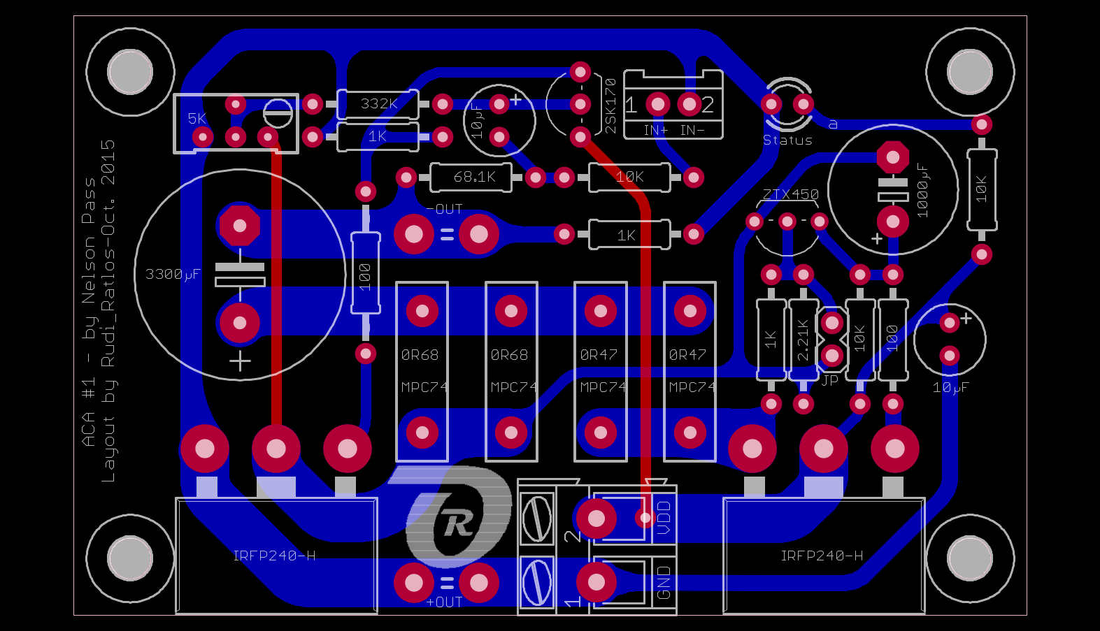

Gentlemen, from time to time my best DIY-friend and I like fooling around with DIY!
This time, this winter, we want to implement an "Active Speaker Concept".
"Active" means: my friend owns a DSP (having crossovers, attenuation, ...) and likes to connect it to his 3-way speaker.
I will of course support him and will give him fully assembled ACA#1 - PCBs (my layout - image1) ) for his tweeters and his mid-tone chassis (is this the correct translation?).
For the bass we like and use ClassD-amplifiers like the L25D (image 2).
The ACA#1s and the ClassD will be built in separate cases, shielded from one another by a Mu-Metall layer.
Are we on the right way or do you instantly say: " ... no way to go ...".
Best regards - Rudi_Ratlos
