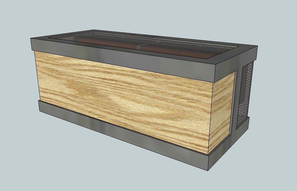

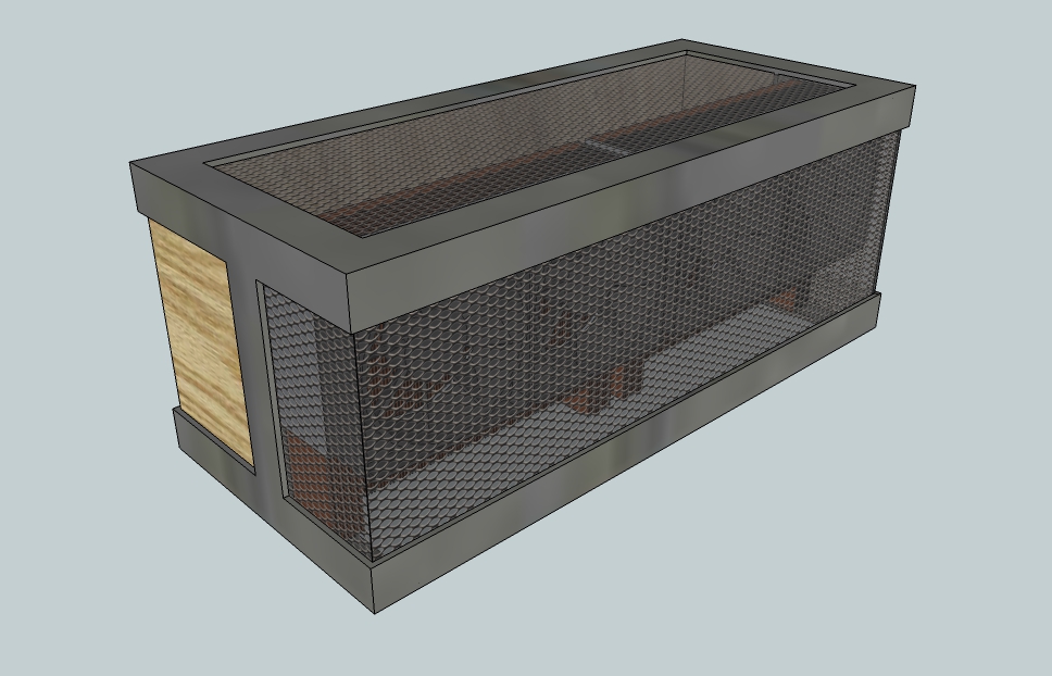

OK, since I got Zen Mod's blessing 🙂, I went ahead and Sketchup'd a chassis design. Welded steel, steel mesh, wood. Will be another long-term project due to Maslow's hierarchy of needs, but with any luck it'll be done for BAF16. Then, maybe speakers by BAF17. I'll start a build thread when work commences...
