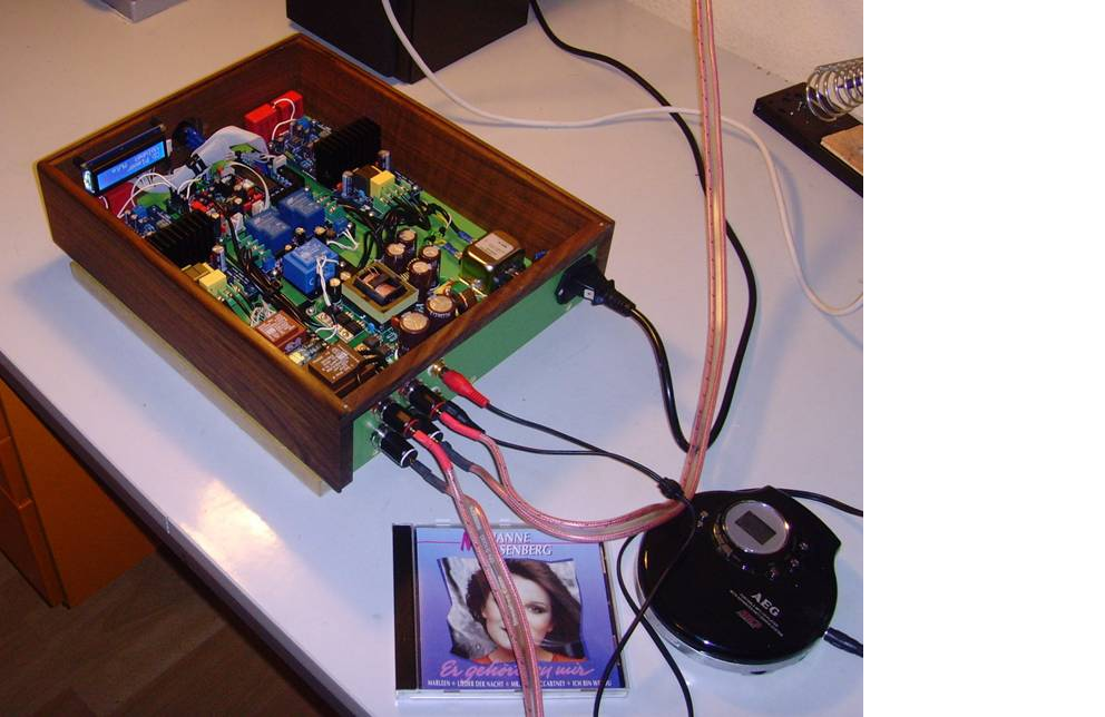

I have used one laptop PSU 19V 4A for both channels. I have made my own PCB, where B1 buffer is integrated. Look here:

very nice indeed! designwise its nice not to have the PSU in case (or at least could be).

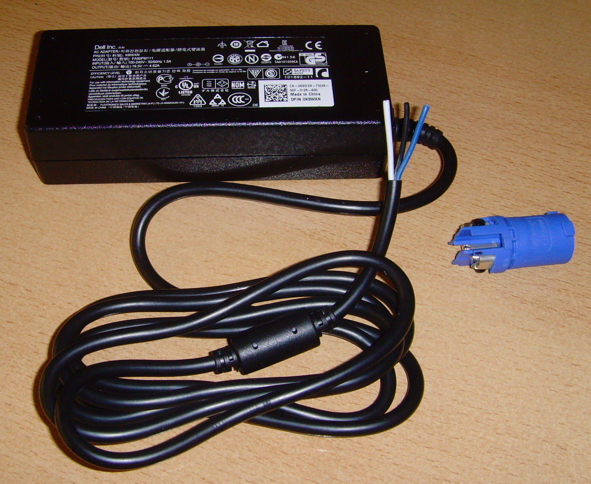

Gentlemen, I need your advice, please.
I am currently busy building an "active-speaker-concept", which will use 2 stereo-ACAs to drive the tweeters and the middle tones.
I have built a prototype on an intermediate heatsink, since I do not yet know, which dimensions the final case will have.
I decided to use an original DELL laptop PSU (rated at: 19.5VDC / 4.62A) to drive an ACA-pair.
The output of the DELL-Laptop PSU shall be connected to a NEUTRIK Power connector.
After I have cut off the original connector, I found this (image 2): three very tiny wires coloured white, black and blue.
Will these wires be strong enough to power the ACA-pair?
Which are the function of these 3 wires?
The black wire is supposed to be GND. What about the blue and the white colour - wires?
Can you please help me?
Best regards - Rudi_Ratlos

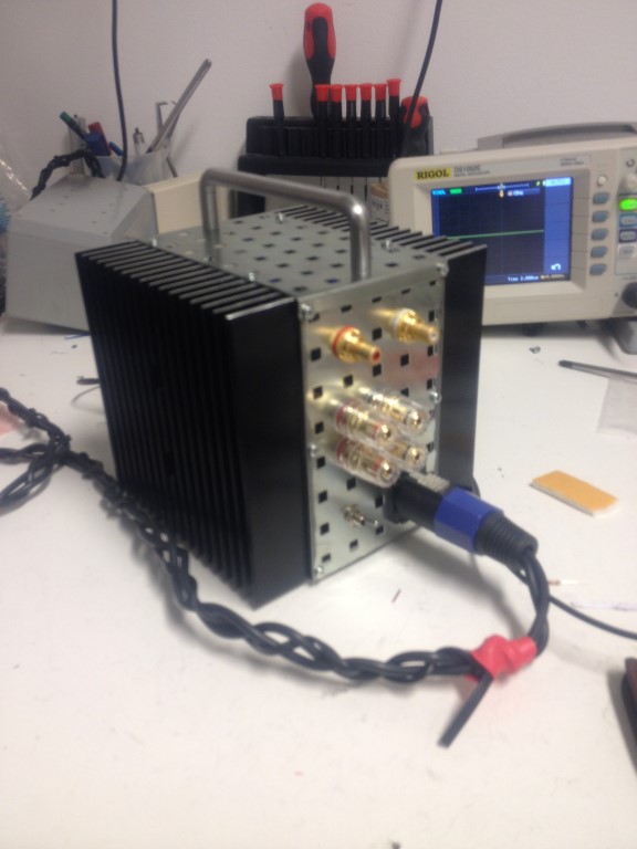

Drbf1
It just a simple box made from 2 15*15cm sinks, 3 pcs of metal plate ( cut from a plate ) and a Ikea handle.
Rudi
I use 2 * dell bricks. I added an xtra 10000uf, but they could not handle it. Then i attached a resistor and a diode in ( see Mr. Pass recomendation in the begining of the thread ) and it worked super.
the 2 bricks get warm, ( 35 C i guess ).
As fair as I remember the blue/black is the power, and the white is Dell stuff ( just cut it )
IF you have made the resistor hack on the ACA im quite sure you need 1 brick for one ACA

reenberg, you are wrong.
I inserted a 33 Ohm resistor between the clips of my DMM (expecting a current of about 600mA) and measured:
between Black and Blue: 0V
between Black and White: 18.8VDC
between Blue and White: 15 VDC
I did not yet find Mr. Pass' trick with the diode and resistor.
Can you please point me to his post?

For the diode. Se post 1965 and 1970
And Sorry I Can nok se that your brick is different that mine ( Dell brick with round corners )
