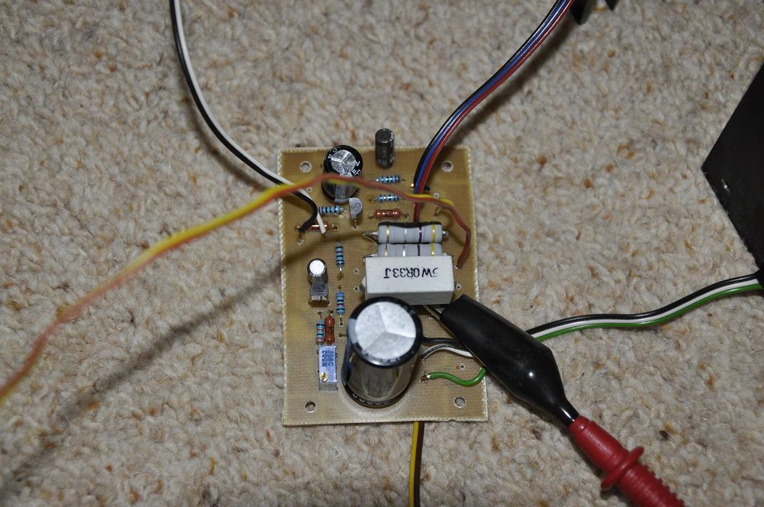

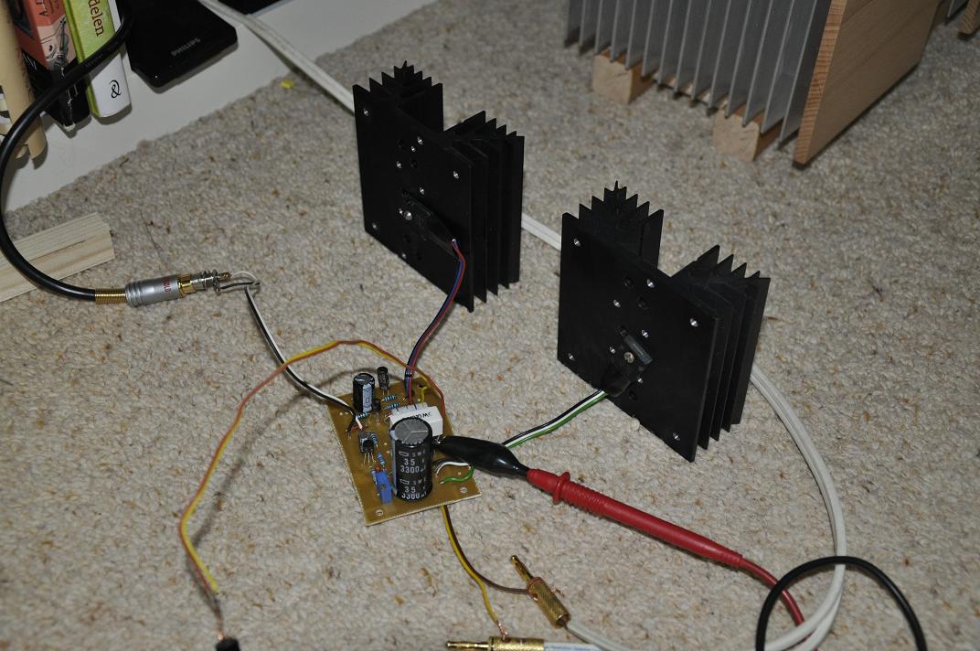

Normally I use the original 1994 Nelson's Zen Amp. But I admit it gets hot so I wanted to explore somewhat cooler options.
This little amp was just begging to be made one day. I was worried about lowish output (but my speakers - Troels Gravesen C17 should be of efficiency wise; less impedance wise - they are 4Ohm)
Today was a rainy bank holiday. In the afternoon I had assebled pcbs with some heatsinks hooked up.
Even with the small heatsinks it does not get alarmingly hot. I power it with two 19-20V Dell bricks each capable of 3.5A. No thump on power on or off.
The sound is very nice. It plays loud enough for all my practical purposes.
I didn't go beyond 11o'clock on my B1 buffer!
At this stage after 1hr listening and no optimizing I find the Zen somewhat more relaxed.
Attached some pictures.
