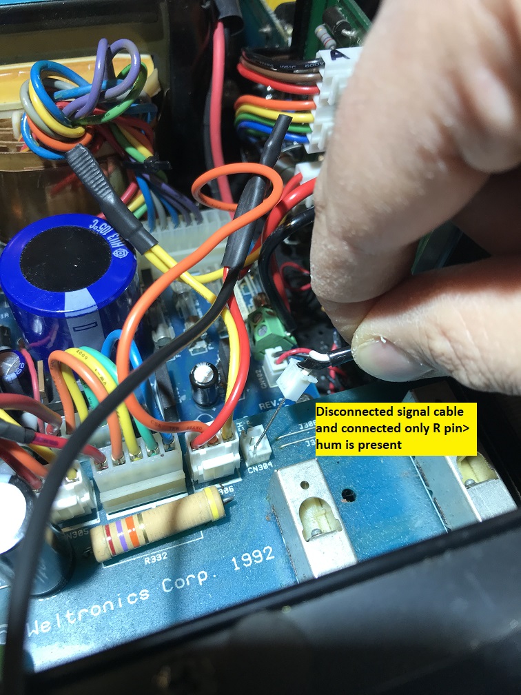

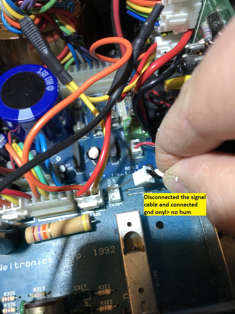

- When the right power module is connected to the preamp, through either left or right signal cables, 120Hz hum is present. I can't measure anything relevant with the oscilloscope at the signal connector (either GND or R/L pins).
- When the signal cable is disconnected the hum is gone
- NEW> if I connect only the GND of the signal cable between preamp and power module, hum IS NOT present (see picture)
- NEW> if I connect only the R pin of the signal cable between preamp and power module, hum IS present (see picture)

- When the power module on the right is connected to the preamp, through either left or right signal cables, 120Hz hum is present. The tube module is connected to the preamp through the cable indicated in the pictures previously posted. I can't measure anything relevant with the oscilloscope at the signal connector (either GND or R/L pins).
- When the signal cable (left or right) is disconnected from tube module on the right, the hum is gone
- If I connect only the GND of the signal cable between preamp and power module, hum IS NOT present (see picture)
- If I connect only the R pin of the signal cable between preamp and power module, hum IS present (see picture)

Dear all,
I am happy to report that I managed to get rid of the hum. The problem was still related to the mod which I wired accoring to the old, awful, execution. And ground wiring was the actual problem.
I made sure a ground wire follows the unregulated B+ to the regulator board and back. That way the hum was gone.
Thanks everybody for the help!
