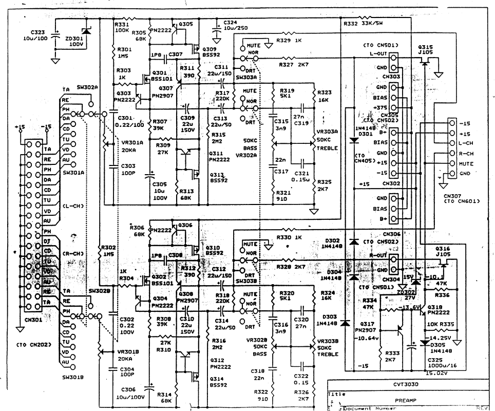

Thanks again for the support. I finally found out the reason for the blowing fuse.
There is a modificaiton on the b+ supply that goes from the preamp to one of the modules. There are a couple electrolytic capacitors towards gnd to reduce ripple. So when reassembling, after the socket/heatsink job, I inverted the connectors of that cable in a way that + and - on the caps were inverted and this caused the fuse to blow. The caps don't seem to be damaged as everything appears to be ok.
Sort of a newbie error...but I am learning fast! ;-)

Dear all,
After some extensive fixing of my hybrid amp AMC CVT3030 I am now facing the final challenge.
When I turn the knob Direct/Normal/Phones(Mute) I hear a rather loud cracking noise which eventually fades out after around 10mins of operation.
The knob is on the solid state preamp section (see schematic attached).
I have already replaced all the elcos on the signal path (C309/C311/C313 and C310/C312/C314) with Elna Silmic II. In parallel to these caps there are 0.2uF Wima film caps.
In addition, I also replaced other elcos such as C305/C306, C325, C324 (all Elna Silmic).
I also measured the voltage over time at the switch (top of R323/R324) and here are the results. Values are in mV.
Measure Point R323 (L)
30sec: 230
1min: 110
3min: 70
5min: 55
Measure Point R324 (R)
30sec: -290
1min: -240
3min: -65
5min: -7
Any suggestions where else to look?
Thanks again
Fabrizio
