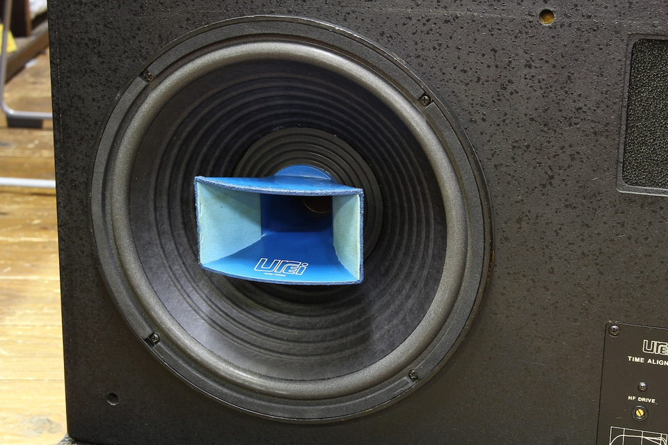

certainly more than enough proper info on web , now just a remark that there were at least 2 generations , first of them having original 604
later being replaced by some JBL concoction , not necessary worse
had opportunity to hear them once , as Kido , can't remember anything useful , except being utterly impressed

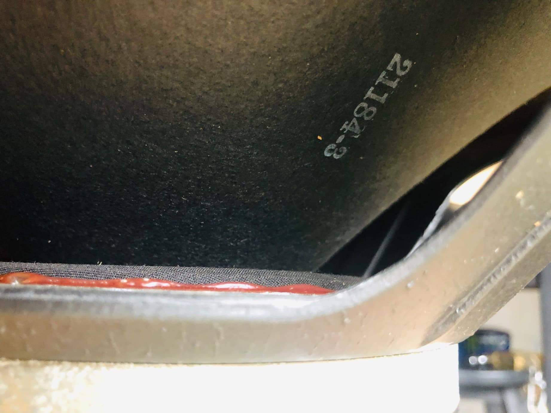

Can anyone tell me how to judge if a driver needs to be remagnetized?
+1 on measure its basic T/S specs; BL will be low, Qes high if weak.

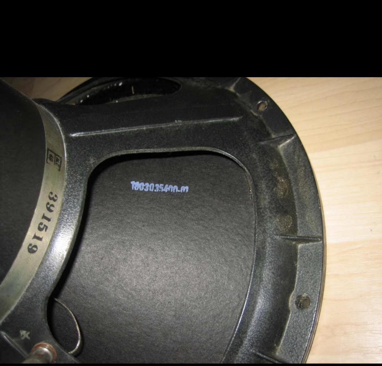

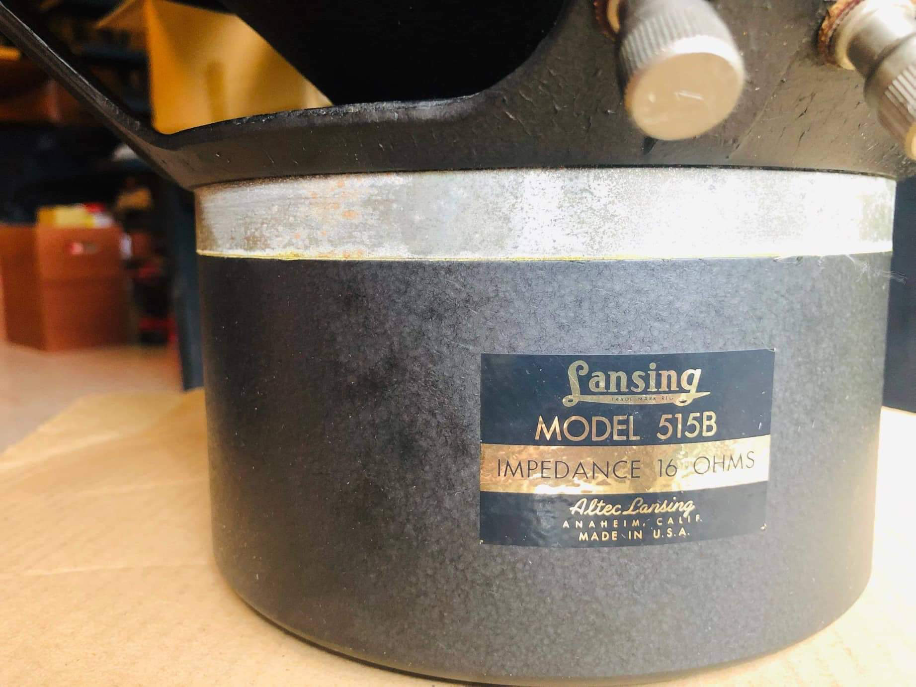

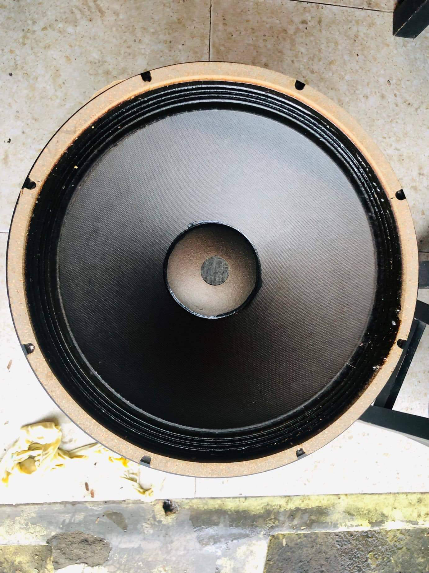

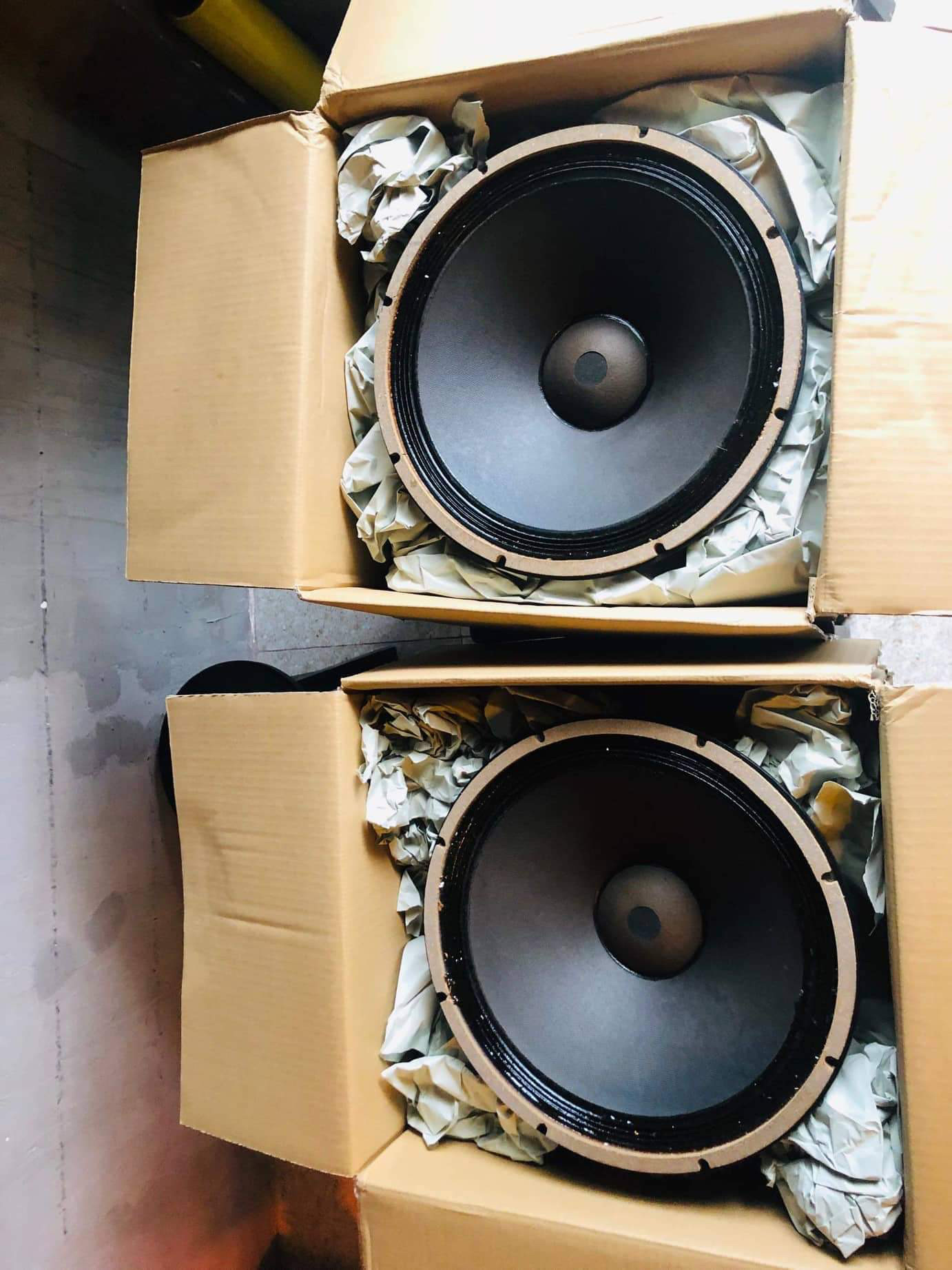

Don't recall seeing a stamp like that on any Altecs, OEM or otherwise, but can't say none had it since I never had any need to pay any attention to them, but comparing the fronts of my mid '50s Bs [one pair OEM, one factory rebuild matched to the other's specs], which looks like all the others I've been up close and personal with, its textured finish appears to have been heavily coated and screens seem different even after factoring in ultra bright lighting [especially WRT having a glue line around them], so lacking any other evidence I'm inclined to be wary of them.
Pair of Altec 515B drivers for sale Photo #2247821 - Canuck Audio Mart
All that said, by '75 I was pretty fed up with Altec QA except when custom ordering, so with a range out to '75 for that frame, no telling without measured specs, frequency response, though for my $$$ I would assume they need rebuilding to be worth a premium above and beyond just being AlNiCo.
