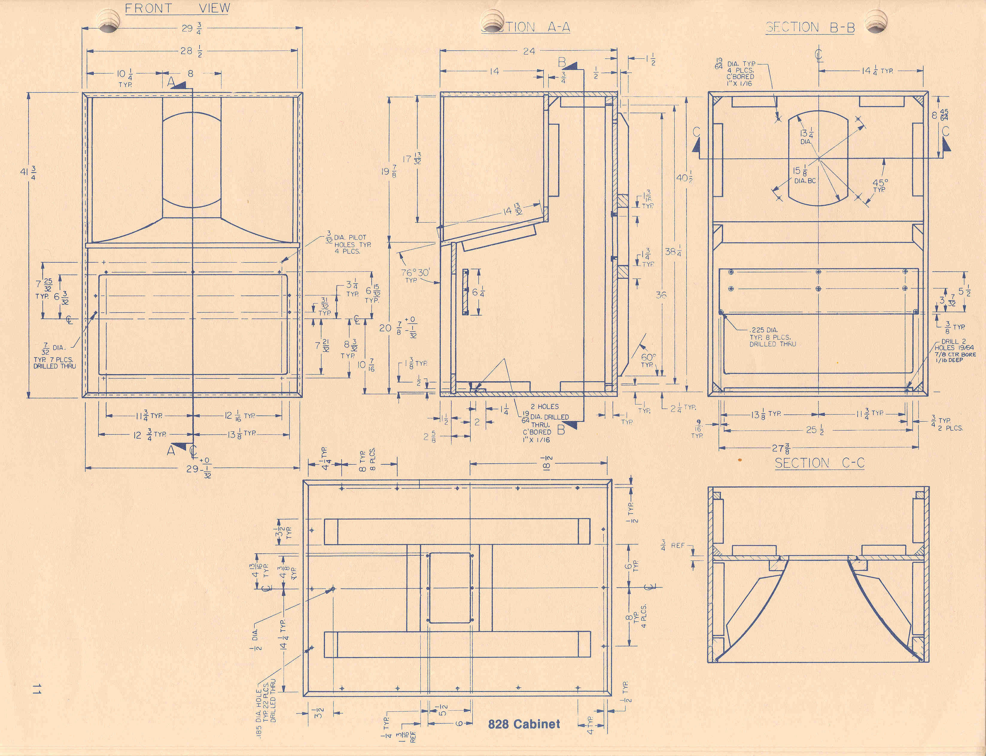

thanks for informations. 1236 seem to be attractive : where to find plans for cabinet.the most common combinations (1233 - 1236)

No plans found in Lansing Heritage Library.
Any idea where I can get 1236 drawing ?
The closest your going to get with the plans is the 828. I haven't seen a 828C plan that the specs call out that GM posted. It may be just be a minor difference.
I may have spoken out of turn but I saw no difference in the cabinets other than the 1236 was 3/4" material and my 828's are 5/8".
Thanks fellows for theses informations. Have you also seen internal pictures or close up that can help ?
Not a lot to see that you can't decipher from the drawings. Many like to foam fill the cavity between the horn flare and the side wall but aside from that, the only thing I suggest is to narrow the port gap to about 50% of what they show unless you plan to use these outdoors or in a very large room.

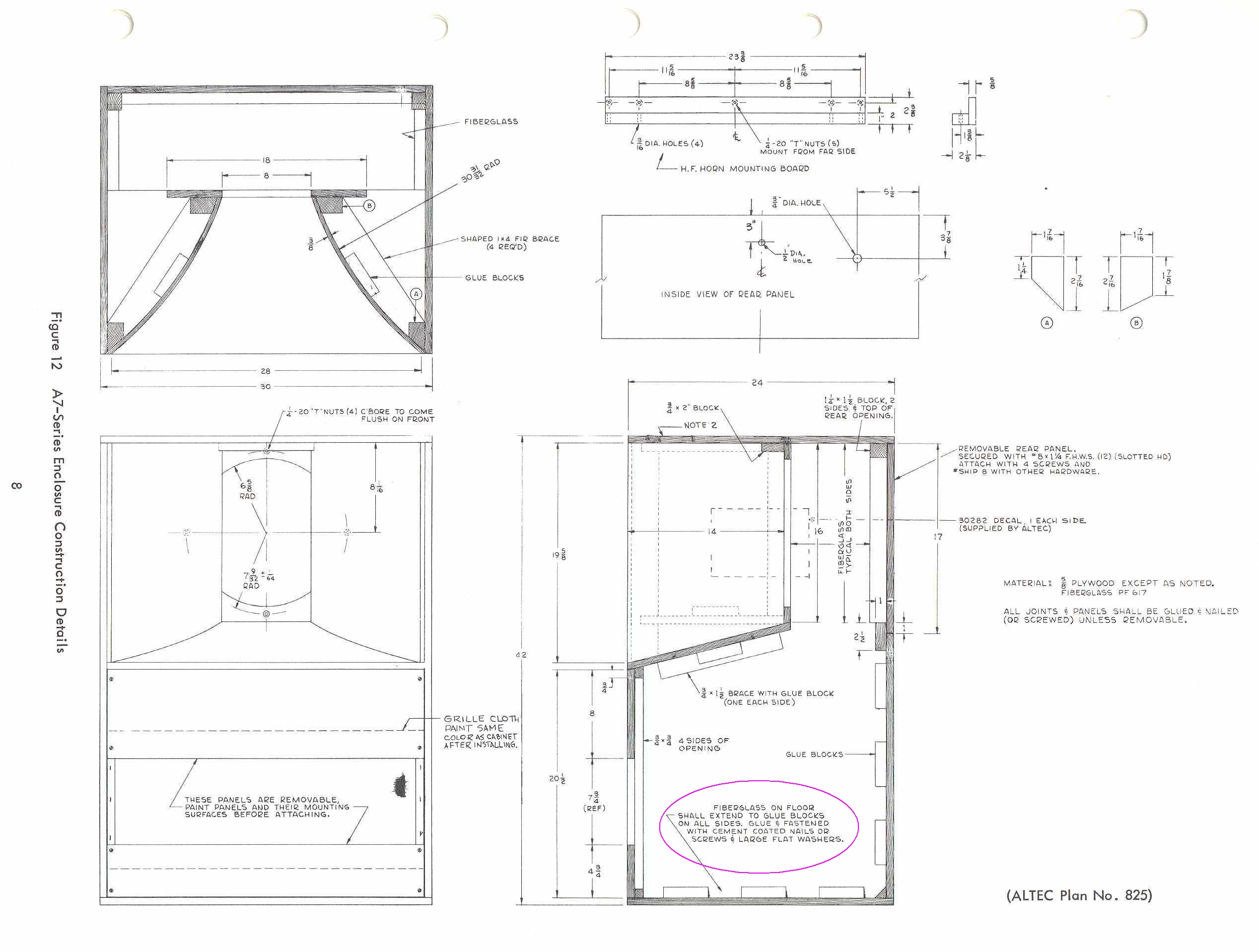

thanks fellows for links and tips. I saw mentions of fiberglass in plans but purpose is not clear for me. Any clue ?
I don't remember ever seeing one with fiberglass construction. Inside for sound damping, sure.
"fiberglass" found on drawing. But dust from fiberglass isn't it dangerous for loudspeakers ?
It's dangerous for humans, not speakers 😀 sorry, I couldn't resist. You don't have to use fiberglass, there are alternatives. Rockwool, denim, etc.
Can be if there's little/no airspace behind the driver, so loosely covering it with cheese cloth allows packing open weave insulation completely around it, though really dense cotton such as Denim Jeans needs to allow some room for it to 'breathe': Altec Heathkit legato 2-15 inch horn & driver
