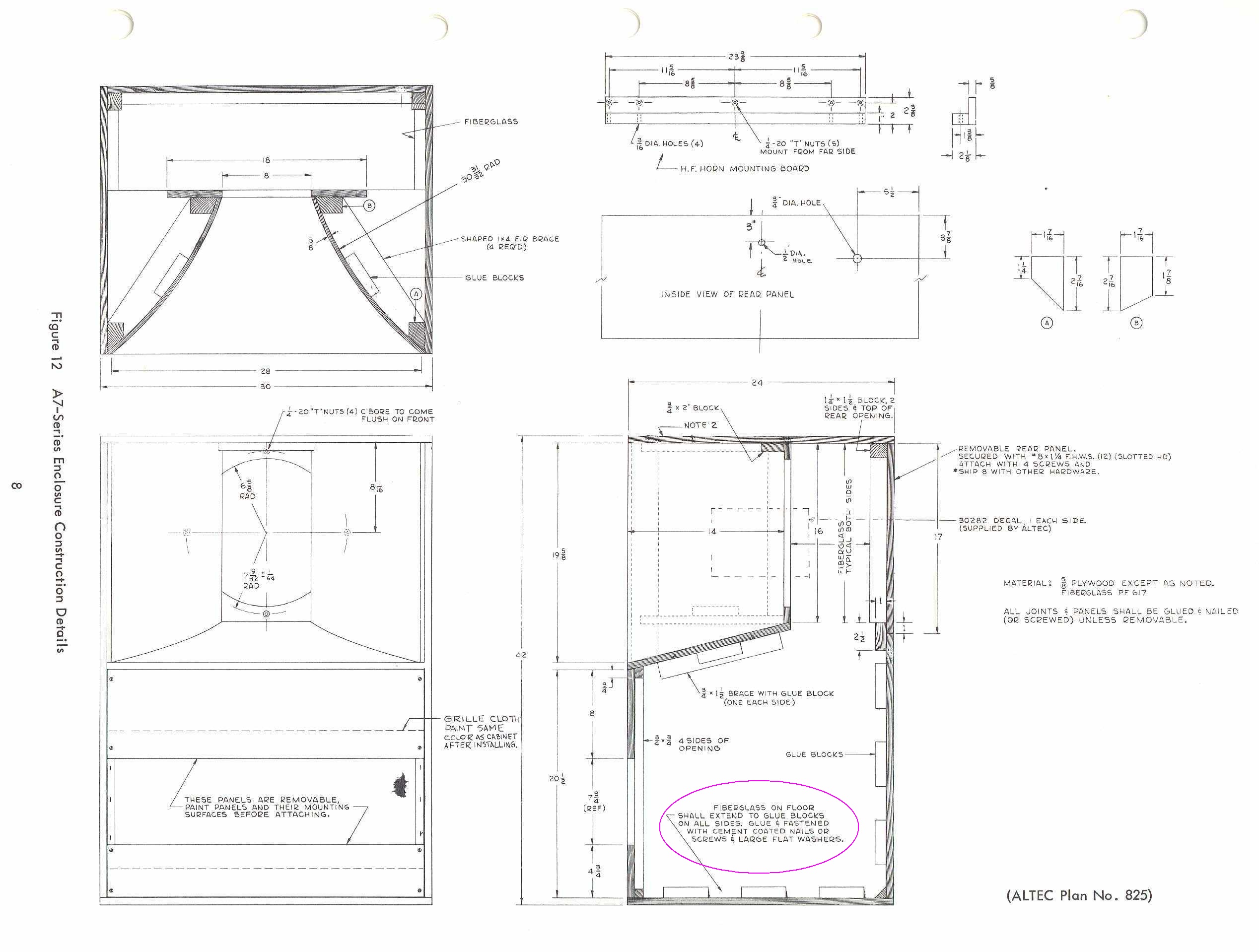

Me neither, but TTBOMK the only differences is the metallic paint job, new style logo and fancy grill on the bottom half.

edit: Haste + fading memory makes waste! 🙁 In retrospect + Googling, this appears to be the 'C' model drawing, so includes the ~full size cutout bottom 'baffle' + separate reflex tuning panel, with the original having the 825's two piece baffle boards and the 'B' as shown here: http://www.lansingheritage.org/images/altec/catalogs/1975-mi/page12.jpg

The enclosure specified for the Altec 601-8D is the 614D
The enclosure specified for the Altec 601-8D is the 614D.
I have found an Altec brochure for the 614D. But I can't find plans for the 614D. I have, however, found plans for a 614 enclosure.
What is the difference between the 614 and 614D enclosures, if any? There is a good chance that the plans are in fact the 614D, but mislabeled. I have looked through some of the old enclosure brochures I have downloaded from the internet and especially on the Lansing Heritage site and can't seem to distinguish the two.
There is very little in the user forums that I can find about the 601-8D. I have been searching on the Lansing HeritageForum, here, and AudioKarma among others. I have a pair of 601-8D's and N3000E that appear to be NOS, or at least appear to have never been mounted. They have been in a box for years now. I have some time on my hands and plenty of good plywood in the garage and would enjoy knocking these out.
Any help or advise is welcome.
Thank you, that is where I found the spec for the enclosure when I started down this road.
And, I am open to other enclosure ideas. Some threads suggest that an equivalent Altec 12", the 414A, would be an avenue for me to explore. I know enough to know that there could be substantive differences between the woofer section of the 601-8D and the 414A. I have not been able to confirm how alike or different they are yet.
Any advise would be welcome.
