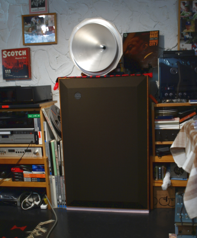

My Altec 620A
I like to show you my Altec 620A tri amped with 604-G's and an AH midrange horn/Altec 802.
The speaker was removed from an Ontario movie theatre in ca. 1982, it served as one off the surround speakers there. The bass driven with a Technics SE-9060 dual mono power amp, the mid and the HF horns are driven with a 4Ch hybrid 6DJ8/Hitachi lateral MosFet amp. The 3 way electronic xover was build after an eighties Elektor article , the frequencies are 800/5000Hz. The speaker has the usual very relaxed Altec sound and no noticeable honk. I originally used the 511 horn for the midrange, but I had to change it , because of the very disturbing honk.

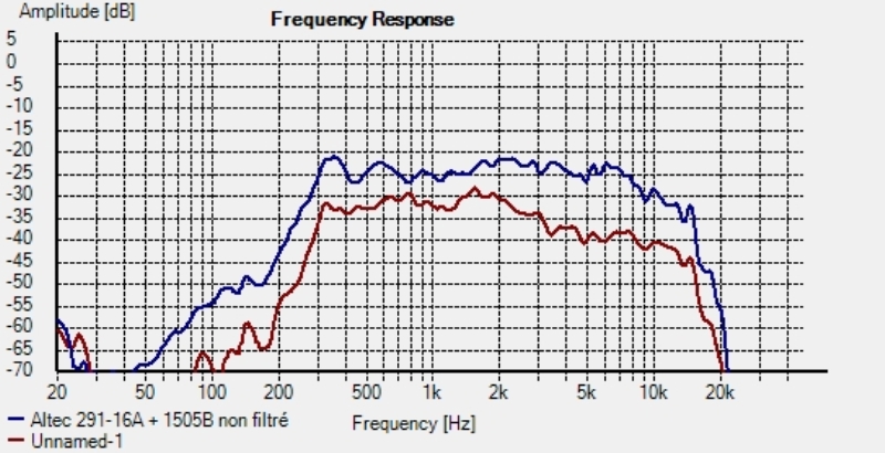

The mic is not calibrated, but as the curve is good when the mic is closed to the horn mouth, by comparison, I do tend to believe that the mic is not the reason of the issue. I made a mistake with the 6 db per octave. I am at home now and I attache a picture showing the measure (ble close to the horn, red 3 ft).
I can correct it using the preamp which is offerering a +10 db correction.
With the corrective curve, the result is very good (measures and listening)

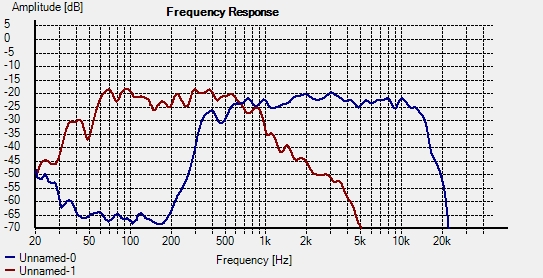

Second image show bass and medium corrected.
