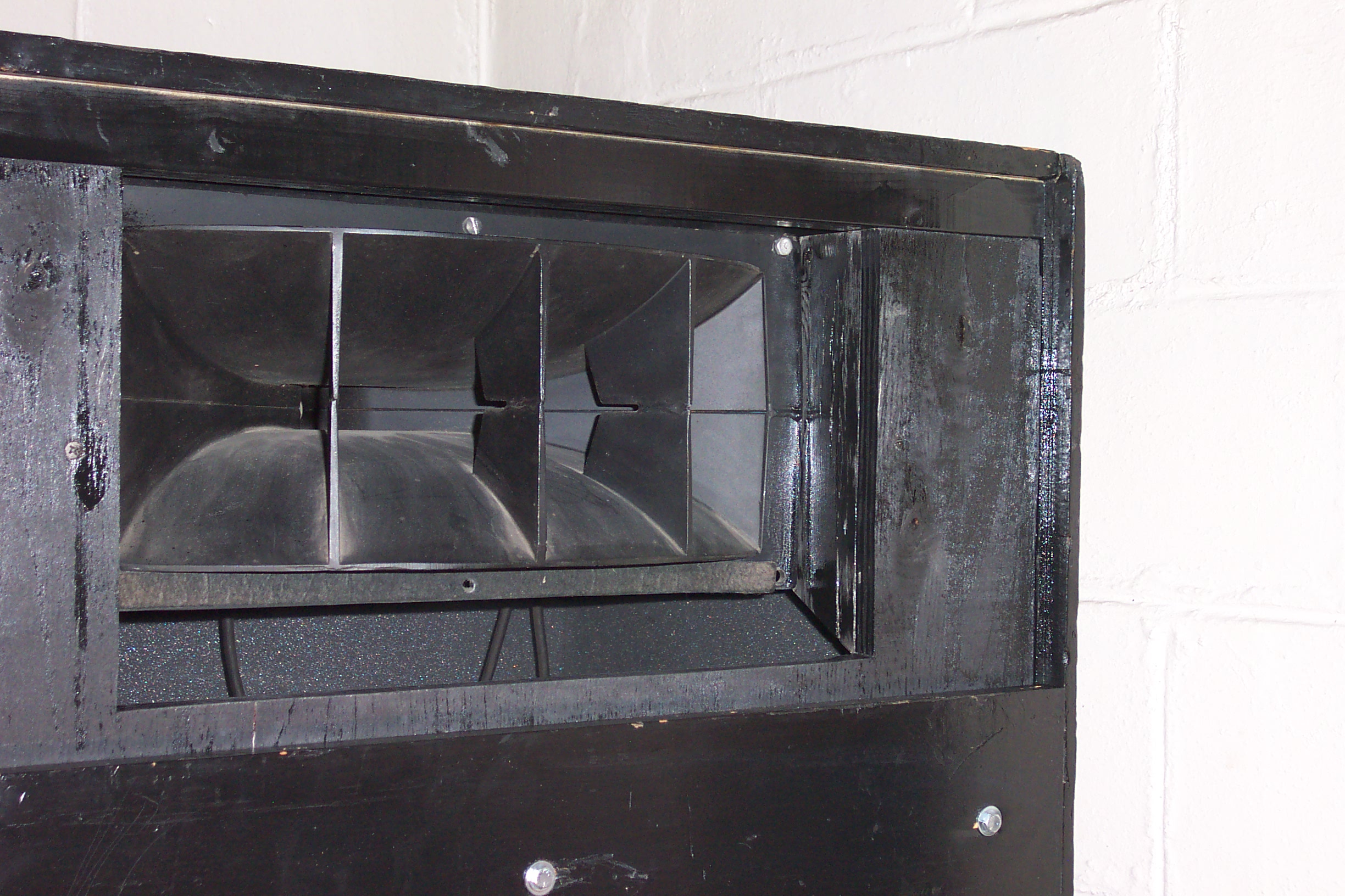

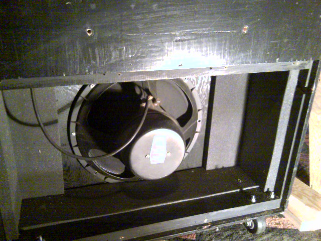

With the big port, the box is sort of part reflex, part back loaded horn. Efficient, but it won't play low. Get the horn out and make a smaller port. Anything from about 50 sq inches on down to 15 is worth trying. Easy to do with some strips of plywood.
Is It better just to pull the horn and mount it on top like it is or does it sound better with it flipped? The bad thing is the crossover control is then down on the corner in the back ,but i guess no biggie once the horn volume is set. Is there added benefit to having the bass horn mid level? what about for HT/HI tho the horn will be over my head when listening?

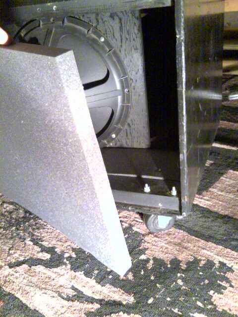

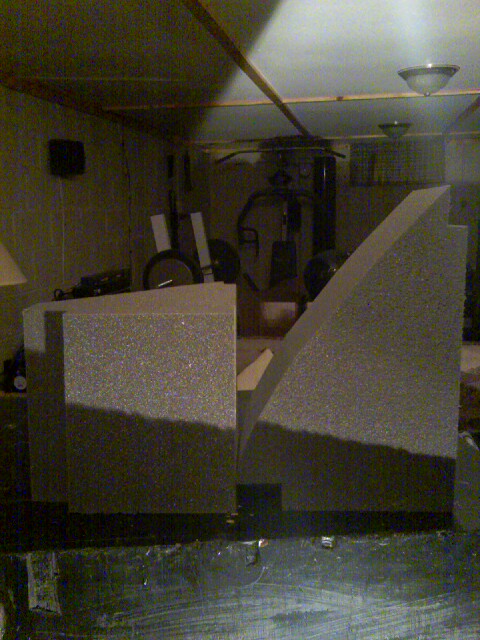

I will take pics of what i am doing and the foam I have and u can tell me if I am headed in the right direction 🙂...
also To Tune it lower just add another baffle board on top of the one their? so i would be closer to the bottom of the HF horn then?
When u fill up that cavity in the flare do u take away from the space for the driver or no?
GM I am guessing u mean i need a board to cover up that area between wall and baffle board? so it is one solid piece?
I noticed last night the other one the suspension is very loose feeling compared to my beyma, is that normal for the altecs?
I really like the way the new ones are built with the horn section and all that bracing!.

Well, you could jury rig something around the horn, but short of properly blocking the entire area off and using slot vents by gapping the horn to the cutout as was the norm on many Altec cabs way back when, best to flop the cabs around and put the horns on top of the mid-bass horn which has the benefit of reducing the distance between the driver's acoustic centers, a big deal in typically acoustically small HIFI/HT room apps where the listening distance is fairly close.

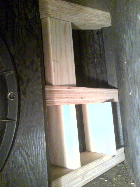

Just packing carpet padding into the flares won't brace them unless you have a way to ~uniformly compact it, so again, better to mass load them with a dense filler.
Yes, it reduces net cab volume (Vb) about 1.25 ft^3 IIRC.
I used two pieces of plywood scrap, but you could make it one piece to fit all the way across, just make a big clearance hole in it to allow the driver to mount to the existing baffle board.
All the older Altec drivers have very loose suspensions (high Vas) to keep efficiency high to make the most of the limited power available from tube systems whereas beginning in the '70s they began trading efficiency for stiffness/power handling to allow increasingly smaller cabs as amp power increased to compensate.
Yeah, that's the advantage of DIY, you don't necessarily have to make any of the manufacturing compromises required to compete in the marketplace, but more importantly, you can make something that fits the needs of your app rather than making do with what's available within your budget and usually for considerably less.

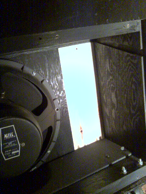

As said above, you will need to close down that port. And to do that you probably need to remove the horn. Tuning the box to 32 Hz would be a hole in the ply of about 14-15 sq in. (GM, can you check me on that?)
The 416 should not be loose, so there may be a problem.
Ideally, a ~33.2"^2 x 4" deep duct is required for ~32 Hz with sealed off flares, i.e. 828 cab in net Vb. Mounted down at the bottom, using the floor plate as one side of the vent it can be reduced to a simple ~1.15" high slot based on 5/8" thick plywood if I did the math right, so a new one piece vent board to cover all but this full width slot vent is what I'd try first and if it tunes it too low it can always be shortened to raise tuning.
Note that a good seal is required, even a small air hole can ruin a reflex's tuning, so caulk any wiring through holes and/or glue all seams and make sure the removable vent baffle, rear access plate and XO is well gasketed.
Again, yes, and if you don't like its looks you can always box it in and cram it full of carpet padding, though filling it with a dense material same as the flares is best overall.
Again, it's mostly about minimizing the driver's acoustic center distance, but you do literally feel more mid-bass/lower mids impact with the woofer at chest/face height and if you sit close enough for the HF horn to be too far off axis vertically for best extreme HF reproduction, you can always tilt it down and still have a closer driver gap than with the horn-in-vent layout.
So relocate it and make a gasketed cover to plug the rear! Altec and many DIYers put them on the front, but I always mount them on the top rear of all the large cabs to make them easily accessible to me, but not 'curious hands', at least not the shorter ones anyway............

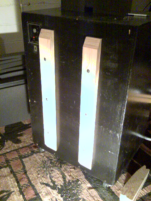

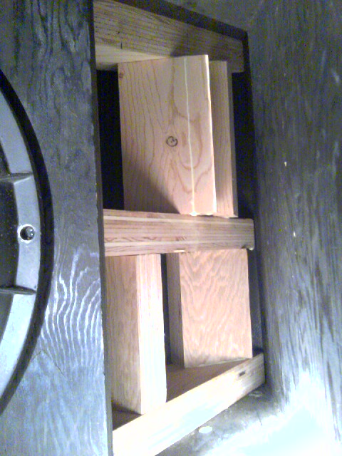

Some more pics of the bracing I finished up on today Just one cab so far, So When I block off the flares, u say its close to 1.25 cf i loose correct? what then is the total cf of the cabinet after that? Forgive my ignorance for abbreviations of cubic feet 🙂. I made a front baffle board that will go right up to the sides of the horn and leaves a gap at the bottom of horn which is 18.5x 1.5 size hole , what would that tune this cab too roughly? Will take pics of that later today after it drys and i put it in there. I still have to glue blocks in there for it to screw too etc, But Want a rough estimate on tuning before i do , If i need to close it down or open it up some...
I think call means the crossover itself. They should flip just fine. 4 screws.
I'm not for the sealing up of the flares, but that just my experience. Looks like you've got hella bracing in there, should help a lot.
Never seen a definitive volume for that cab. As best I can tell from the plans and from my mesurements, the version with the open flares is about 325 liters, or 11.5 cu. ft.
AFAIK, Altec lists the 825 as 12.65 ft^3 net and using 11.4 ft^3 net in sims yields good correlation of calc'd vent tuning to measured.

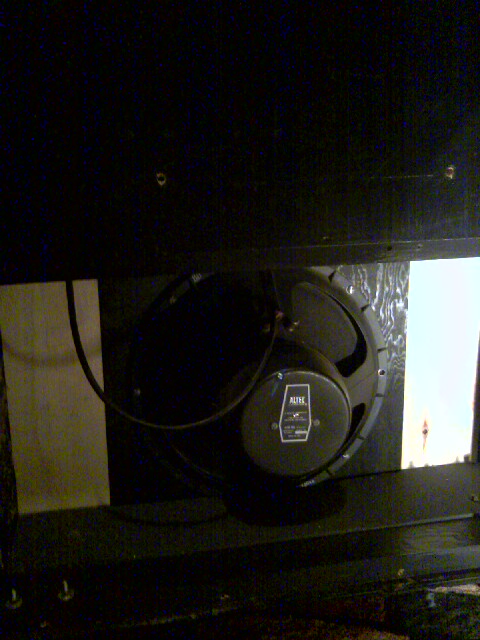

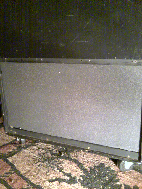

GM , Thanks, yea This is just a trial thing to try for the vent thing not even sure it will work or sound right . That's why i don't want to glue any blocks to the sides or anything to mount it, My thought was the original port came up and went around the horn mounted in there so i thought if i close it off enough to tune it lower it may work or it may not ,lol.I do like that it will be close to 33 hZ with this hole tho, nothing set in stone yet.Pan I closed up the flares with some 3/4 plywood and screwed it to the top plate it sits in the groove in the bottom easy enough to remove if doesn't sound right. Yea I may have went overboard with the bracing? 😀
I will fire it up tomorrow after the glue sets well for 24 hrs, and see what happens without the port closed off then i will try and close it off with my board and see how it sounds. Some more pics

??? The back plate proper is glued in on every factory 825 I can recall.
Hi Greg, I think I see screws on the back of his no? Mine are held in place with stainless 1/4" flat head machine bolts (I think) with T-nuts and felt tape, same with the 210 cabinets. The backs are reversible so I had assumed the same with his (uh-oh, never assume Cal)

Yea Mine are not screwed in back there its all glued together as one on the upper half, then the lower section opens up to get at woofer etc., well just the little i have played it right now at low volume it already sounds deeper etc, that's without the front vent board in place,will put that in place tomorrow and see what she sounds like with some volume with and without the board!
HAPPY NEW YEAR!.. Well finished up the Vent board, And I have to say it is a success!!.. Had to turn down most of the lower part of the EQ,Wasn't needed anymore and it sounds great! nice and deep and blows a nice breeze out the port too! The rattles are gone from what I can tell also! Here's some pics of what i did on the vent and the EQ you can see the left channel how I had it before compared to the right now it is considerably lower! for some reason it won't allow me to load pics right now sorry. will try again
