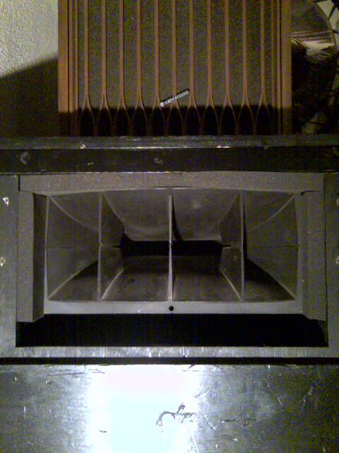

You're welcome! All around the HF horn to quell any reflections just like the picture shows.
GM

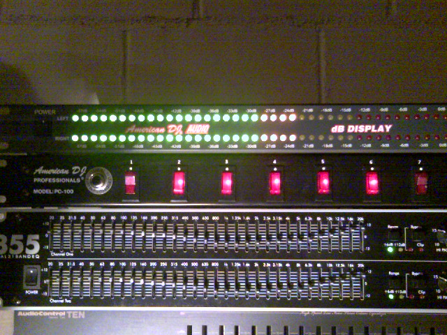

Well added some 1" foam around horn same as i have inside cab for damping, seems to sound better, worked with the eq some more too, here's where i have it now, need to send that other driver in yet too
