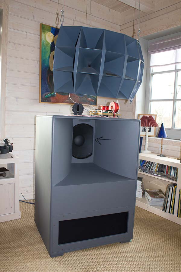

What's with deal with the lip on the bass horn throat? Haven't seen that before.
This is a mistake... Argggg!:bawling: They have been custom built by a local woodworker with the drawings I found in litterature (Jean Hiraga's book and original Altec's drawings). He did everything perfect but this stupid mistake. This has a influence on the FR (120 Hz accident). They should be fixed soon but this is quite a lot of work...

BTW, my 828/825 cabs have a lip like that in the bass horn throat. Not as wide, but it does have it.

Arrow points to the lip. Sorry for drawing so much attention to it. :eek:
EDIT: Yeah, your right Cal, lip was a poor choice of words given that it's at the throat and not the mouth. People expect to see lips at the mouth or something...
