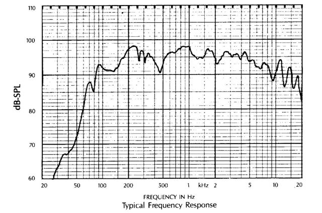

I have followed GM recommendation and built wings for my 825. I will keep them! They do not significantly extend the bass, but improve linearity around 160 Hz, and I can hear it...
Cool! Thanks for letting us know. Mine have a wrinkle around 160 Hz, so it would be good to fix that. Also let us know what you did with the fiberglass.
As for the Coax drivers, the stock crossovers don't do them justice. A better crossover can make them sound much better. See the Jeff Markwart website for better ideas.
How much more does putting wings on the A7 help the bass?
Also what insulation is best for these cabs?
The wings primarily provide a termination for a too short horn (half size 55 Hz), so smooths out its 'ripple' and by going all the way to the ground it extends its F6 ~an octave or around 70 Hz, so if you either make them wider and/or taller as was originally done with the A800, then you should get solid response down to around 40 Hz even with a HF horn peeking through a gasketed cutout (click to enlarge): 800 VOTT
1" acoustic fiberglass (sometimes 2") as used to damp heating/AC ducts: Owens Corning 703 : Ready Acoustics!, Hear - Sound - Better
If you prefer to stuff, then use polyfil if for no other reason than MJK's MathCAD software will accurately enough plot how different stuffing densities affects performance.
GM
Mine have a wrinkle around 160 Hz.......
Just a 'wrinkle'? Here's a typical ~free field measurement showing its broadband dip. Then again, this is low enough for the room to help fill it in plus I don't recall ever seeing a large multi-cell A5's response, so maybe there's some fill from it down low also.

I am posting the FR before using fiberglass and after. I am using 2 inches on the sides, top and bottom and 4 inches on the back.
The second curve is measured with the wings in place. I made the wings with 19mm MDF. They are 28cm wide.
Blackson was what I used on the back of the horns in Mr. Hiraga's speakers. It works great. There are now non hardening substances that are water based. YOu might look into that.
Thanks for the graphs. Looks like the wings brought up the bottom end by 6dB or better. Am I reading that right?
Looks good!.. So I understand the graphs correctly, the first one is without no fiberglass or wings correct? the second graph is with glass and wings? also what are the two curves at the bottom of the second graph? What glass did you use? and Is your reflex chamber closed off where the flares are? Pics would be great when u get a chance of the wings ,front and back etc 😀
