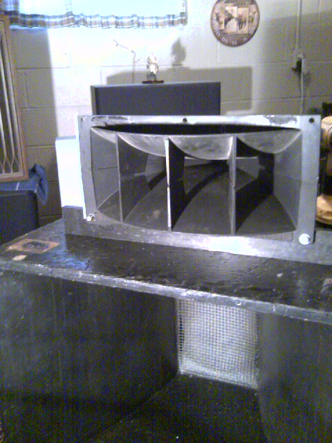

Ok here is a pic of how far back the horn will be with the proper 19.3 spec seems awful far back from the front of cab doesn't? It is 7" to front of cab from edge of block. FWIW it wasn't aligned when it was inside cab like you thought GM!... I think I will just build side wings otherwise I don't know how to make that horn mount work and sound right and keep the VC aligned

That's just a starting point for finding the correct setback and since it's an 811, I imagine it will move forward somewhat, but not having timed one I don't know how much.
Anyway, as I noted, the easy way is to mount it to the top 'wings' and use digital time delay (TD). If you don't want to go this route, then from a sound quality (SQ) point-of-view (POV), better overall IME to properly align the horn and skip the top 'wings' since you're already getting good room loading down low.
That said, Altec would sometimes use a cab width horn baffle, so that's one option and I see no reason why the full size top 'wings' can't be used complete with connecting shelves if you want to go to the extra effort, though even if it's just a horn perched on top, any horizontal surface in front of the horn ideally needs damping to attenuate early HF reflections.
Long term though, switching to a 511 or some other much longer horn seems a good plan for full 'wings'.

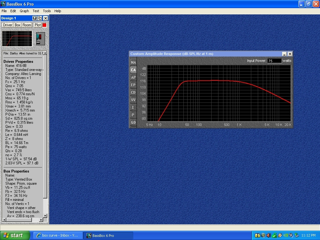

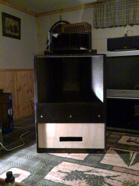

Yea It Looks like when they were mounted inside it was about 16.25 or so to VC, maybe i will just go and match that on top and call it good? Here's is a pic of my new bottom baffle plate and port. The port is 10x 2.28,will test it tomorrow for loudness as its getting late and kids are trying to sleep,lol.. but it sounds pretty damn good on the bottom end! Had A friend of mine use bass box pro 6.0 to get me the port size by seeing how the curve looked using the woofer in a 11.47 cab, Figured a little bigger with horn out of cab now, and it looks pretty damn sweet!.. I will see if i can get him to send me that curve.

Yeah, if you're not going to do acoustic measurements, then stick with the 4-3/16" stock mounting setback.
I thought we 'agreed' to put the vent down at the bottom to at least get the max available vent efficiency/floor boundary gain. Hmm, I see casters though, so probably doesn't matter.
Looks like a ~32 Hz tuning..........

Yea We did on the vent, but i cut these at work and I have a 2x2 at the very bottom to help with bracing that part of the cab, and i have heard to always keep a vent away from any blocks bracing etc. I will see how it sounds not like i can't make a new one :).Yea if i had the tools to do it I sure would. How much is the stuff your talking about to get the proper phasing?. Here is the curve

.........and i have heard to always keep a vent away from any blocks bracing etc.

True if you take its near boundary conditions into account when designing the vent. For instance, a shelf vent where the sides, bottom of the cab are vent 'walls' will be much shorter for a given tuning than if a cutout with the same area (CSA or Av) is well away from them.

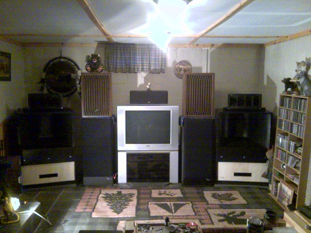

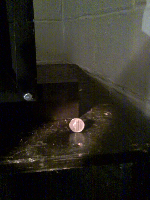

Well their completed for now!, I turned them on when i got done and they sounded so tinny and loud etc, so I decided to slowly move the horn up towards the front and sure enough they came right back!,, the block is 3 3/4 away from the edge of cab, very close to where they were originally inside! so not sure how that 19.3 works cause it sounded like **** lining VC's up.. maybe if the horn was longer so it came to the front and still lined up then maybe huh? They rock man! The altec one I can turn up probably three clicks more on volume than the beyma one it starts popping,lol... it should be pretty intense next week when i get the other one back from GPA! For now the horns are just sitting with a 10 lb weight on them not mounted yet, But there is no resonance moving them at all! I also did the nickle test at power and it never tipped over! I would say cabs are pretty solid! I can feel them 20 feet away on my body and I don't even have the other 416 yet! Can't even imagine how they will be with wings yet!

Hmm, something's not kosher, I've done alignments many times and never experienced this plus I've been told by someone who should know that the A7-800 factory offset used over the decades is technically incorrect, but never having had any interest in these I didn't bother to note the various correct VC offsets for the different XOs at the time.
Regardless, mass quantities of music/PA has been recorded, enjoyed with much praise and few complaints, so the ideal may not make all that much difference, but it does on the 500 Hz and lower XOs and higher up for folks sensitive to timing errors, ergo not to be disregarded as a waste of time for at least some apps.
Right, if you can balance a coin on edge without it falling over or 'walking' around while reproducing LF signals down around/at Fb at the highest SPL likely to be used, then you're 'golden'. :D
