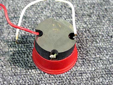

What is the heavy white coiled wire in the Alec 3000H driver does?
It's seemingly not connected to anything, nor is shorted, just coiled in magnet there.
My other question is, how is the driver secured in place in the base of the horn?

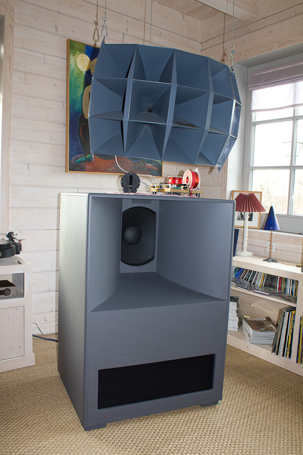

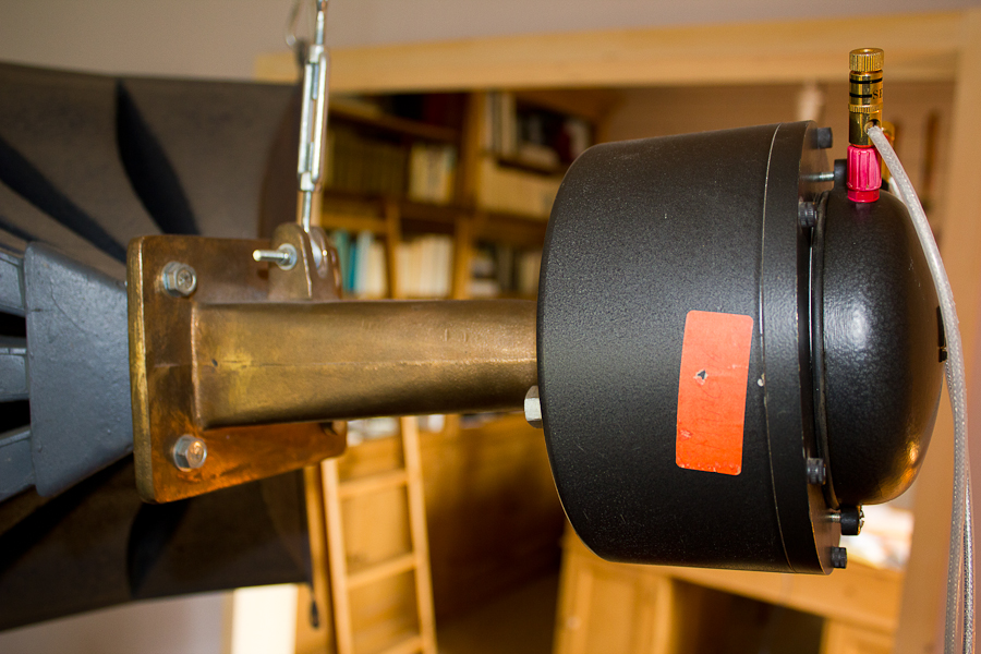

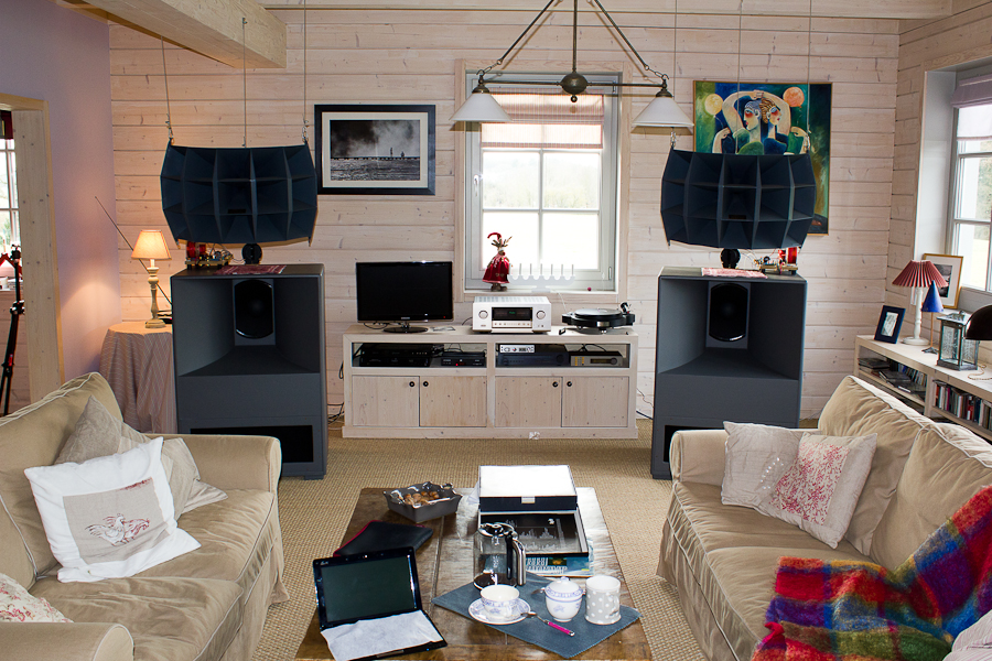

In fact, the reason for the flying horn is that I wanted to have flexibility for the time alignment. Finally, I decided to keep tehm hanging as my wife like this solution...
Before the 825, I had a supravox 285GMF and before that, ONKEN with 416-8C. Time alignment with the Onken was an issue. I am listening close to the loudspeakers and the stage (3D effect) is much better when these horns are associated with the 825.
