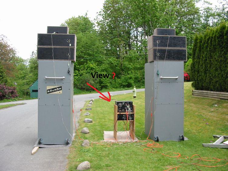

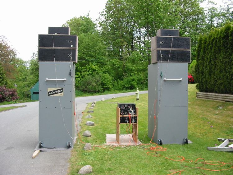

Re: Beer Garden - Hof Brau?
Originally posted by JoMoCo
Is there anything more relaxing than music outside in the sunshine in a garden with time to enjoy a good brew....
Nope
Maybe its time to get some wheels under my speakers and "share them with the neighbors" out in the garden 😎
Yup

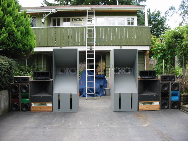

valhallax said:
ok...i had to post..hope ya like, hehehe
Arrggggghh!! Damn you Valhallax! :bawling:
On second thought, that's down right inspiring. Maybe I can do that.
Or maybe I'll sneak up north of the border and "liberate" those 18 cell horns chez Weldon......... (they want to come home to the USA - you know)
