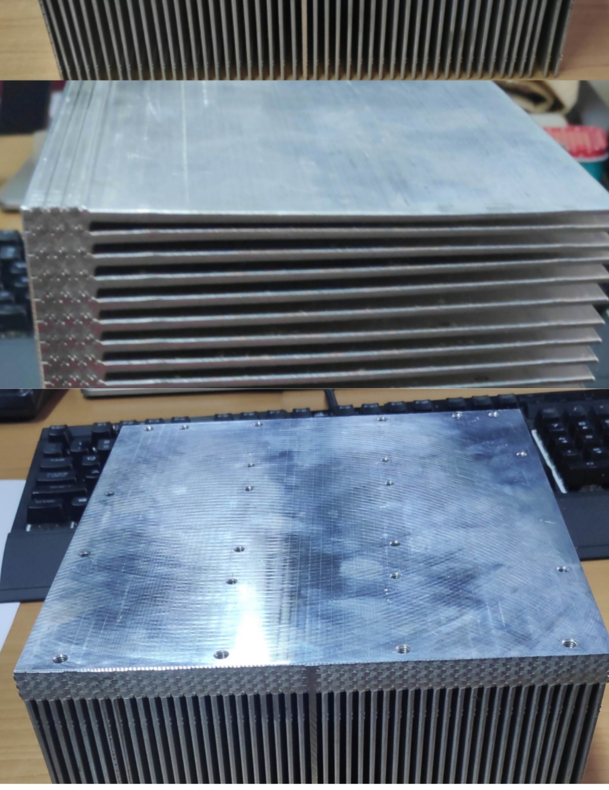

in my opinion that heatsink will be too small
COOLING THE NIRVANA
Oracle1 (in Delphi?)
Your heatsink is likely too small.
One channel of the Nirvana will be 25Vx2x1.8A=90W of dissipation, and this means 45W from each output device. You need a large heatsink which in still air will give you a thermal capacity of 0.2C/W, and that would be around 12" long and 6" tall with 2" fins. This would then run at 90x0.2=18C above ambient. In summer in Greece I would expect temperatures up to 38C (correct me if I'm wrong) so this would take the heatsink up to 56C, which is about as high as I like to take it for good life for the mosfets.
OTOH, if you use force cooling you can use a heatsink with around 2.5 times higher impedance, that is, 0.5C/W because this is the improvement factor of running a fan.
Heat is the enemy for Class A, and while you are unlikely to have your amp sitting in a room in your home at 38C (you may use AC, or live at a much higher altitude) but you need to design for the worst case. Too often the worse case seems to happen, and if you are selling amp to the public, it ALWAYS happens!

Hi pinkfloyd4ever,
The 4U 300mm will not have enough heatsink with a bias at 1.8A, it will become too hot in summer.
See the calculations of Hugh.
I have the 4U/400mm for my Alpha and that works fine.
Also there's always not enough place inside a case 🙂
especially with dual mono
I have done extensive measurements: in my 'case', a 4U 300mm dissipante, the AN temp raises up to 25°C above ambient and stays there.
Not recommended in the hot summer indeed.

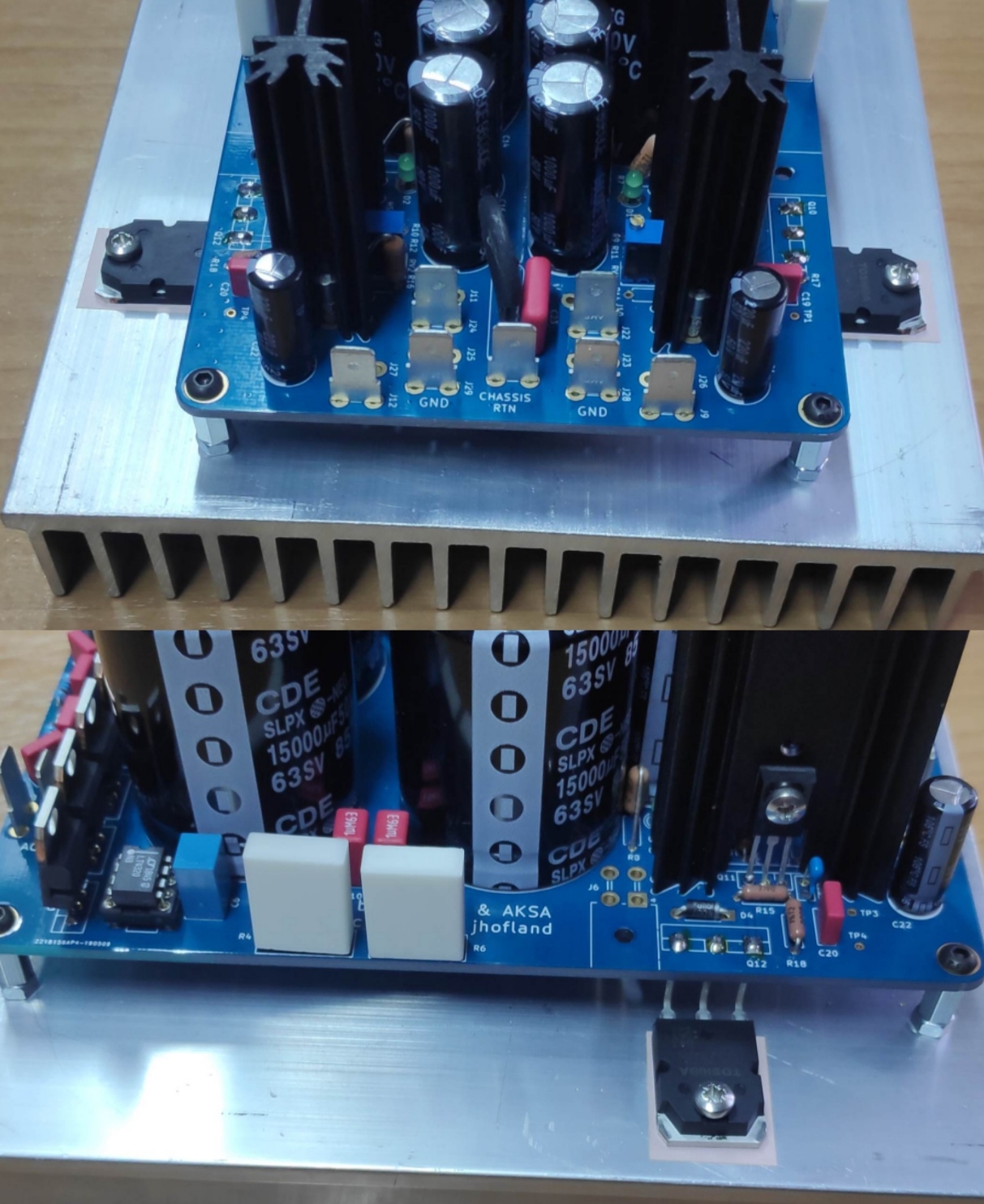

Hello friends,
If i install the fqa directly to the pcb without the snubber boards schould i altered any part ?
Thank you.
Thank you.

Oracle,
I would not suggest dropping the snubber.
These mosfets have very high transconductance, and they are running at high dissipation. Any oscillation would destroy the devices in an instant and likely take out your speakers as well.
Snubbers are suggested by Cordell and a very precautionary addition. Eliminating the long leads does not change the real tendency towards oscillation of these large mosfets.
Hugh
Hugh
The PCB has provision for a snubber. Please populate it if not using the snubber helper boards.
Hi Oracle1,
Sorry my mistake. The Alpha Nirvana PCB does not have provision for main PCB mounted snubber as it doesn’t even have holes/pads for PCB mounted MOSFETs. If you mount them fo the PCB you will have to mount the snubber via dead bug style onto the legs.
That’s a lot of work - can I ask why you don’t use the external MOSFETs and snubber helper boards as designed? It really makes amp installation and removal for adjustments much faster and easier. Once you try it and see how it decouples the process of mosfet mounting to heatsink separate from PCB mounting, you will not go back.
