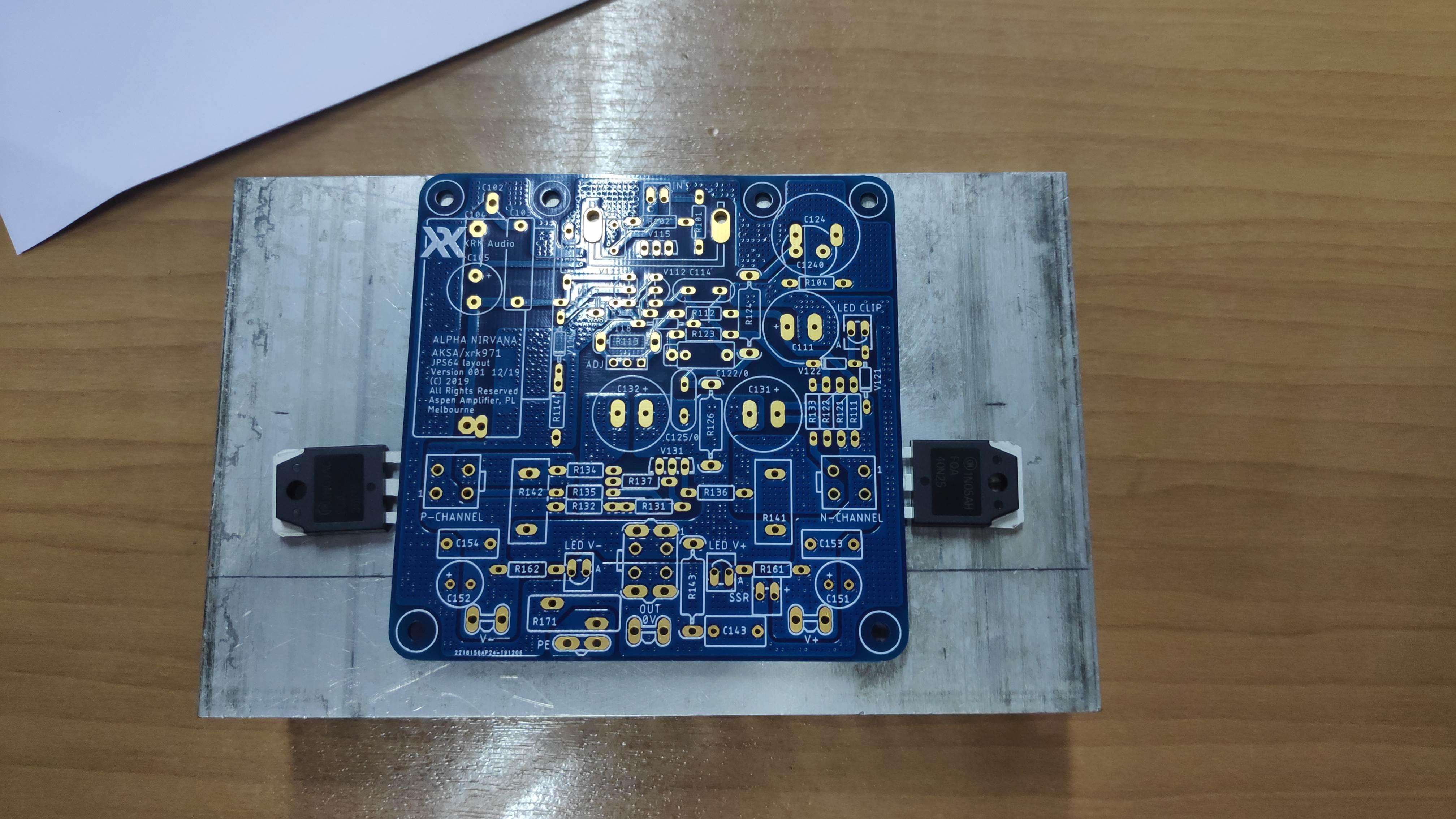

I'm planning to build an amp with dual mono power supply (2x SLBs and 2x Antek AS-3224), an SFP soft-start, and 2x RTR Speaker Protection Gen 2 boards. At first I plan to put Aleph J amp boards in here, but I also plan to swap out amp boards only and use the same chassis and PS for the Alpha Nirvana, other Pass/FW designs, and possibly any other Class A designs that will work with a PS of that size.
My question is, does anyone think all that could fit comfortably in the Deluxe 4U (300mm deep) chassis from the Store? Earlier my plan was to use a 4U 400mm deep chassis for it, but I've recently found out that 4U 400mm isn't an option for the Deluxe chassis with milled/punched rear panel and UMS heatsinks. Apparently I could get it made if I ordered direct from Hifi2000, but it would be very much a custom job, and so quite expensive...and I'm on a bit of a budget.
I am capable of drilling/tapping heatsinks, but I'd prefer not to if possible.
By the way, is the Antek AS-3224 the right voltage and VA to do what I'm describing above? I'm wondering if 300VA per channel is overkill, and if 200VA would work just as well....I always wish antek made 250VA models.

"Comfortably"? Perhaps in the eye of some builders; sounds crowded to me, but I haven't tried it. You would get extra room going with SMPSs with Mark's soon-to-be-released four-pole SMPS filters. Others have stood the Anteks up on end using an "L" bracket to gain some space. Stacking board on top of one another would also help, as well as using the front and back to mount items. Try using the google search:

I use a 5U/400 w/UMS heatsinks. Perhaps consider that option?
And I have a single 800VA Toroidy with 4 sets of secondaries (22V) on order for precisely the builds you are considering.

For the builds that you are contemplating, I would strongly recommend a 400 mm depth chassis.
I would also second Anand suggestion on the Deluxe 5U x 400 mm chassis if you can't find other options.
Drilling and tapping heat-sinks can be quite a pain. 🙂

I also noticed that you are planning to get transformers with 2 x 24V secondaries; with the SLB, my estimation is that it will give around +/- 27.5V (after voltage loss from the cap mx and transformer voltage sag), which is perfect for the AN amplifier, but might be a little high for the input JFETS used in the Pass designs.
I haven't used the Antek transformers myself, so maybe X can comment.
