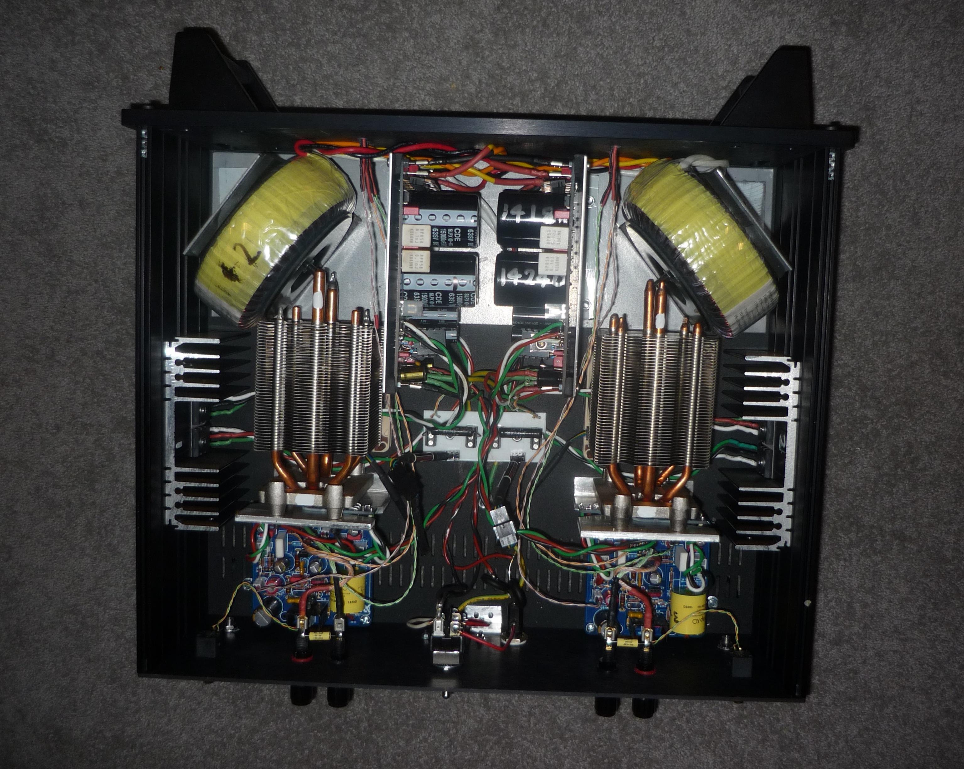

Well, I am very happy to be able to report that - after a marathon effort lasting more than 12 months - I am finally listening to 2x AN 4Rs driving the mids & ribbons of my 3-way active Maggies. YAY! 🙂
Which I think are the first AN 4R amps to be created? 🙂
OK - what was the major cause of the troubles I had (then I'll get onto a couple of additional issues)?
Quite simple - the layout I had chosen! 😱 I had bought 300VA power toroids which were a bit over 120mm in diameter - so they couldn't be mounted vertically. But in mounting them horizontally, the only way I could fit everything into the 350mm deep SlimLine chassis (HiFi2000) was to mount the AN PCBs vertically, on the back panel.
See 1st attached pic.
And the result was:
* when the back panel was open - ie. laying backwards - I got a sine wave out from the spkr terminals when I fed one in from a sig-gen.
* but when the back panel was closed, I got a square wave - which caused my ribbon to blow, last year.
This took quite a while to diagnose ... because of a couple of other issues associated with building a 4R AN.
When it finally became clear that closing the back panel with the AN boards mounted on them resulted in a whole lot of wires being compressed into the space between the AN boards and the bracket on which the CPU coolers (holding the Snubber boards) - which caused the square wave problem - I realised I had to re-organise the layout in the SlimLine cases.

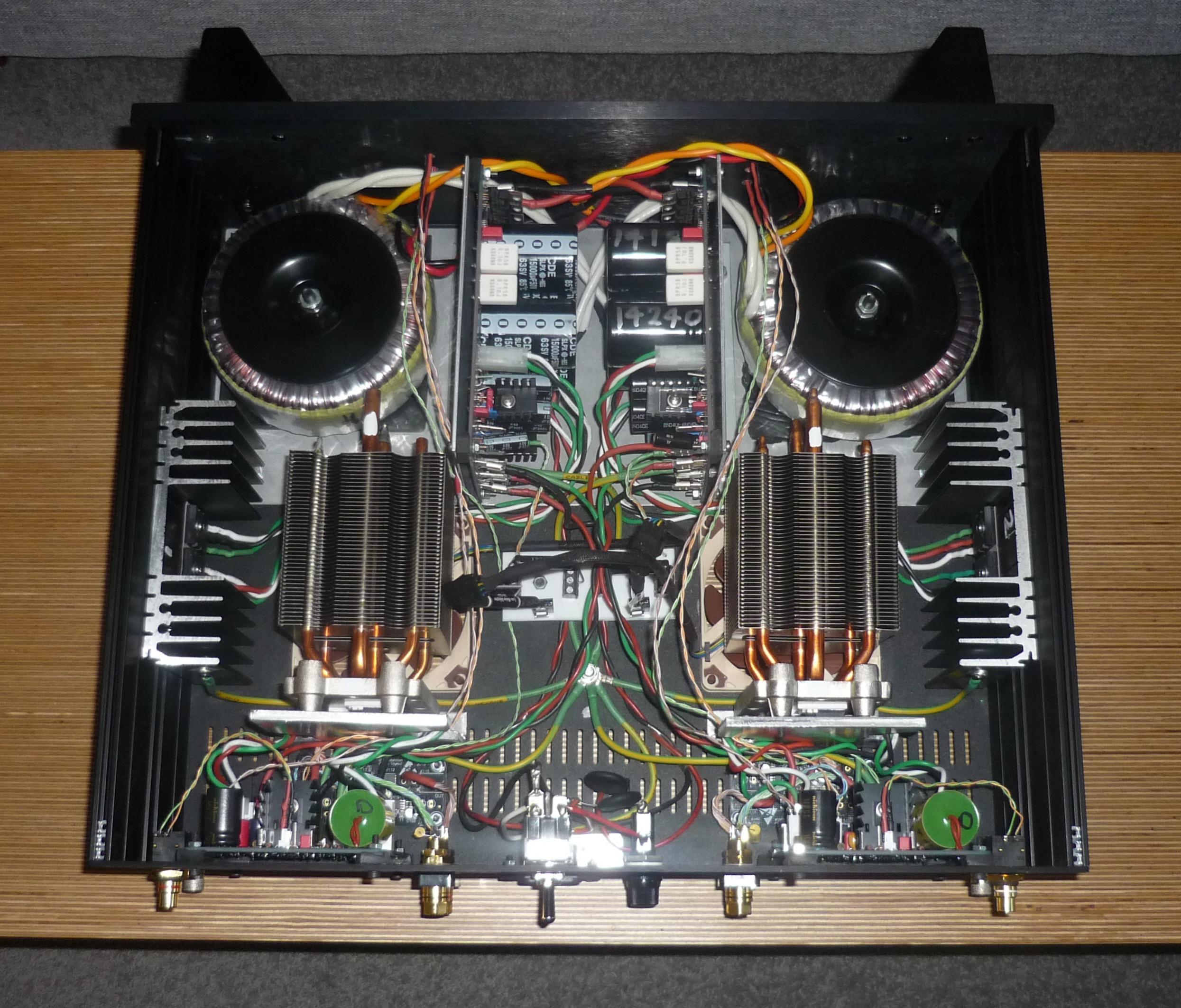

Which led to layout #2 - see 2nd attached pic.
Here, I mounted the power toroids vertically at the front of the case (on some 'L' brackets) and had 2 rectangular slots cut into the bottom panel of each case ... to allow the toroids to sink through the bottom panel - leaving a few mm gap between the top edge of each toroid and the case's top panel.
This enabled me to move the CPU coolers forwards ... leaving space for the AN boards to be mounted horizontally on the bottom panel, at the back of the case.
This allowed the back panel to be bolted closed ... with no issues! 🙂

I guess it goes to show you that there are certain trials and tribulations one has to go through when stuffing a Class A design into a smaller chassis. I don’t have the courage nor patience I think since I am from the classical amp building side of things where we use big heatsinks and don’t use long wirings for MOSFETS, specifically the SLB’s and AN boards in this case (due to ‘potential’ oscillation issues). That being said, the zeal of conquering that which may seem insurmountable is something I admire! And looking at your pictures I learned a few things!
Congratulations and let us know what it sounds like versus other designs you have built!

Yes, I could've used a 4U - or even 5U case - but I liked the concept of active cooling and preferred to have a 3U chassis, if I could get it.
In terms of "long wiring" to remote SLB transistors / AN mosfets, I like the concept of off-board devices. 🙂 The wires from my snubber boards to each AN board are only 4" long, max - but, yes, those to the SLB transistors are longer ... perhaps 10".

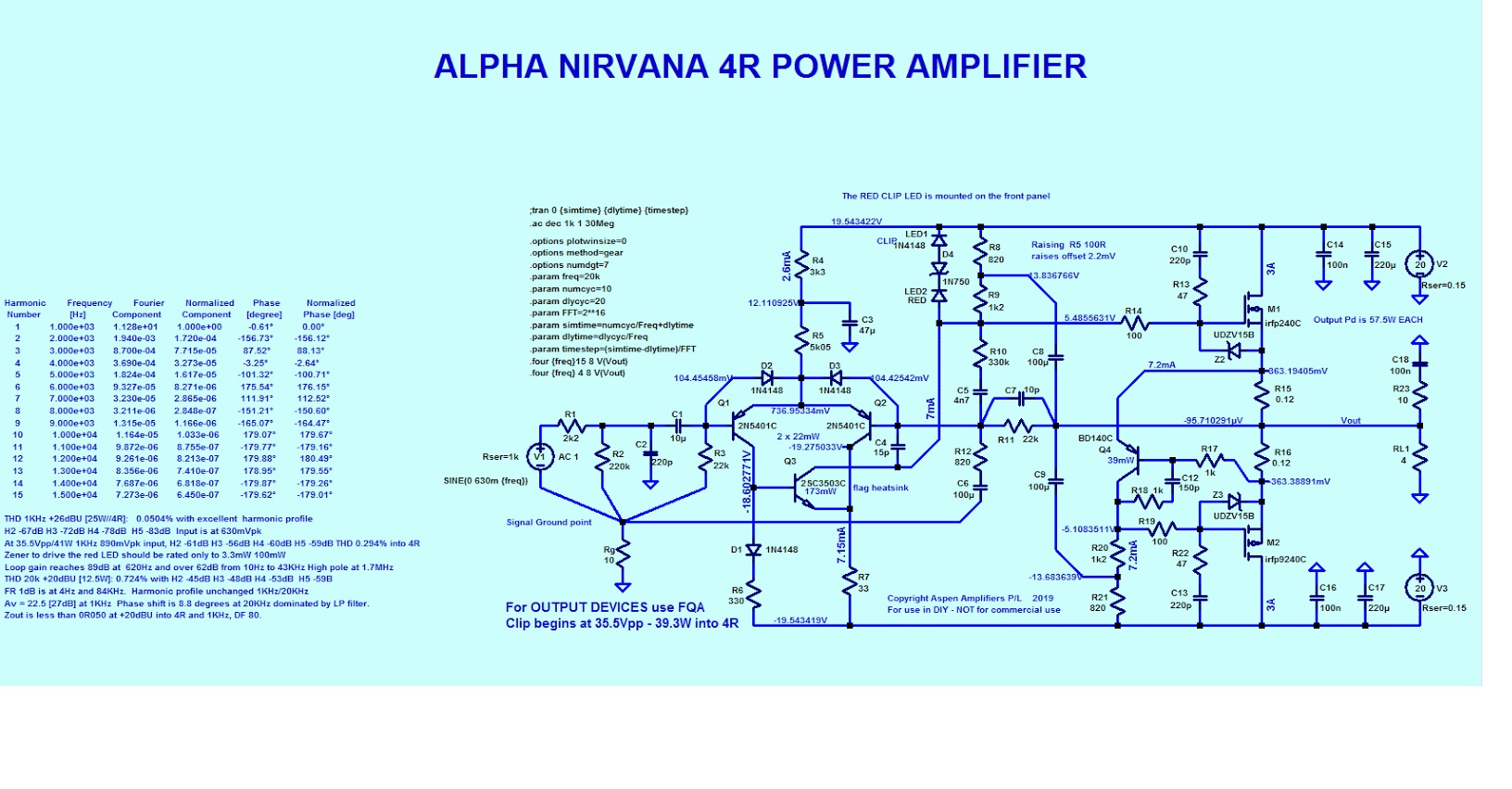

Andy, which exactly schematic have you built? From which post?
Hi Minek - see attached. (Sorry, I don't know which post referred to it.)
If you are going to build the 4R version, you need to refer to my spreadsheet which gives the relationship between the component nos which Hugh Dean used in his 4R schematic and the 8R schematic that is the basis for the AN PCB.
I believe X has listed this on the 1st post in this thread.
