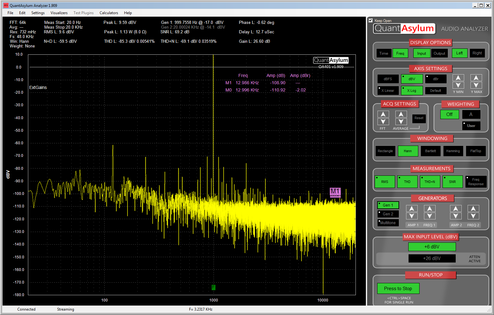

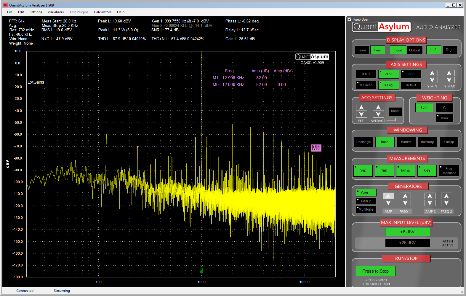

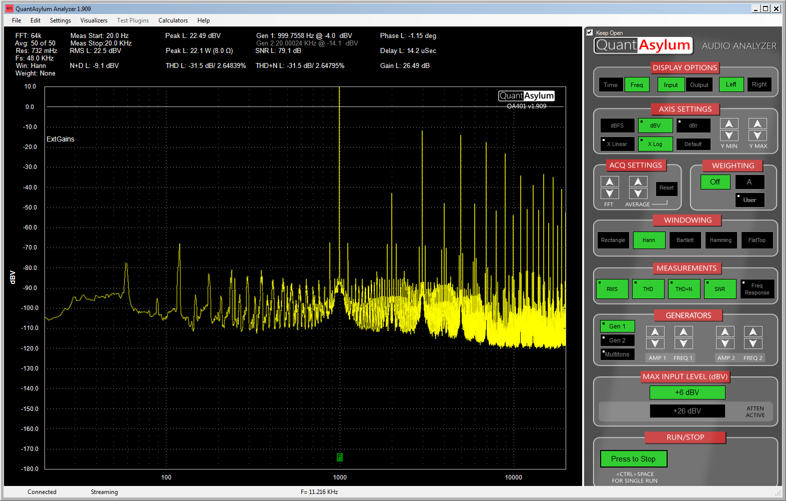

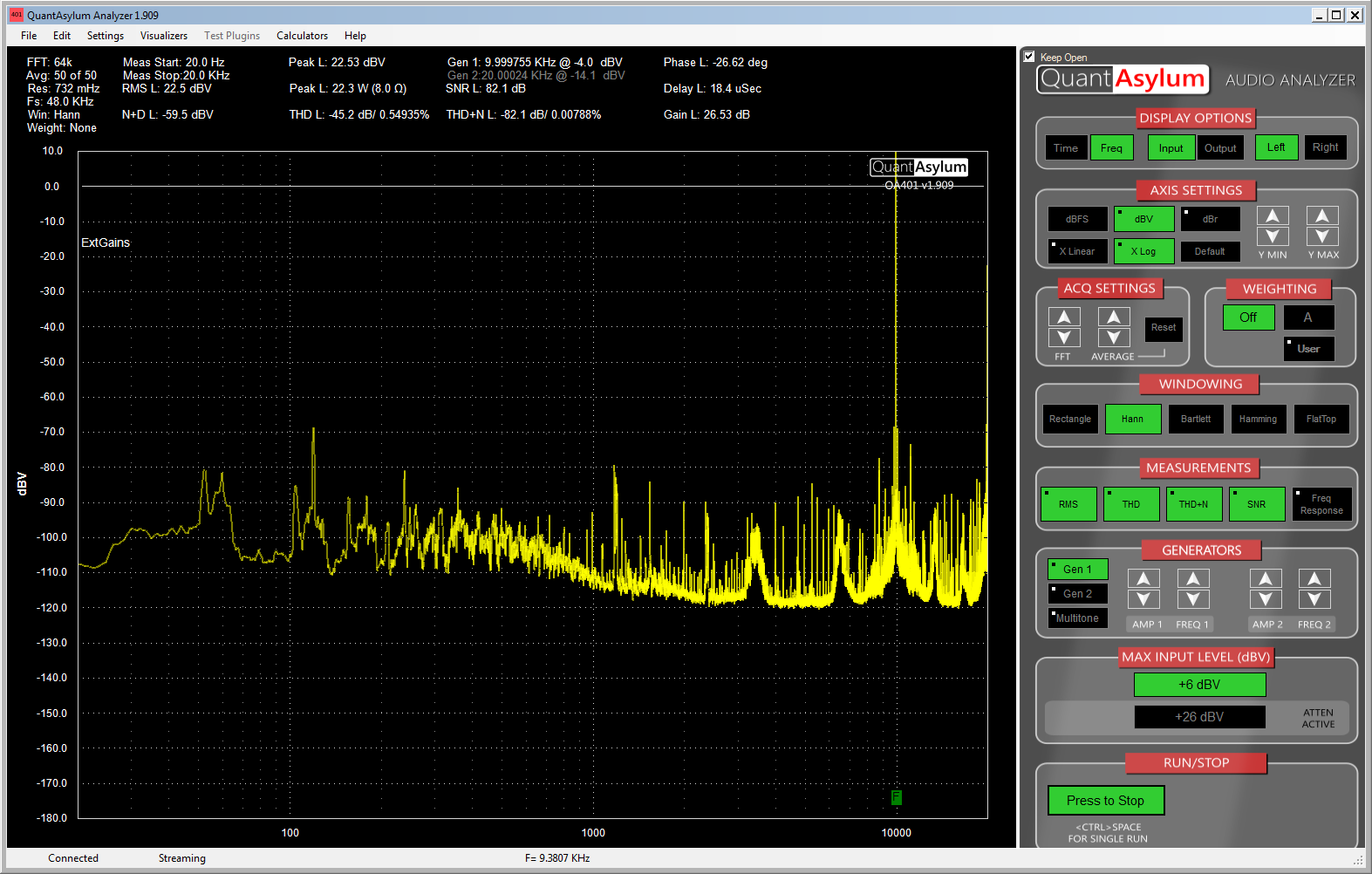

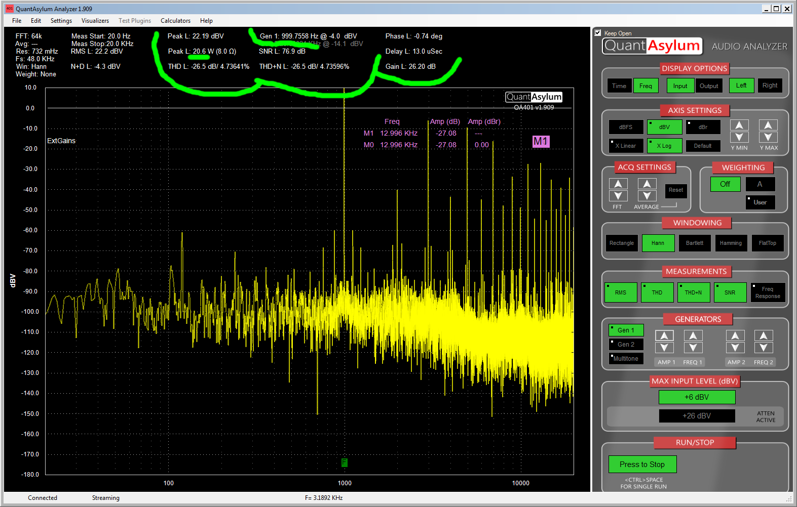

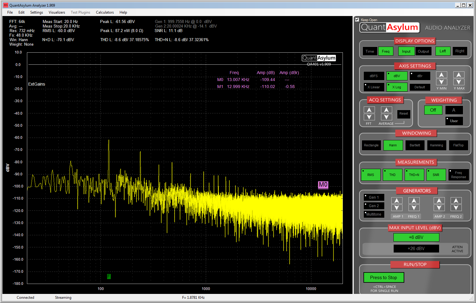

I managed to do some measurements of my build of AN,
using QA401 audio analyzer. PSU at +/- 20V.
Results below.
For some reason, noise floor in my setup seems to be very high.
1st screen shows noise floor with no signal.
It's not amp's fault; all amps I tried to measure show this..
Even without power applied to the amp, this noise is till there...
So all this noise can be discarded, and we need to pay attention to the numbers reported, and general level/shape of the plots.
Results below.

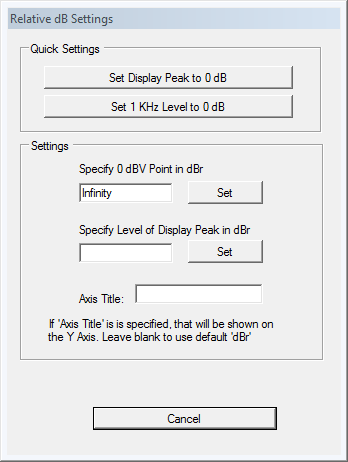

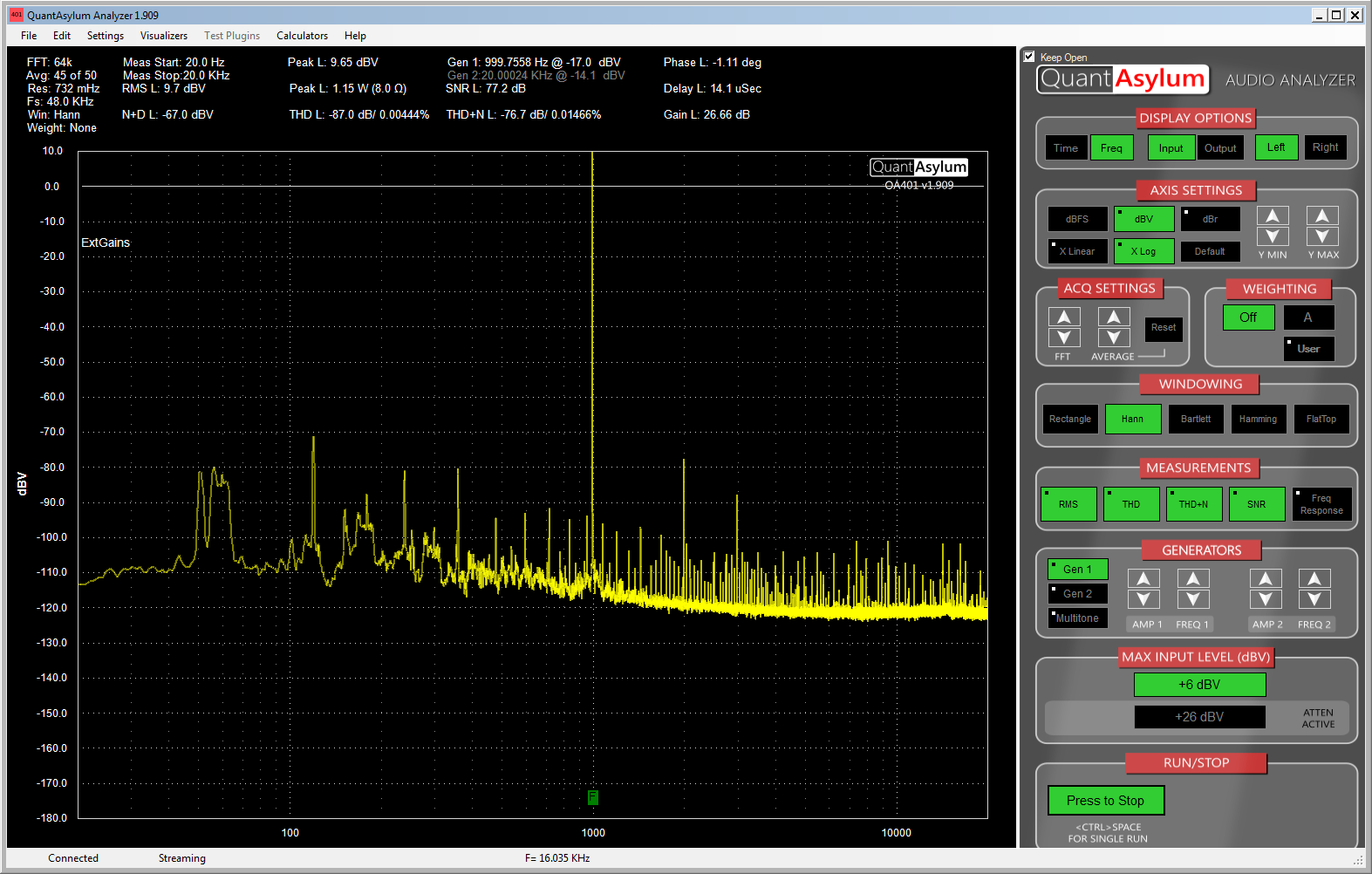

To get the noise floor down, set the average to 50
Select dBr peak to set your noise and distortion components to the output level.

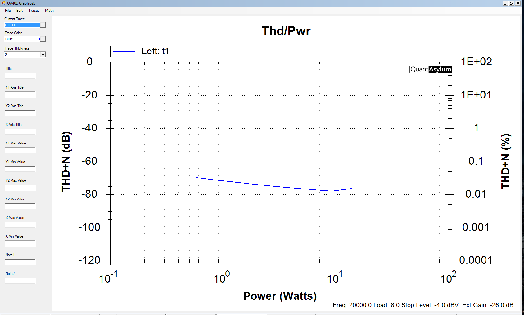

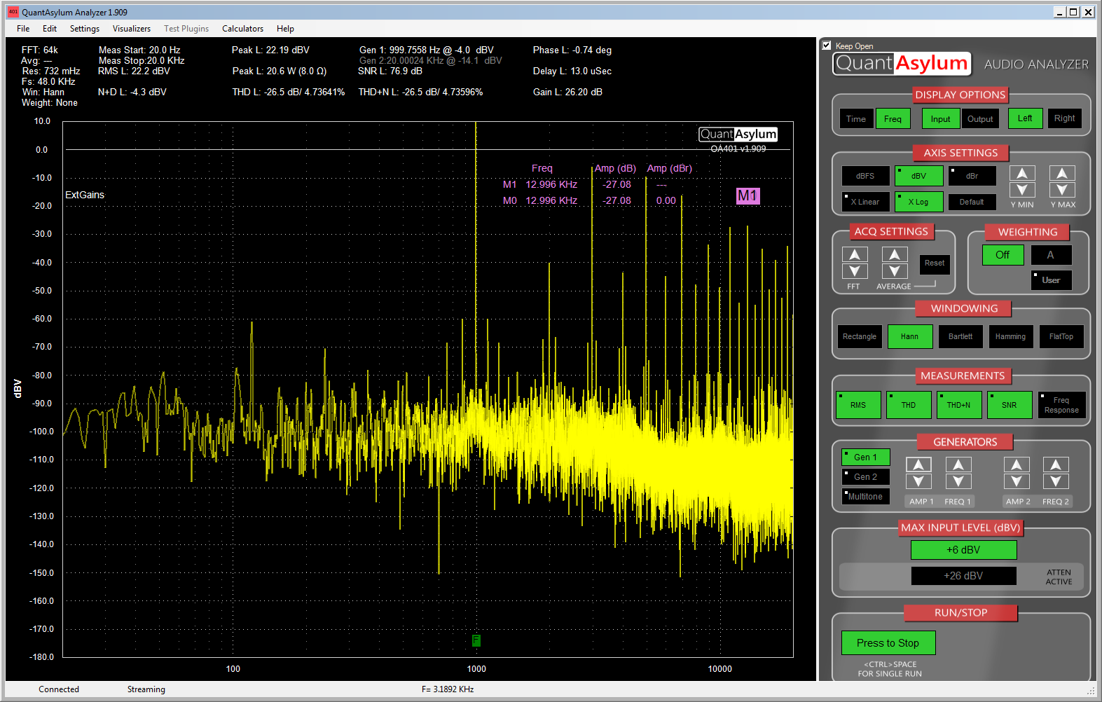

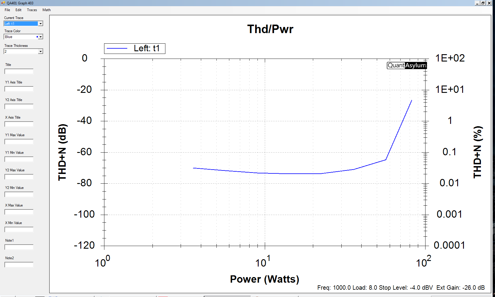

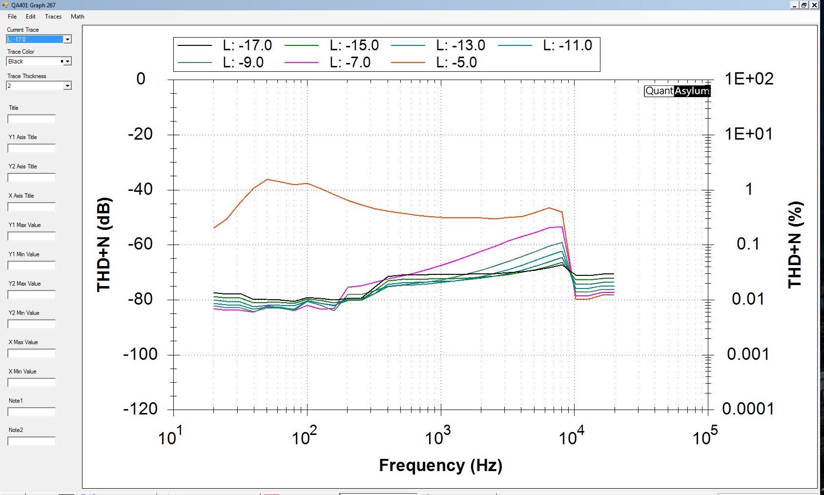

Hi Minek,
Can you tell us the conditions for the data - power (or Vpp) and load impedance etc?
It looks like you got about 50w before the distortion started rising? From +/-20v doesn’t make sense?
You can see power ratings, load impedance, signal freq, etc in each plot (images #1..#7, on top).
Also - if you move mouse over each image, browser will display (in the status bar) a tooltip with filename, which shows power and freq.
That's why I didn't repeat this information in the post.
In my case, usable power ranged from 0-20W. Above 20W thd is too high.
The last 2 plots show strange value for max power. I guess it's extrapolated?
The settings were to measure power from 0 to approx 20W.
Image #9 is for 1kHz, #10 for 20kHz
Thanks, will try it. Have 5 more amps to measure...
Edit: where do I set 'average' value to 50 ?

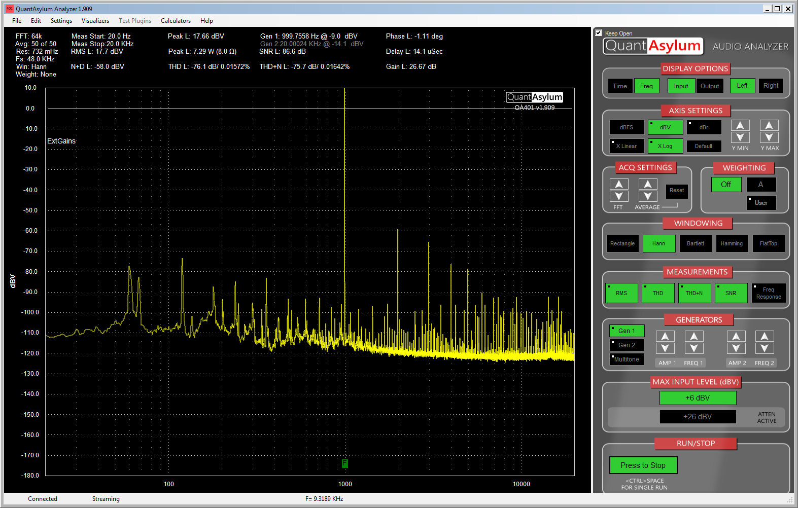

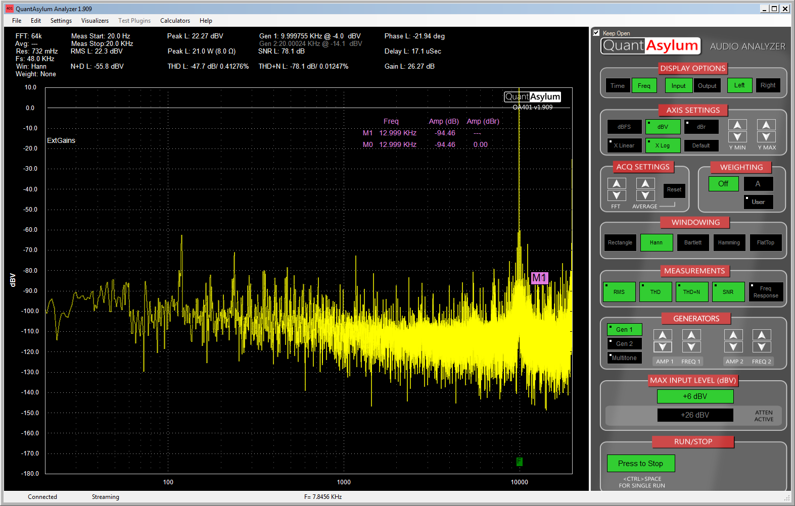

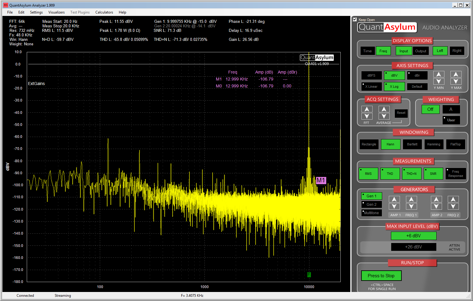

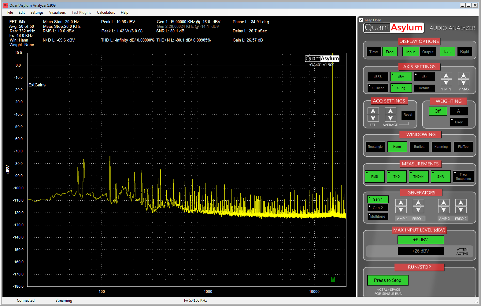

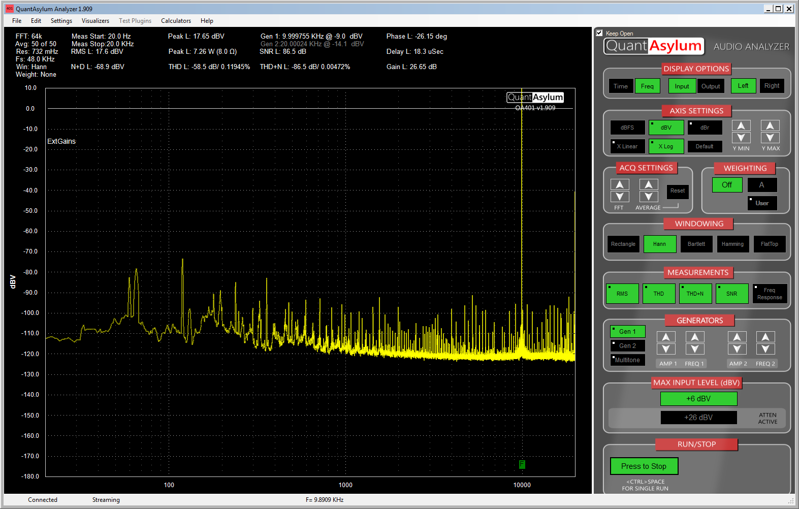

I used Bonsai's advice and set averaging to 50 samples for each measurements.
Here are new, less noisy graphs for AN:
Minek,
Thank you for your hard work.
What do you think about these results?
Does the amp sound OK?
Hugh
Hugh
The amp sounds great.
I measured several amps in the last month - basically most of the amps I built within last 3 years.
Older ones I didn't measure because they were built without oscilloscope and without simulations, so I didn't expect great results anyway.
From these several amps I measured:
1) In listening test I can't tell them apart. They ALL sound the same to my tin ears (same PSU, same speakers, same DAC, same music)
2) as the measured numbers go, the worst was quasi 2n3055 (built for sentimental reasons)
3) another quasi nmos 200 was 2nd worse
4) AN - the simplest amp on this list, and the only class A (and powered by SMPS PSU)
5) All more complex amps: Elvee's amps (circlophone, current_dump), several Unusual amps, Rod Elliot P101, Ian Hegglun's amp, Philips AH578, etc..
Differences between 4) and 5) are minimal. If these results are correct, it doesn't pay off to build more complicated/expensive amps at all.
We all should unplug our soldering guns, and get cheap chip-amps from Ebay. 🙂
That's what my ears, and audio analyzer tell me.
All this chase after certain 'profiles', Thd levels, etc.. does not translate to real-world results. And these tests don't even take into account speakers...
I'm not sure if I'm happy with this conclusion... I would like to be wrong on this...
Maybe QA401 reached its limits? But if that's the case, my ears also reached their limit...

Iv'e just checked technical specs of qa401:
Input Noise Floor-113 dBV, 0 dBV input range, inputs shorted, 32K FFT, avg 5, rectangular window, 48kSPS
THD -108.5dB (loopback, single-ended, L-shorted, -2dBV input, 128K FFT, Hann window
I guess that means that whatever is under the noise floor, we can't see/evaluate, right?
I guess that's why all (supposedly) good amps that sim under 150dB, look the same in qa401 plots - all around 120dB...
