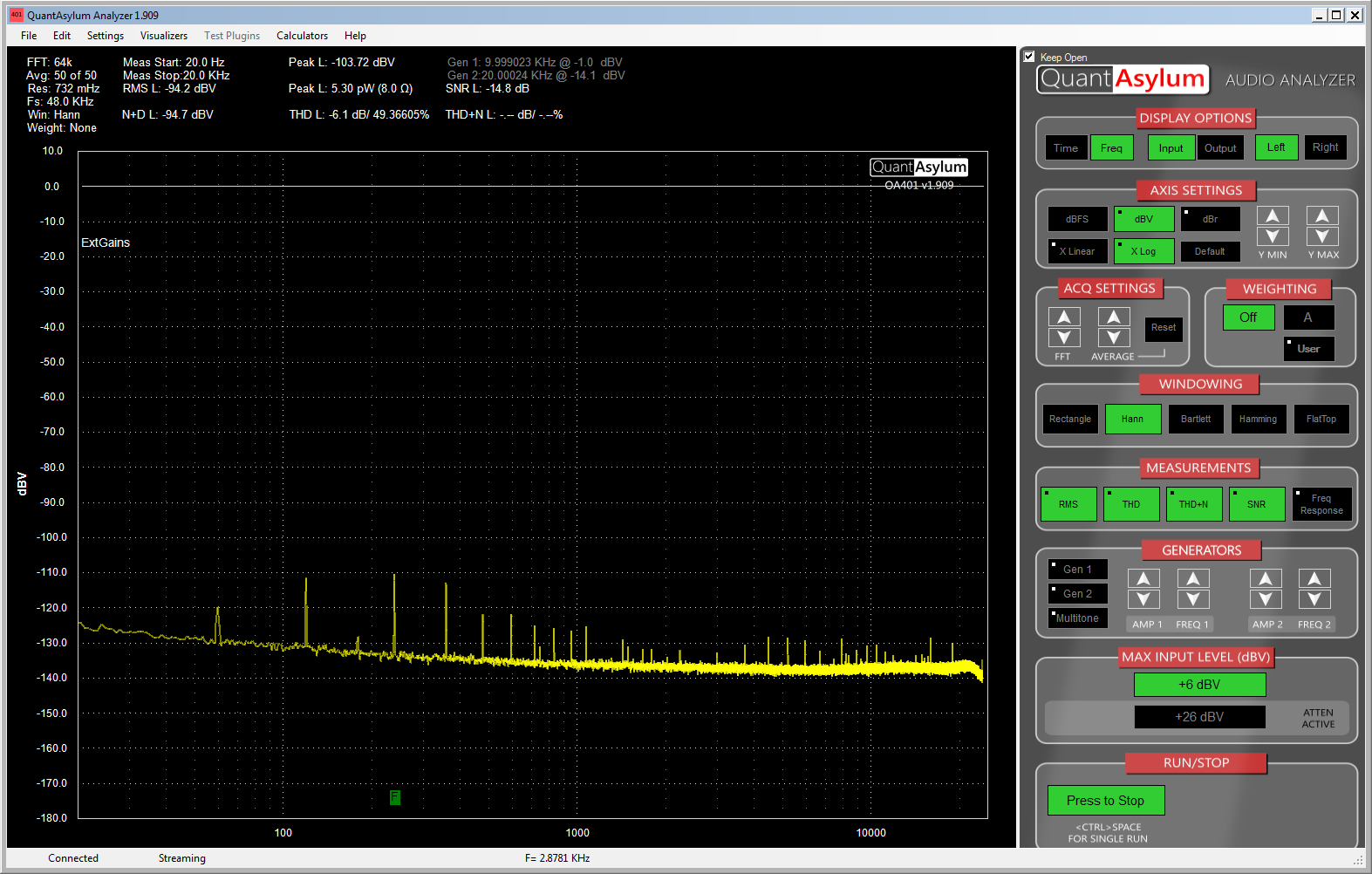

Minek,
I think you may have measurement/layout issues. Are you using single ended or balanced connections with your QA401?
Suggestions
1. Use balanced connections from your load to the QA401 as a minimum
2. Twist the speakers cables to the load together.
3. For the balanced inputs from the load to the QA401, twist the wires together ( ie hot and cold). Bundle the speaker cables and the cables going to the QA401 tightly together
4. Keep any mains cabling well away from the speaker, input and output interconnects
5. You can get significant noise reduction by connecting the QA401 housing to the amplifier chassis - twist this cable around the output cables from the QA401 to the amplifier inputs
6. As already mentioned earlier, run your computer off batteries and make sure the adaptor is unplugged from the wall ( I think some of your hash is from an SMPS somewhere)
7. You MAY get a further few dB noise reduction by running a cable from the USB connector shroud to the QA401 housing. Wrap this cable around the USB cable.
You will need to play around with your set-up to get the optimal results - this is quite a steep learning curve.
You are using dBV measurements so all signals are referenced to 1V. This is a pretty brutal standard to set yourself. It is more normal to set the reference to dBR. To do this, drive the amplifier to full rated output in dBV mode ( usually this is the 1% distortion output). Then click on the dBR button and select ‘set peak output to 0 dB’ dialog box. This will then give you readings referenced to full output.
(I’ll try to post a video later this week - bit tied up at the minute. )
Thanks Bonsai!
I do. See this post.
Cables between speakers and the load are only 10 inches long.
Cables connecting load to qa401 are only 1 foot long.
They sit next to each other.
But I guess, even though they are so short, still can be twisted.
>Keep any mains cabling well away from the speaker, input and output interconnects.
They are far away. No mains nearby.
This I will try.
I highly doubt any amp cabling is an issue here - because - even WITHOUT an amp and without any cables - just qa401 connected to usb port, noise level is already there (at approx 120 dB) - even with shorted balanced inputs, and looks the SAME with amp connected and powered (but without signal).
USB wiring can be a different story..
Tried that long time ago. I run it from desktop PC. This was my 1st suspect.
Tested with laptop (running from batteries) with exactly same results.
There is plenty of SMPS around; e.g. amp fan is powered from small spms or buck converters in some cases.
Tried without fans/smps/converters connected. No difference.
There is also another 10 or so small/crappy smps-es within 6 feet, powering all kinds of little things (phones, routers, switches, etc..).
Will try. I also tried with/without USB optical separator - I use it between DAC and PC, works great. But unfortunately didn't make any diff for qa401.
I'm playing with this thing already for months. This is the best I could do so far. I tried all obvious things.
You wrote about dBr previously but I was confused by the settings, and statements from qa401 user guide saying that "dBr mode is for more 'esoteric' measurements" and advising to stay away from it 🙂
Can you refer to post #1578 regarding dynamic range of qa401?
If the official noise floor in the specs is 113dB, how can we expect anything better than I already see in my plots?
Or my understanding of 'noise floor' is wrong?
This of course doesn't explain ugly spikes present in my plots.. Just the bottom level.

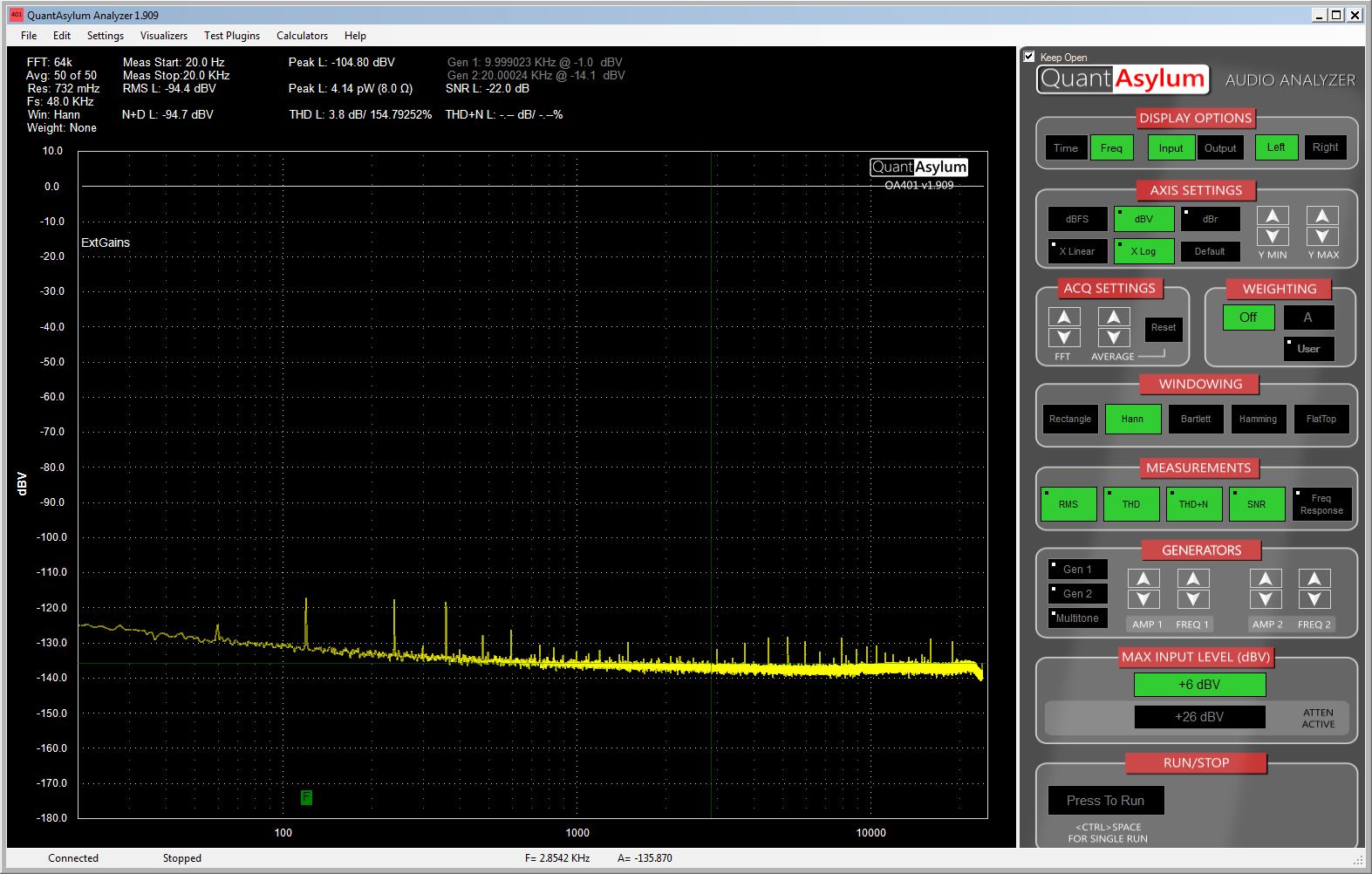

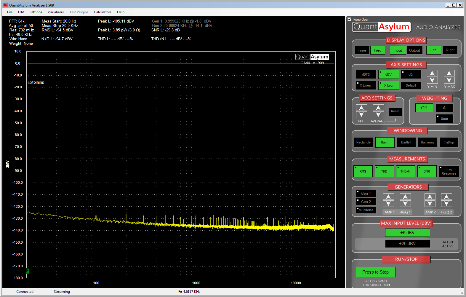

Here are 3 examples of 'noise floor':
1) no amp connected, no cables plugged, diff input shorted by paper clip
2) no amp connected, 8.8 Ohm load connected (diff input), cables twisted
3) no amp connected, 8.8 Ohm load connected (diff input), cables twisted, AND ground of the load (diff -) connected to the chassis of qa401
What are your external gains?
To short the QA402 inputs, the best solution is to buy BNC sporting plugs off Amazon. They are about $3 a pop.
On an averaged dBV trace, the noise trace should show no noise spikes.
The spot noise floor (that’s the noise at a specific point in the measurement window and usually taken as 1 Hz BW) with the inputs shorted, no external gains, 50 averages and 20 kHz measurement BW should be about -150 to -155 dBV. If you integrate this noise over the measurement BW and do not average it, the total noise is specified -113 dBV. To read the noise accurately you must tick the ‘rtHz’ box in the dBV dialog box (note carefully the caveats associated with this wrt reading signal peaks in the manual - so only tick this box when you want to measure noise).

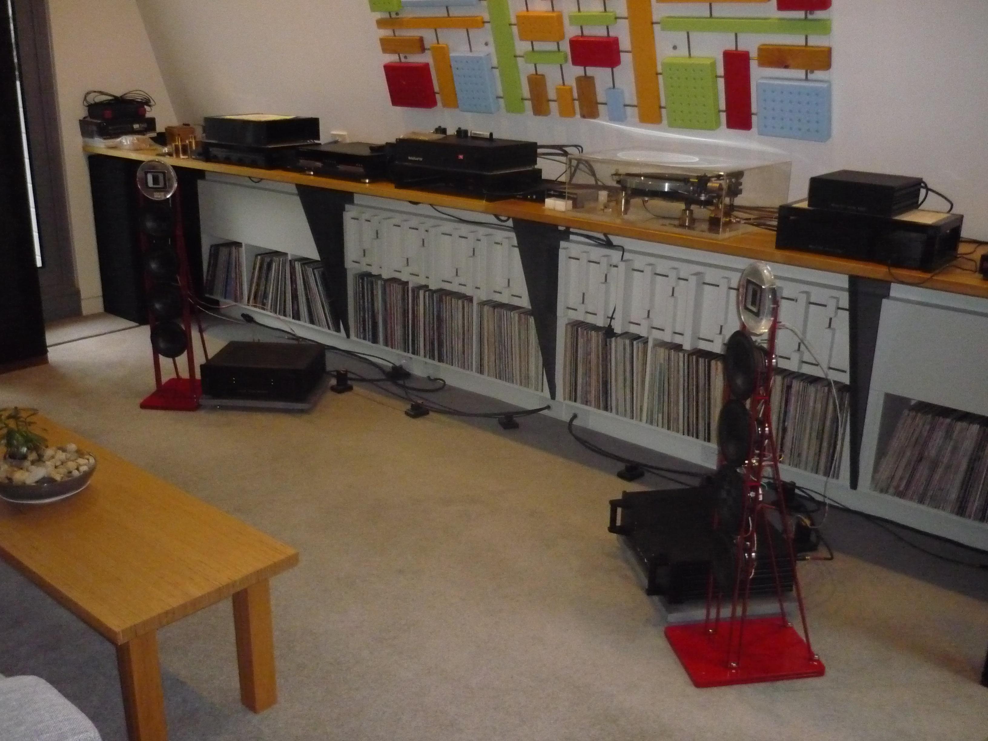

I feel obliged to comment on your "findings", minek - because mine are very different. 🙂 (Possibly because I don't keep rotating amps ... I build a new one, confirm (with a listening team!) that it sounds better than the previous one - and get rid of the previous one! 🙂 )
I've done this over many years with Hugh's amps, driving my 3-way active Maggies; AKSA 100N+ plus two 55N+s gave way to a Soraya 100 plus two Lifeforce 55s ... which gave way to a Soraya 100 plus two NAKSA 80s.
A few months ago, having finished building two AN 4Rs to drive the 3ohm mids & 2ohm ribbons of my Maggies, Hugh came over for a listen. I myself "thought" the Maggies sounded better than with the NAKSAs ... but it was a close call. So I was a bit disappointed at having spent so much money and so much effort building these amps.
Today, Hugh came over again ... to listen to the AN 4Rs driving the new spkrs I had designed - which have replaced my Maggies.
He was blown away by how the AN4 Rs sounded with the new spkrs - so much better than with the Maggies. 🙂 We listened to a 'Test' CD of his that he knew well - and Hugh said that he was hearing stuff on the CD for the first time! 😎
So resolving spkrs would appear to be an essential part of comparing amps.

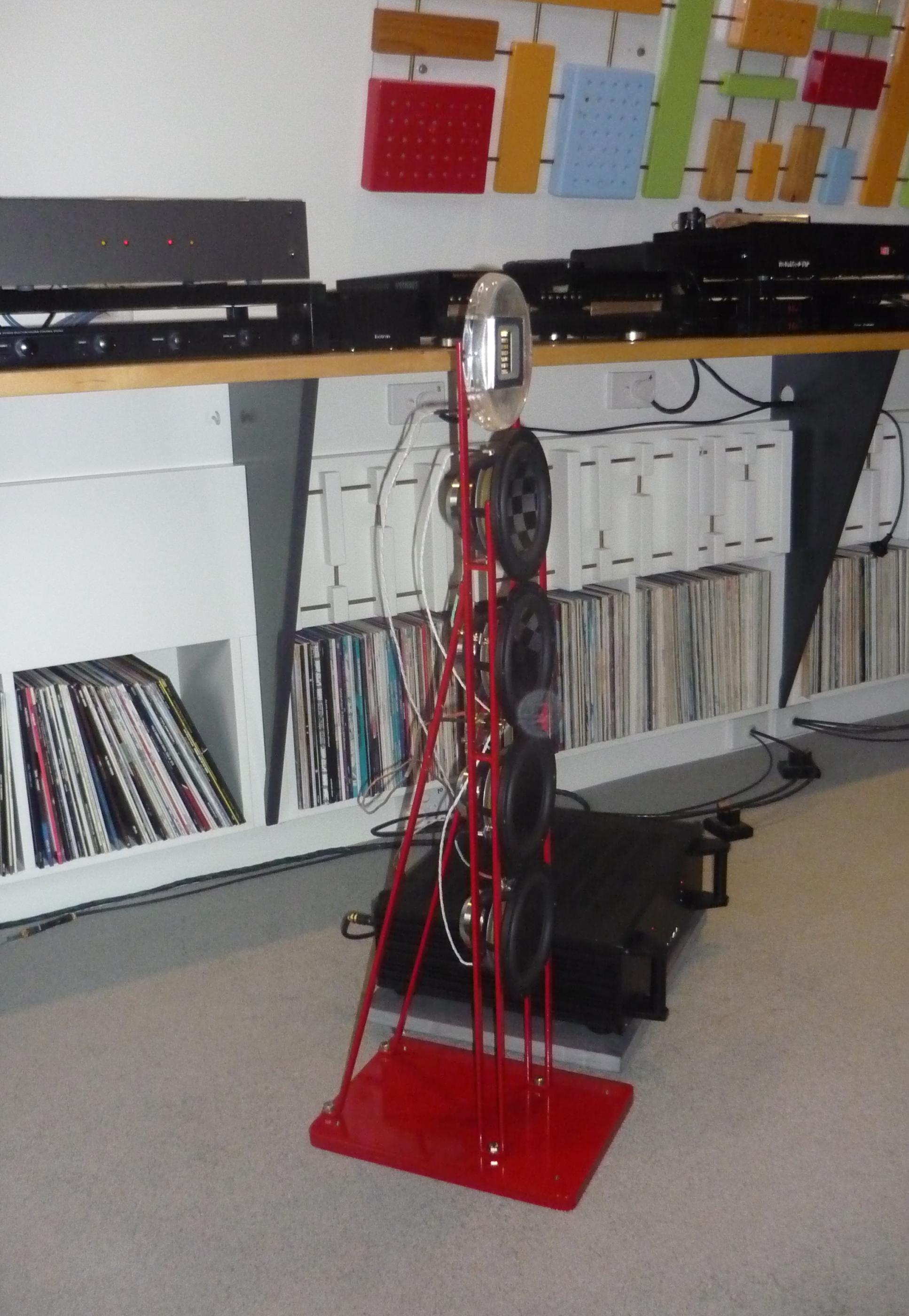

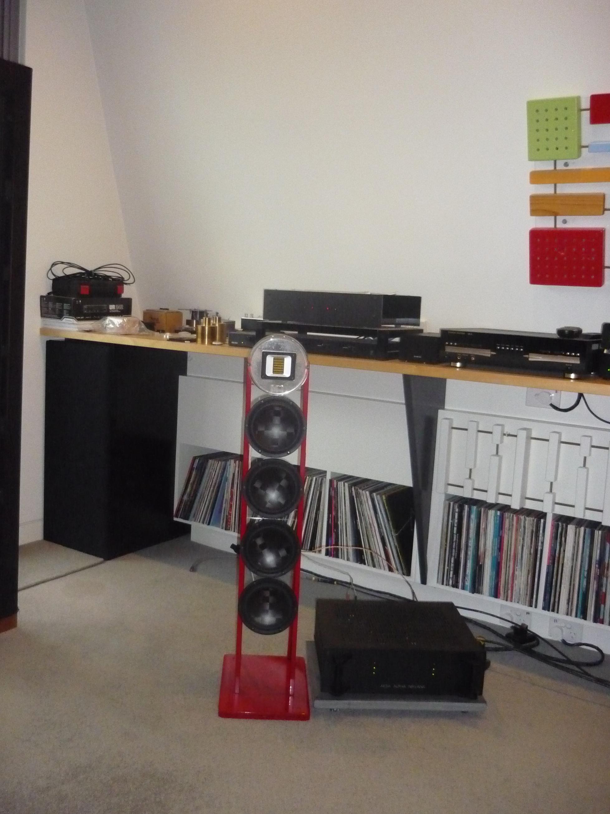

In case anyone is interested, below are pics of my new "zero baffle" spkrs. They:
* are 2-way active
* hand over to my subs at about 150Hz (still playing with that)
* use SB Acoustics 'Satori' drivers, and
* need a miniDSP or DEQX to provide the 24dB XOs and some mid/bass driver EQ.
Andy
Reactions: uncola
Nice setup Andy !
That are the new textreme drivers :up:
Thank you, Danny.
Yes the 6 1/2" Textremes (MW16TX-4).
Which AMT did you use ?
The Satori AT60NC-4
Have you tried a semi active setup ?
Active XO only for the sub and passive to the mids+AMT?
The passive filter can be a simple high pass filter between preamp and Nirvana amp
No - not interested in passive XOs. I like amps directly connected to the drivers. 🙂
Andy
why 4 texTrene driver ? only ones do mid ....
My original design had just one mid/bass driver.
But because of the lack of baffle ... there was a huge hole from 500Hz down to 150Hz (where the subs take over).
Two drivers helped - but I still had to use a lot of EQ. Four drivers improved the situation (but adding significantly to the cost) ... so that I now use only a small amount of EQ. (A low-shelf boost and a high-shelf cut.)
Andy
